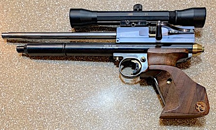

Another beautiful and gratifying Crosman custom
As is not unusual with these Crosman projects, this one has 'evolved' several times over the course of several years. The latest evolution is swapping to "The Exclusive" side-lever repeating breech from China (via Ebay), and an aftermarket stainless steel bull barrel machined for a P-Rod, slightly modified for the side-lever breech.
Much preliminary testing involved trying to eke out as many usable shots as possible from the HiPac HPA conversion gizmo; that being only 9-10 shots with an extreme spread of about 40 FPS from a 1750 PSI fill. Accuracy was not impressive; come to find out completely due to the wide ES.
Once I knocked the fill pressure back to 1600 PSI a five-shot string looked like this- Low= 515, Hi= 523, ES= 8, SD= 4, Average= 518 FPS/9.5 foot pounds. VIOLA!!!
Now she averages .62" c-t-c five-shot groups at 25 yards, 1.34" c-t-c at 50 yards.
So now I'm considering a custom (length) chamber-tube, in order to return many more shots per charge.
