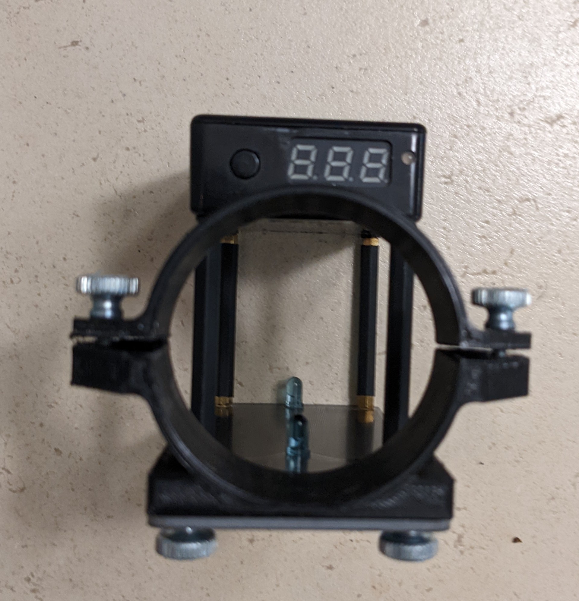

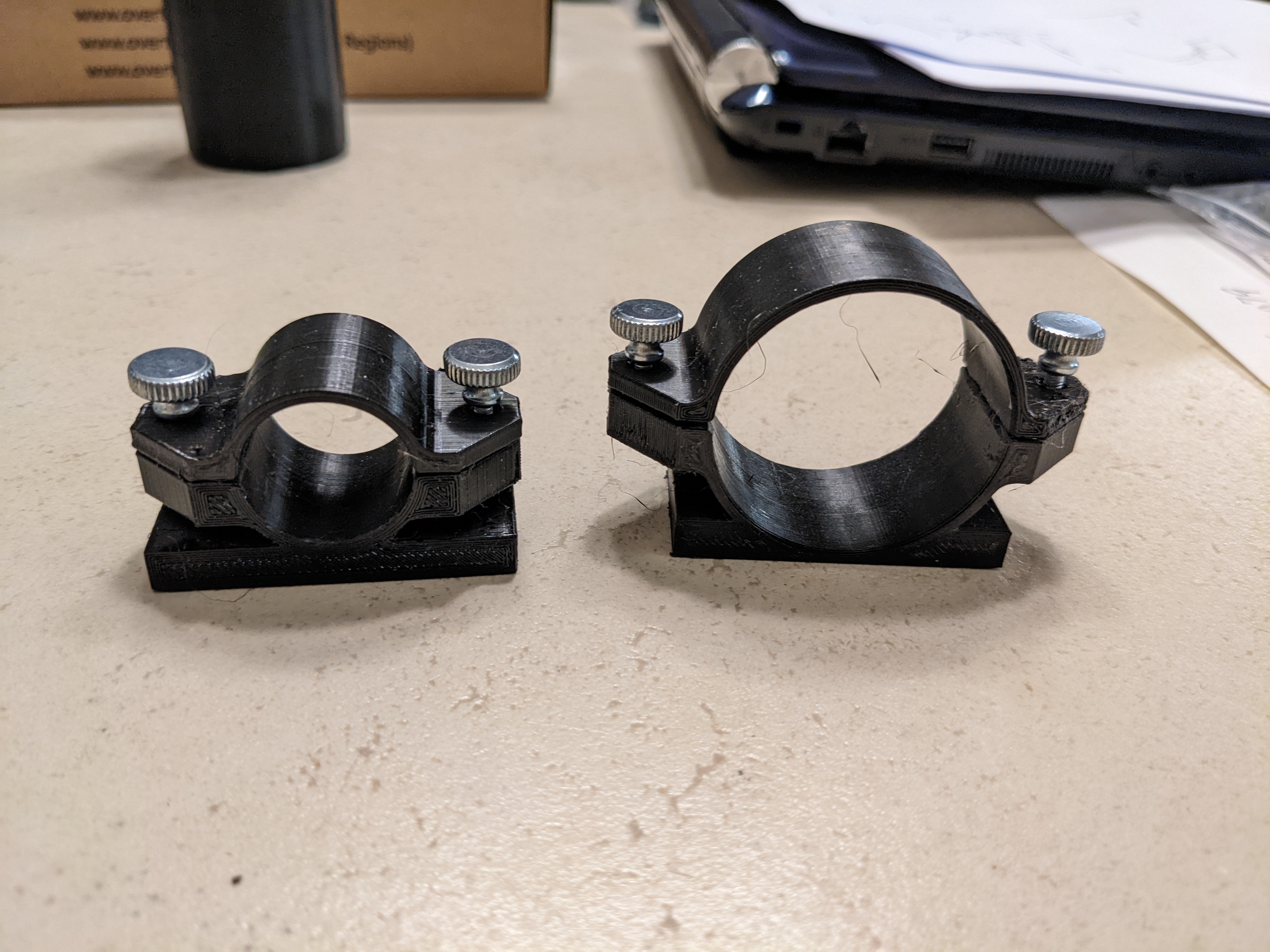

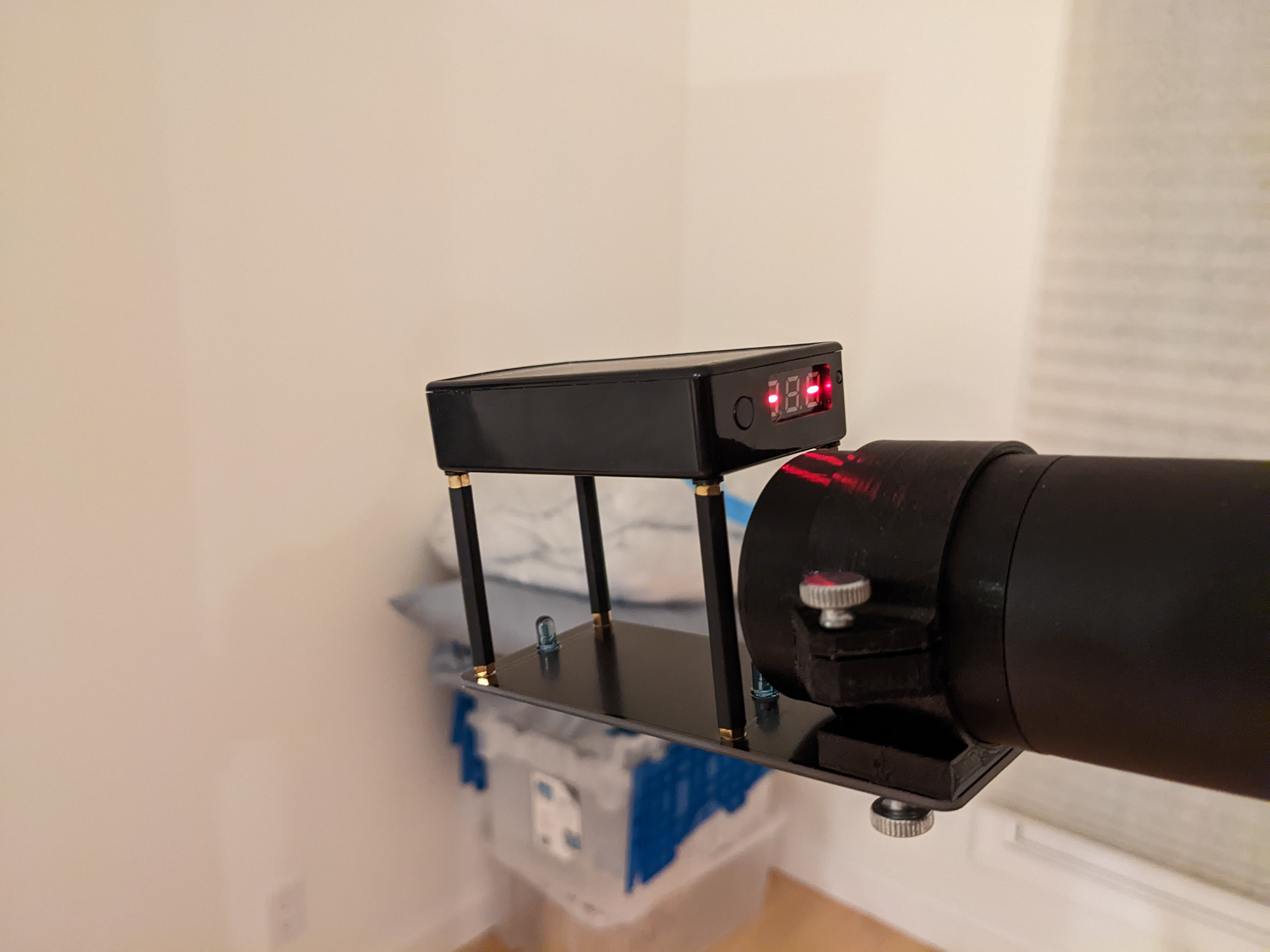

I thought the mounting is hokey and 3d printed mounts for the guns I use it on. The metal hoop wouldn't fit large diameter shrouds and can scratch the finish.
