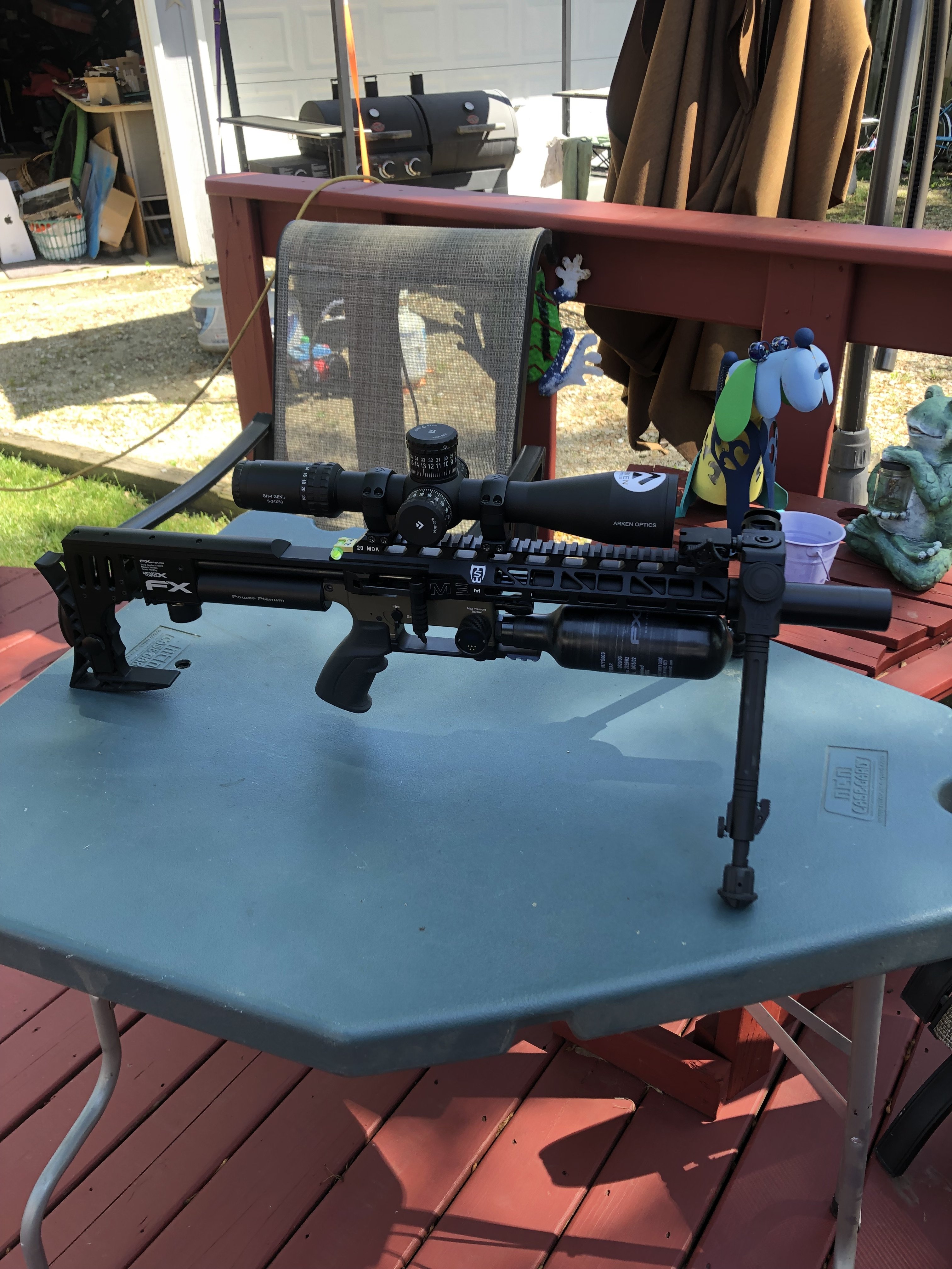

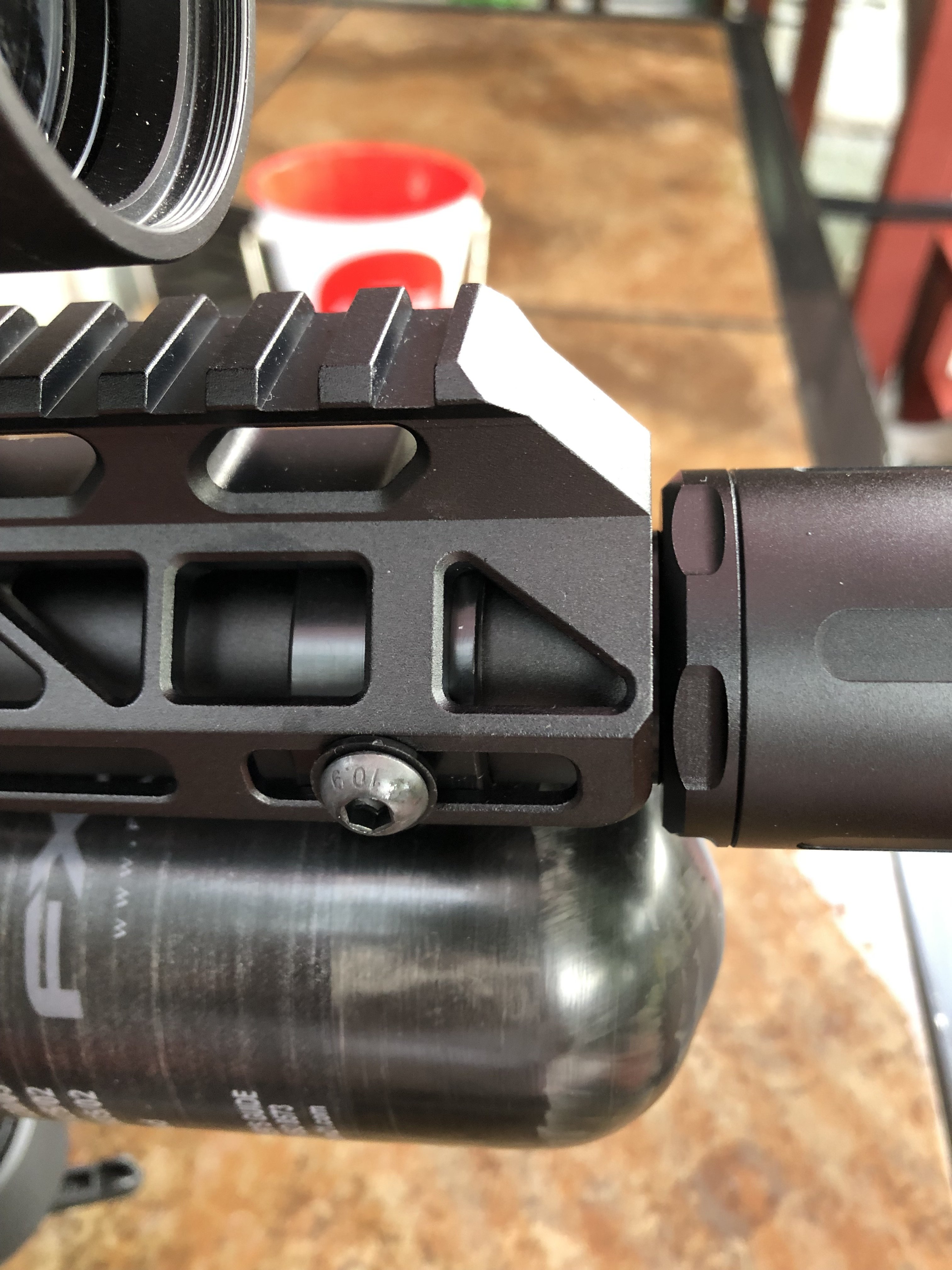

i tried the trs compact rail as its just a pellet shooter so the barrel band or whaever you call it my impact didnt like it made it more prone to not as tight as groups as far as i tested but gotta try few things with it as far as tension on the screws i got fx carbon sleeve also. i think more than e=anything more powered guns will be better and longer barrels for sure, i liked the more slots for moving the scope around for my scope cam as i gotta moveit for more eye relief to make it more comfy, gotta play with position of that barrel spacer also yet View attachment 269552View attachment 269551
So did the built-in clamp help you to achieve better groups?
I never tried these clamps or barrel support devices because it goes against my theory of leaving the barrel to be as free floating as possible. I’m sure you can have success with the camps if you spent the time to find the right “node” but it doesn’t quite jive with me.
Granted free floating barrel isn’t impact’s design with front support under the rail but adding more to me isn’t worth the trouble because that’s adding another harmonic variable to the equation, poor little straw barrel is been twisted every way at both ends now!🤣 My suggestion is just to tension the shroud or use a carbon tube to put tension on the whole barrel. That so far gave me the best accuracy with least amount of work.

How do you like that UTG overbarrel bipod? I am tinkering for some time to get something like that (Leapers or Frontmeier) but I have a green laser below the scope nowhere else to put and that picatinny clamp would render the laser useless.

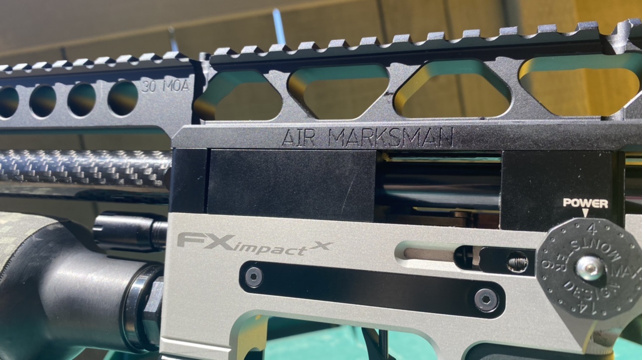

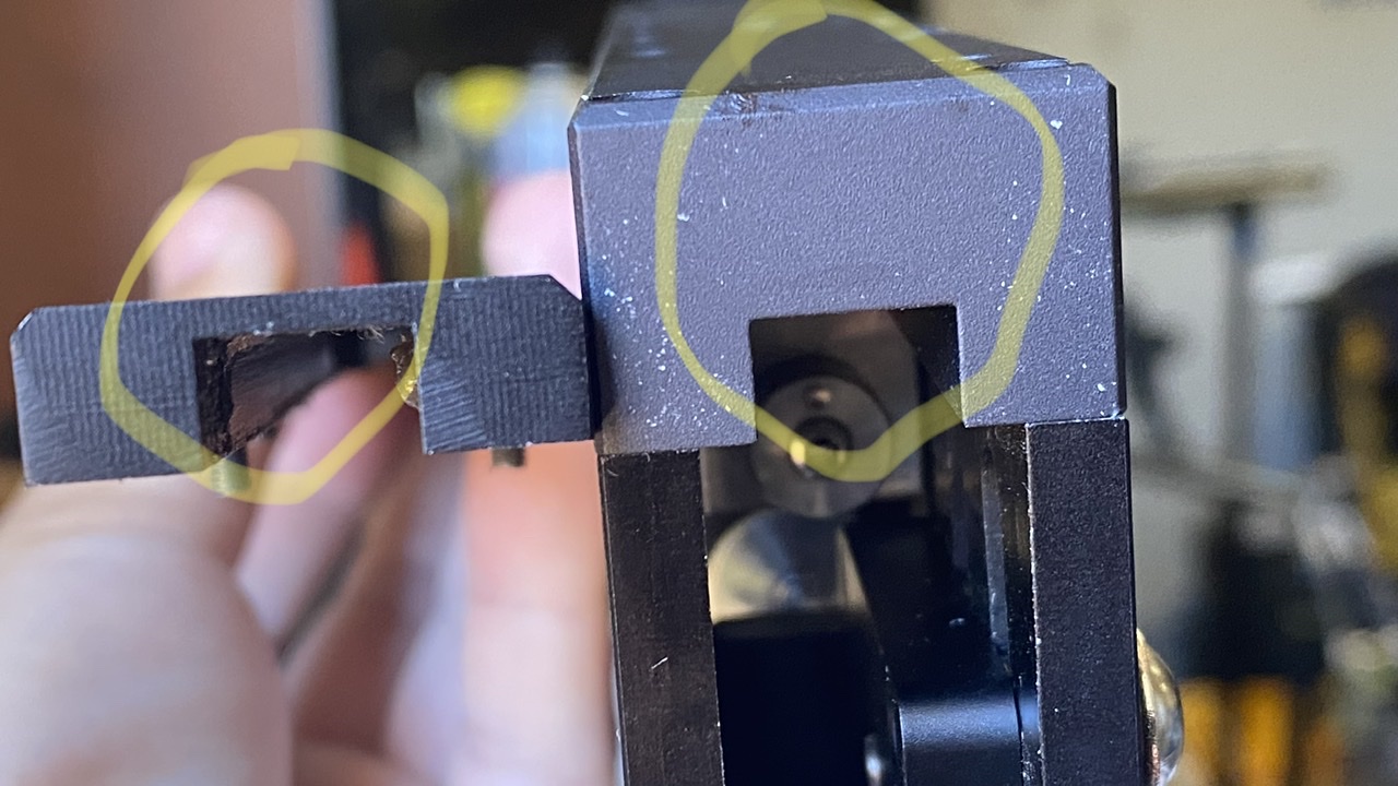

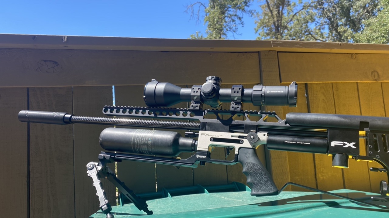

It finally made it into my dirty little hands. Out of box impression is it’s very well made with fit and finish seem smooth and straight.
Mounted on my impact and I really like it! It certainly looks better in person at least for the black version I have.
The backbone is MUCH thicker and should have much better stiffness compared to factory “frame”. Just one glance at the cross section the difference is even far more significant than from utah air pictures. Can’t wait to try it at the range. The holes above the action is also super awesome for grabbing the gun instead of grabbing the scope.
