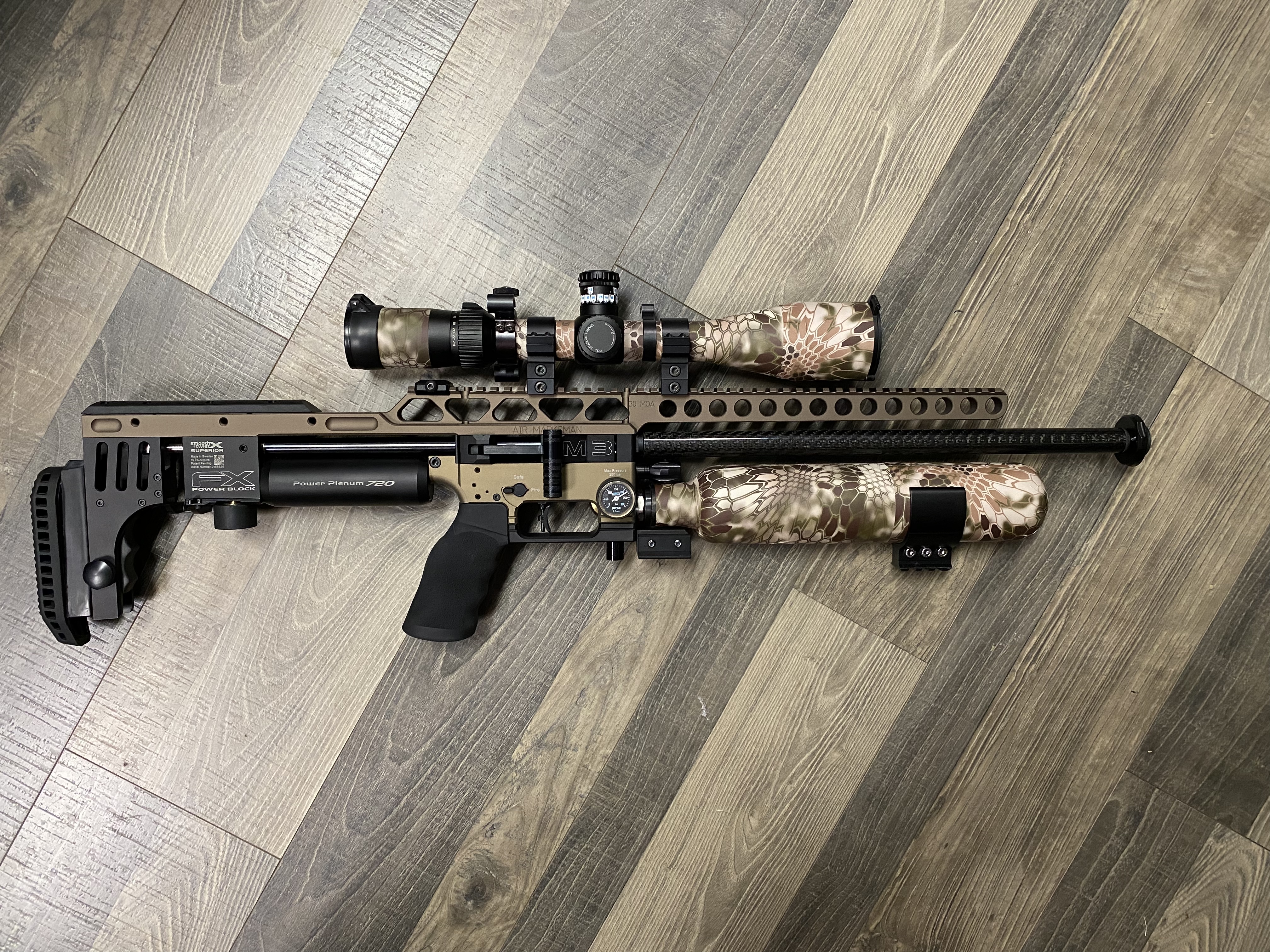

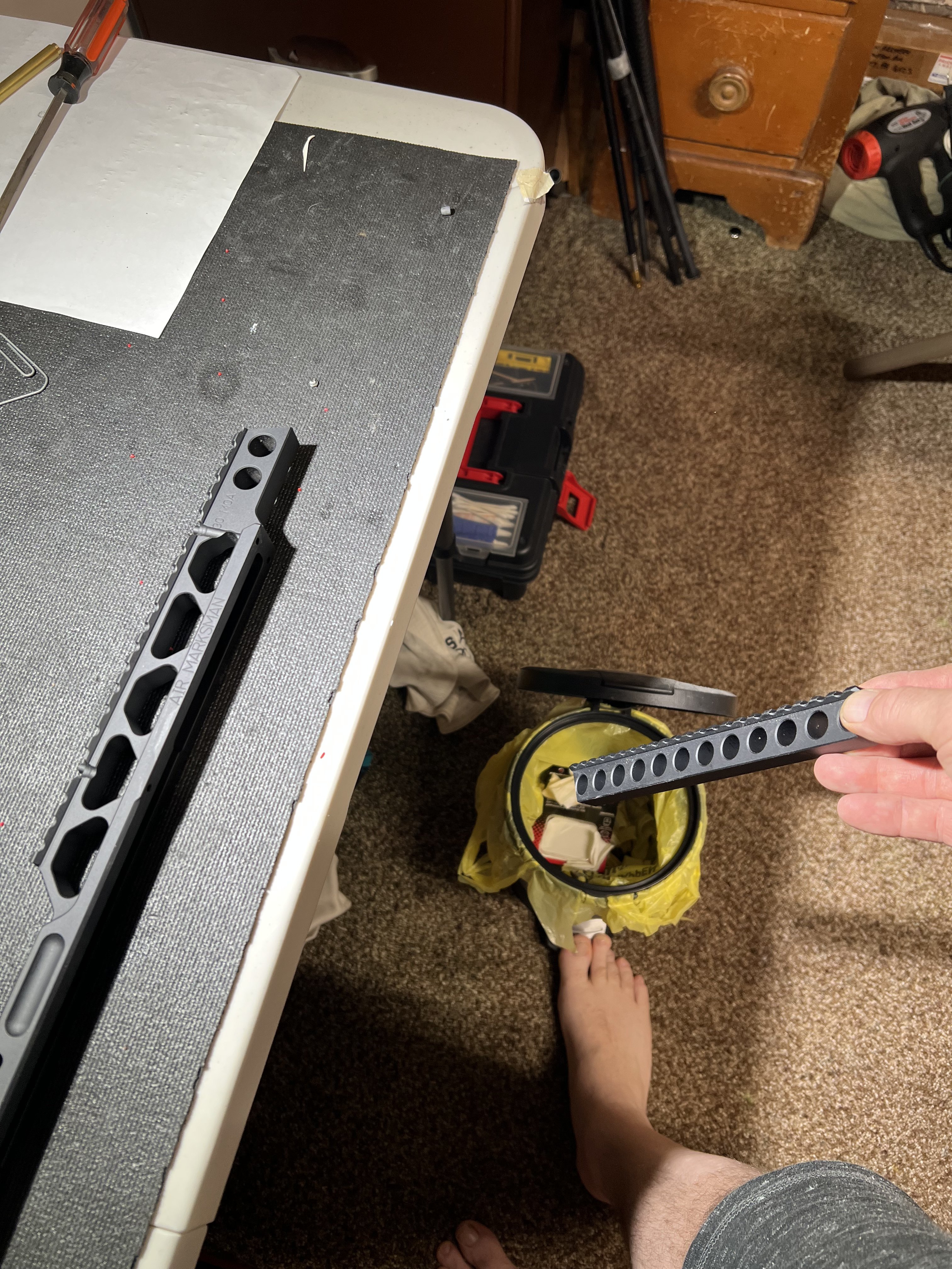

Mine arrived also. First thing I noticed was it’s not light so mine is definitely getting chopped in half. Second is the length of the fasteners. Mine won’t go on my gun until I grab some stainless fasteners. I will get to chopping in the meantime. Even though my gun is only a 600mm, I can’t afford any more fat. My scope, grip, real barrel, Arca rail, and bag rider all really packed on the weight so I’m already on the edge of not wanting to stalk around with the gun. I did check my rail and it’s not warped so that’s a good thing.
Thanks for posting a picture of your gun qball. I’m a one piece mount guy and was going to chop my rail and didn’t consider the next owner of my gun might be a dual ringer. I will leave a little extra on for him.
I’ve always had to move the scope as far forward as possible and even resorted to offset mounts. The longer rail is super nice because it give me lots of mount options even though I’d not need the adjustable rings anymore.

Anybody interested in 5.6oz of dead weight before I throw it away?

Oh I do wish the color was a closer match. It’s not that good a match to be honest. As you will see in the picture.
Reactions: Apohlo and qball
How much does that beast weigh? Looks beefy in a good way...
