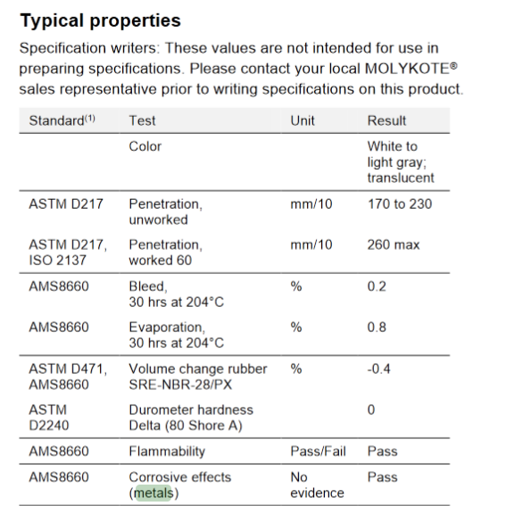

In researching lubes for pcp air cylinder threads, I found a few references to using Molykote 111. Researching 111 doesn't seem to back up it's use on metal to metal, but I have followed this advice from reputable sources.
What is everyone's opinion on this use?

Passes the test for metal corrosion? Silicone based sealants are well known for doing well in metal to metal applications...no need to call their "experts"

Threaded connections of PCP cylinders/reservoirs generally need no lubrication whatsoever. Silicone grease on the O-rings is good but there’s no need to apply it to the threads because it will confer no useful lubricating properties anyhow. But from a safety standpoint, any incidental transfer is fine because it is non-combustible.
The one scenario I’m aware of where thread lubrication is necessary is with materials having a high risk of thread galling like aluminum and/or titanium. We were recently discussing this topic elsewhere:
It's shockingly easy to have galling seize up threaded connections in titanium and/or aluminum. The presence of silicone grease does not cause it, but it does nothing to prevent it because it provides no useful lubrication properties for a metal-on-metal interface. However, the typical anti-seize compounds aren't advisable for pressure vessels because they have combustible hydrocarbon bases. That's where one of the PFPE / PTFE greases like Krytox or Ultimox come in.
Tungsten disulfide is another effective lubricant, and it's what I use because it's both inexpensive and serves multiple purposes in the airgunner's toolbox. For this purpose I keep some in an eyedrop bottle, the powder mixed with alcohol 50/50 by volume. Super easy to apply to threads this way. The alcohol wicks rapidly to carry the powder into the threads and then quickly evaporates. And like molybdenum disulfide, it also makes a great dry lubricant for burnishing into hammers and bolts/cocking mechanisms and the surfaces they ride on. The advantage over wet lubricants being it doesn't attract and trap dust and blowing debris, and for the hammer specifically it won't affect the strike at varying temperatures the way a wet lube may do because of changing viscosity.
