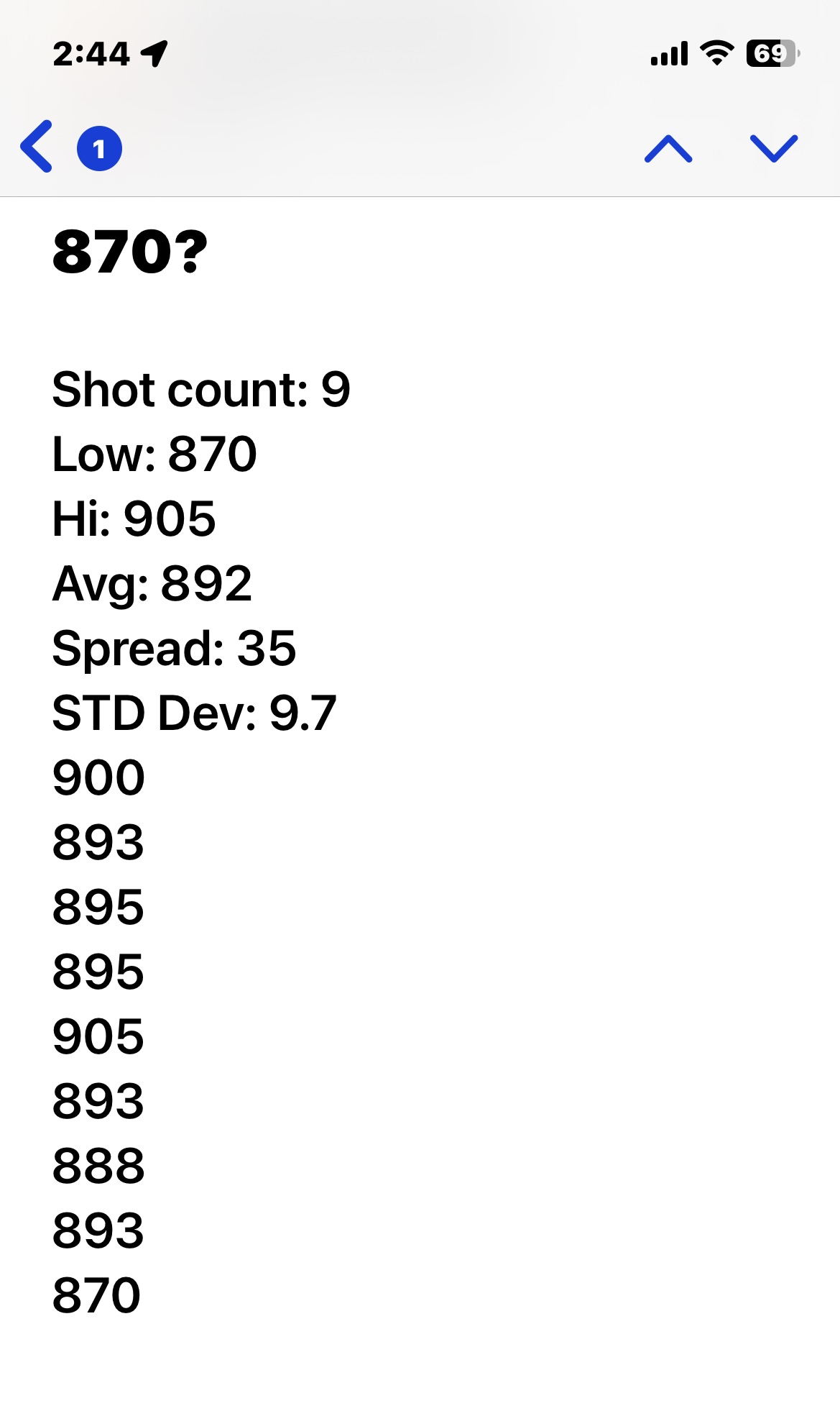

So I’m not looking(yet) for super high power. Just accuracy, consistency and lots of shots! Really at lower power, flat shots, so I chose the FX 15.9’s as they would be more backyard friendly, a bit safer, etc. Just trying to get more consistent shot strings.
All of these ideas have merit and I’m trying some at the range today.

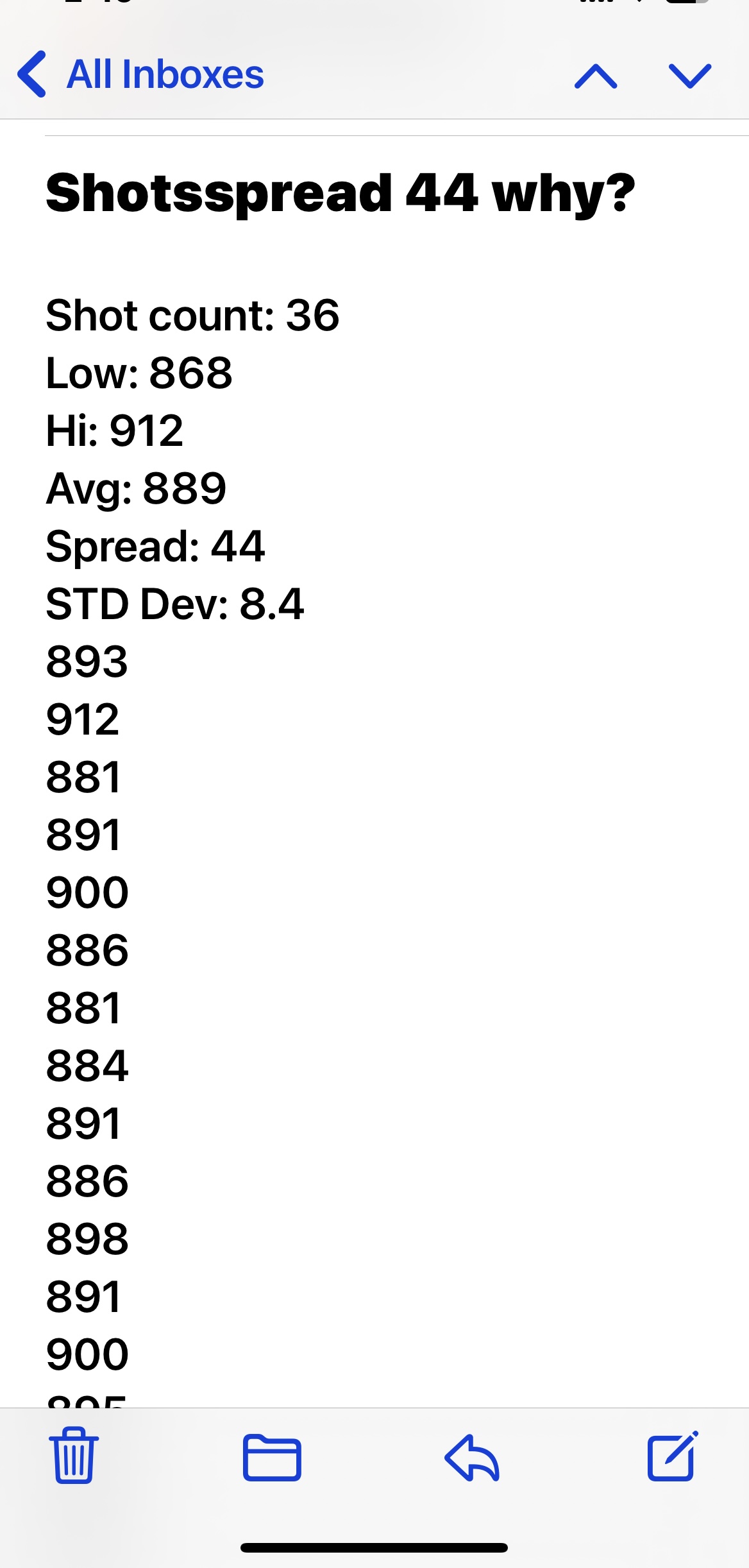

That long shot sting I showed while tuning led to this. And still not done. Around 32 fpe. Start lower, bump up the pressure and turn up the HS to keep up with pressure to find your wanted fps . My next step will be finding the hammer peak then tune it down.
18 grain pellets. Cheap ones at that.
Shot count: 20
Low: 886
Hi: 898
Avg: 892
STD Dev: 3.2
Spread: 12.0

It could also be your washer stack in your regs. Mine had one that was installed wrong. I have the barrel on the slug port also. Didn't want the restriction of the pellet port. Picked up 30 fps or so .

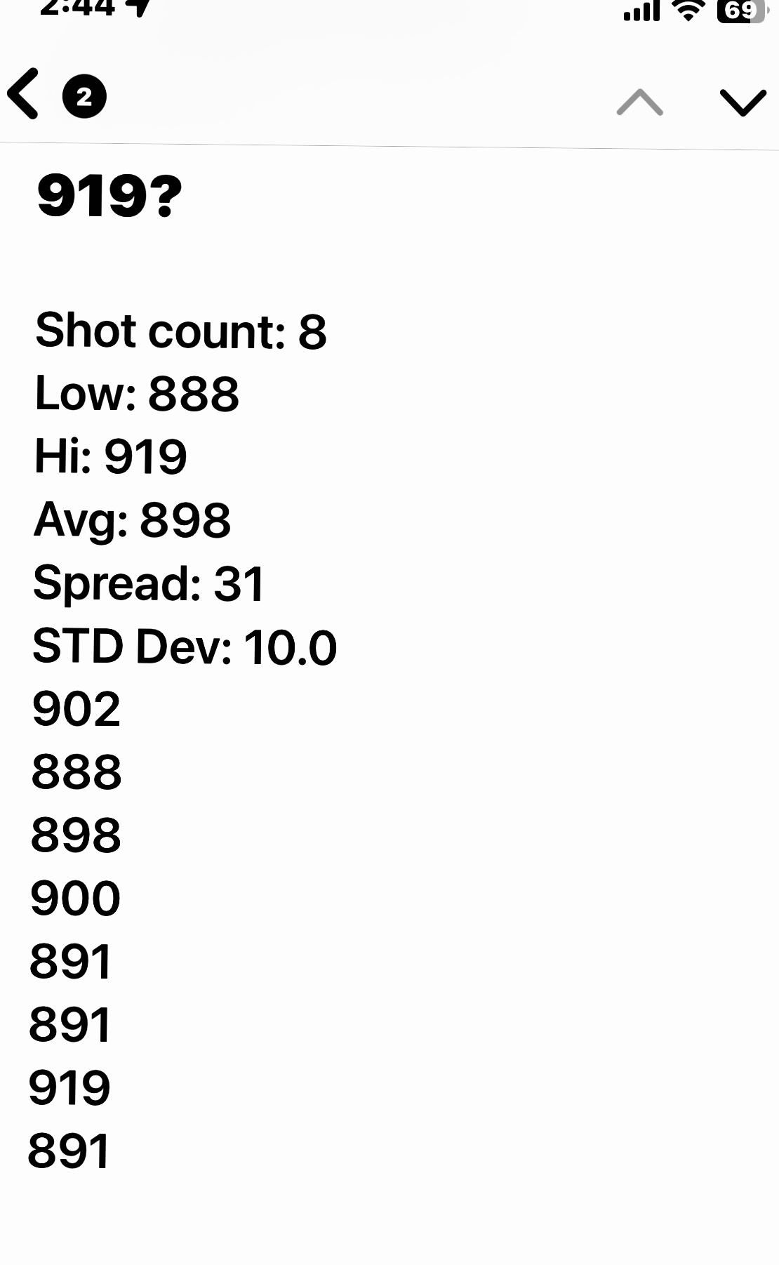

I have finally given up! Sending my .22 Compact to FX for warranty work. They advised they think its a bad reg creeping. But there was another issue with the bottle adapter they want to check out too. They were very helpful in my conversation!

Thanks for posting this. My Maverick does the Exact same thing. Shot strings look almost identical to what you posted. I’ll get like 20 shots between 900-907 the. Some random 923 or 888 thrown in also mine starts to go crazy after the bottle red goes below 200bar which does not make any sense to me.
