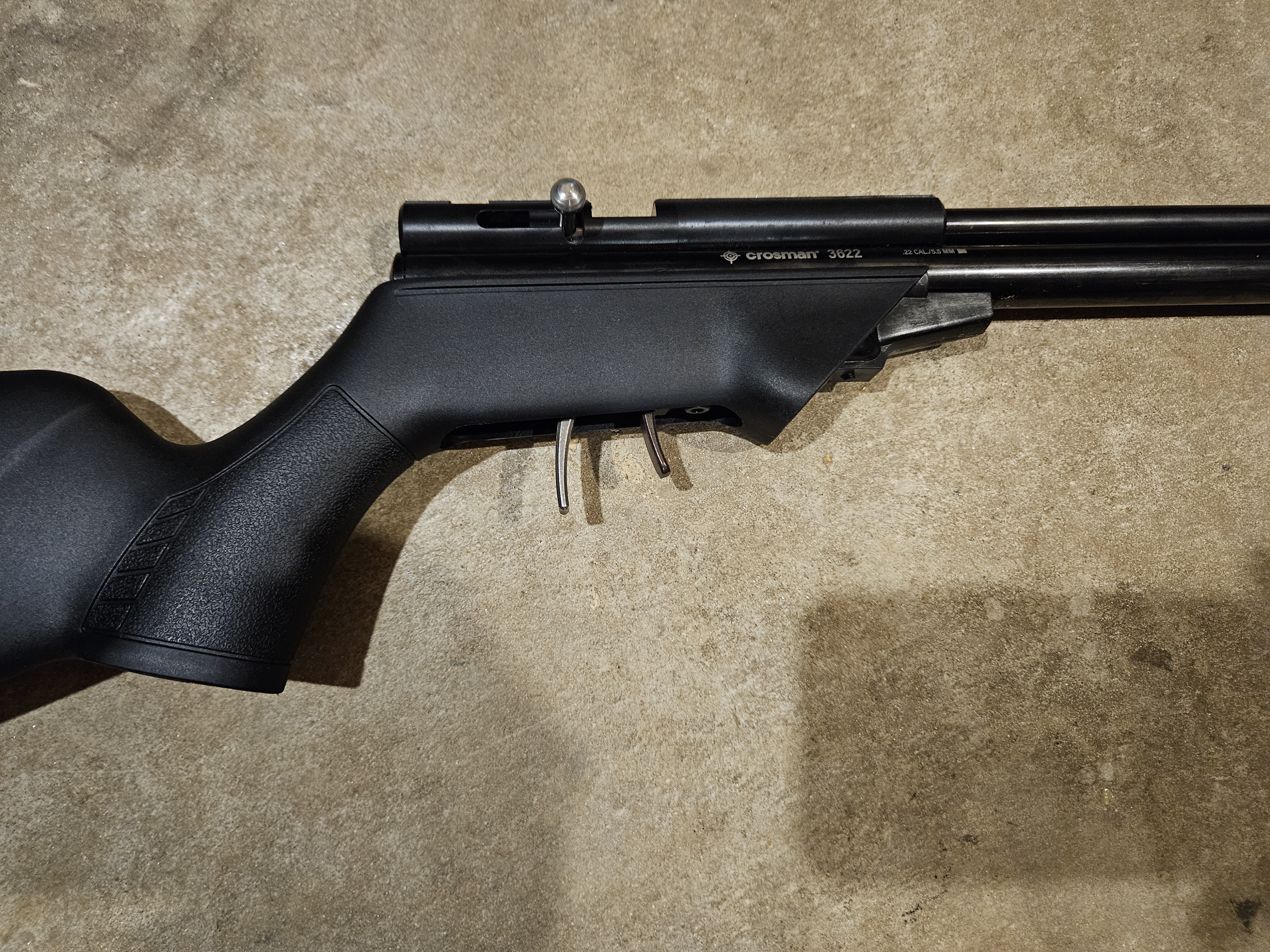

Crosman Another money pit. My crosman 3622.
Didn't the Disco already have the steel breech and was more powerful ?
Yep. Then they made the maximus which had a little better valve and longer barrel with steel breech. Also had the fortitude which was regulated and multi shot breech based on the Mrod mag and bolt, but sized for the smaller tune. Those didn't fare well on the market and had a tiny plenum. I gutted my 177 fortitude and it put in a maximus valve, and it went from 15 fpe to 28 fpe.
So basically they went backwards ?
Maybe Crosman has a huge inventory of parts they need sell so came out with a gun that they knew people would start and need to upgrade :ROFLMAO:
I totally agree! They didn't need to do much retooling in the factory thats for sure!

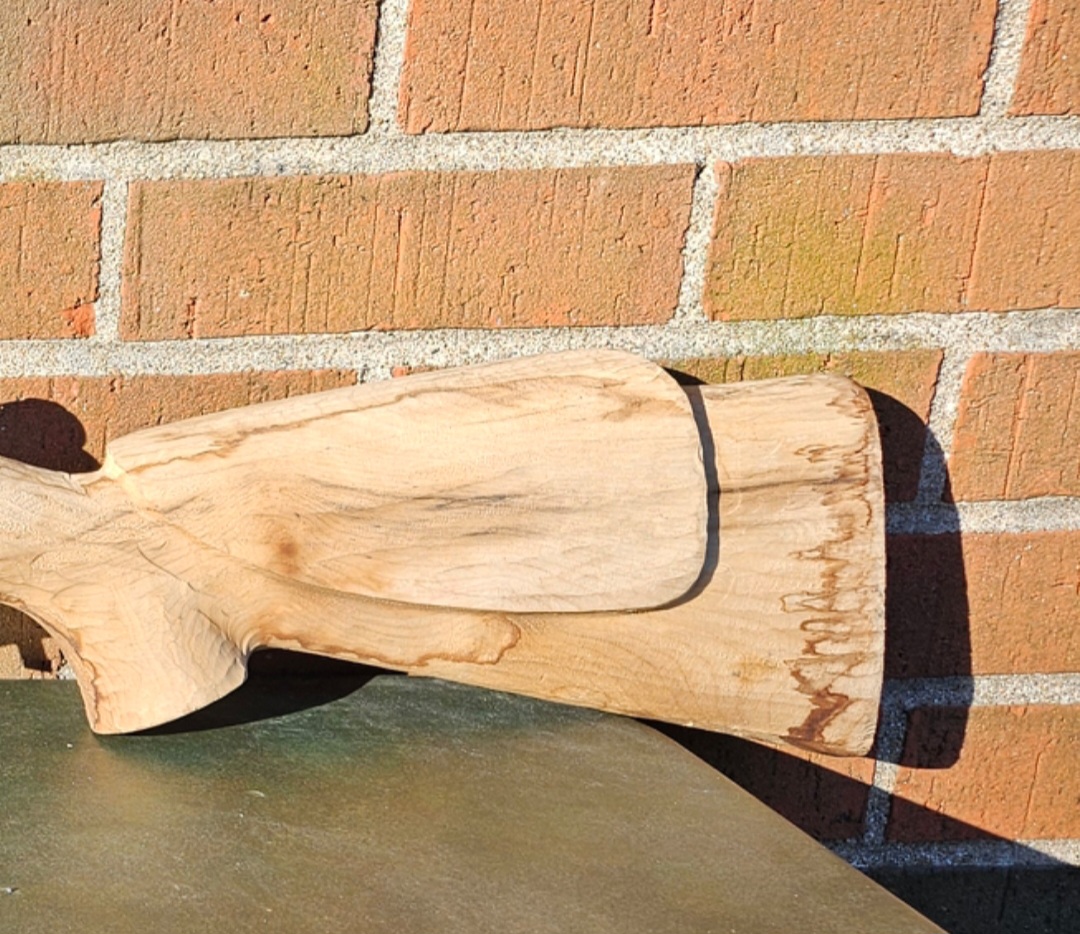

So do you think this deep stain would come out? I have a gallon of fresh white vinegar I just bought. View attachment 446060
Stain over it and get a fancy grain look from it .. heck the stains in the wood may make it look like fool your friends tiger walnut ..lol
If it wasn't for the fact that it looks like it was stood against a wall and the water leeched up the butt(lol), it would look pretty cool with just a finish. I still have to trim and shape it down, it's just rough cut right now. I think WoodWelder is right, that most of it will come out with finish sanding.
Oh well... I just thought it would give it a unique character.. one of a kind thing ..😉

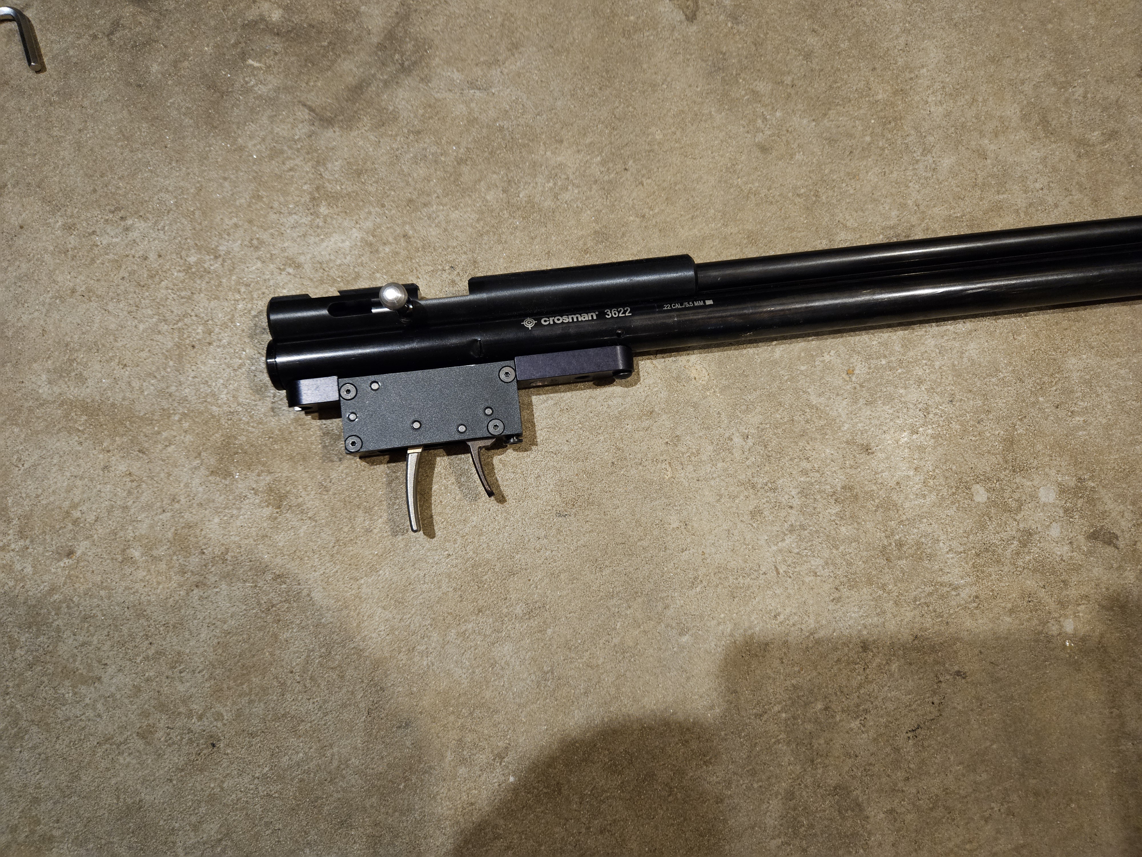

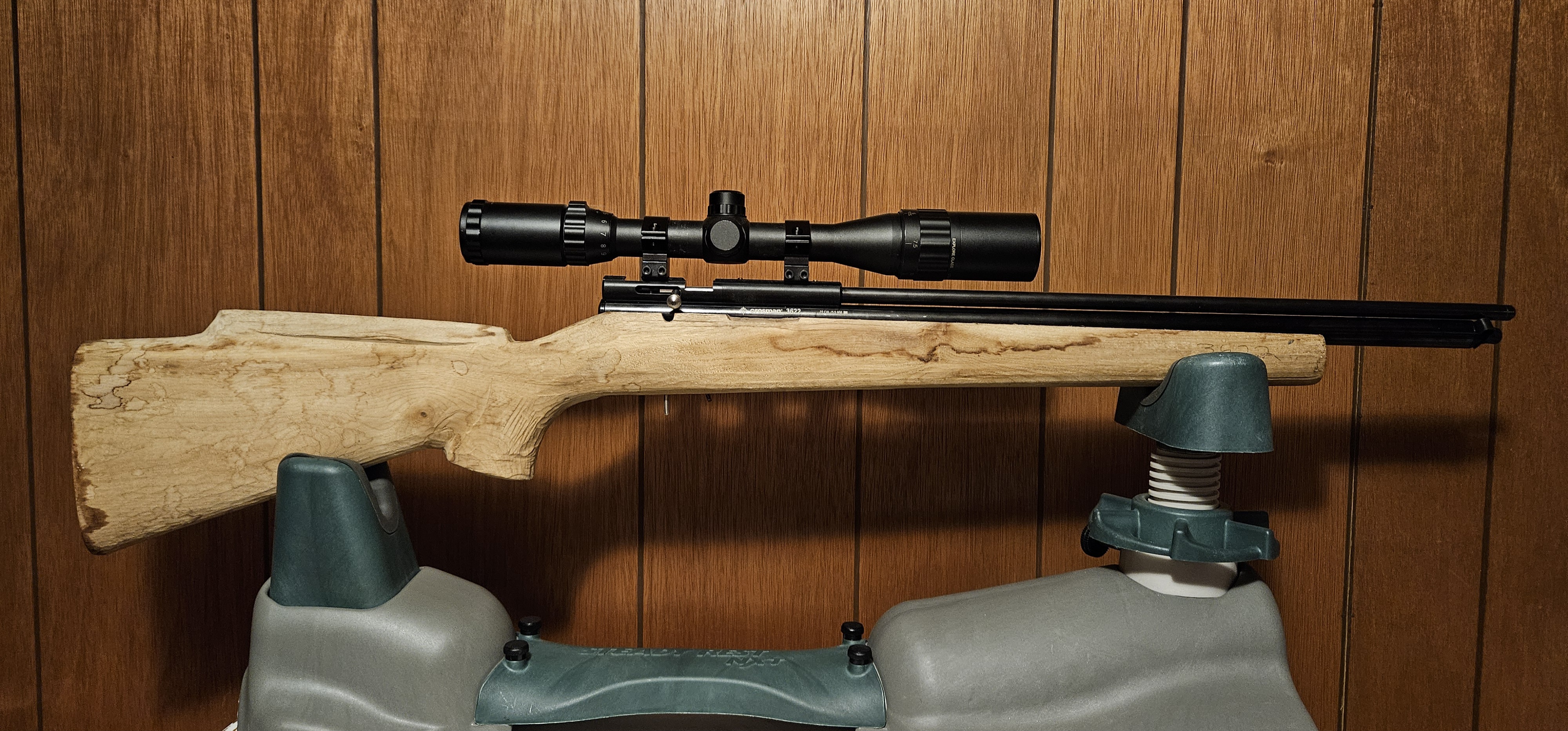

Got most of the work done on the 3622. Carbon fiber shroud with a modified Prod air stripper and a couple baffles. 40" AOL on the nose, but so thin, light, and easy to carry, make it worthy of the length.
It is SUPER QUIET. Barely any sound besides the pellet hitting target. I need to finish up the trigger guard and make a barrel band, and finish the stock. Then it'll be time for powder coating the breech.
It likes hades pellets, but I tried some RWS H points and they stacked at 25 yards, even with pretty bad winds today.
Already got it's first taste of starling too!

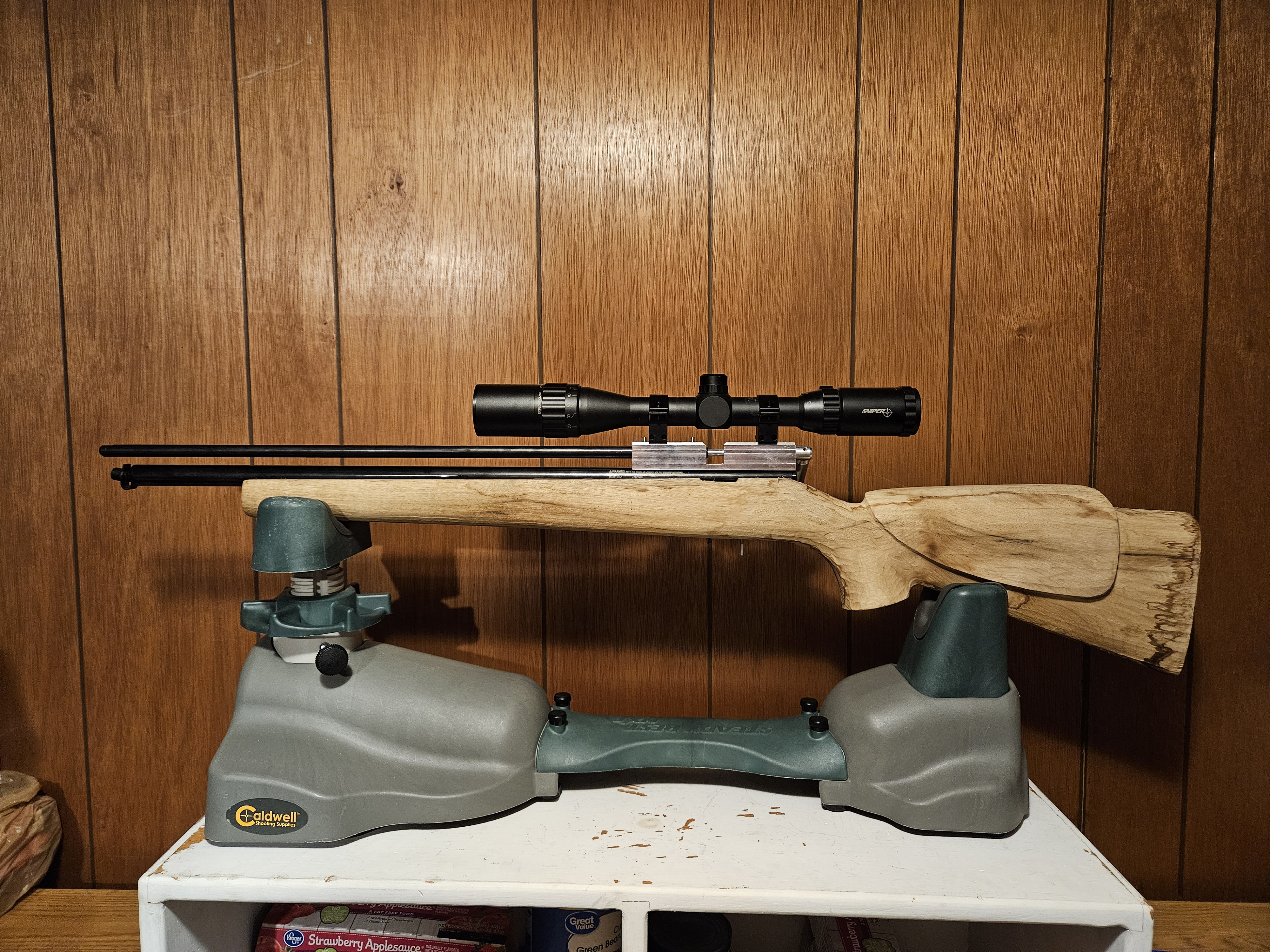

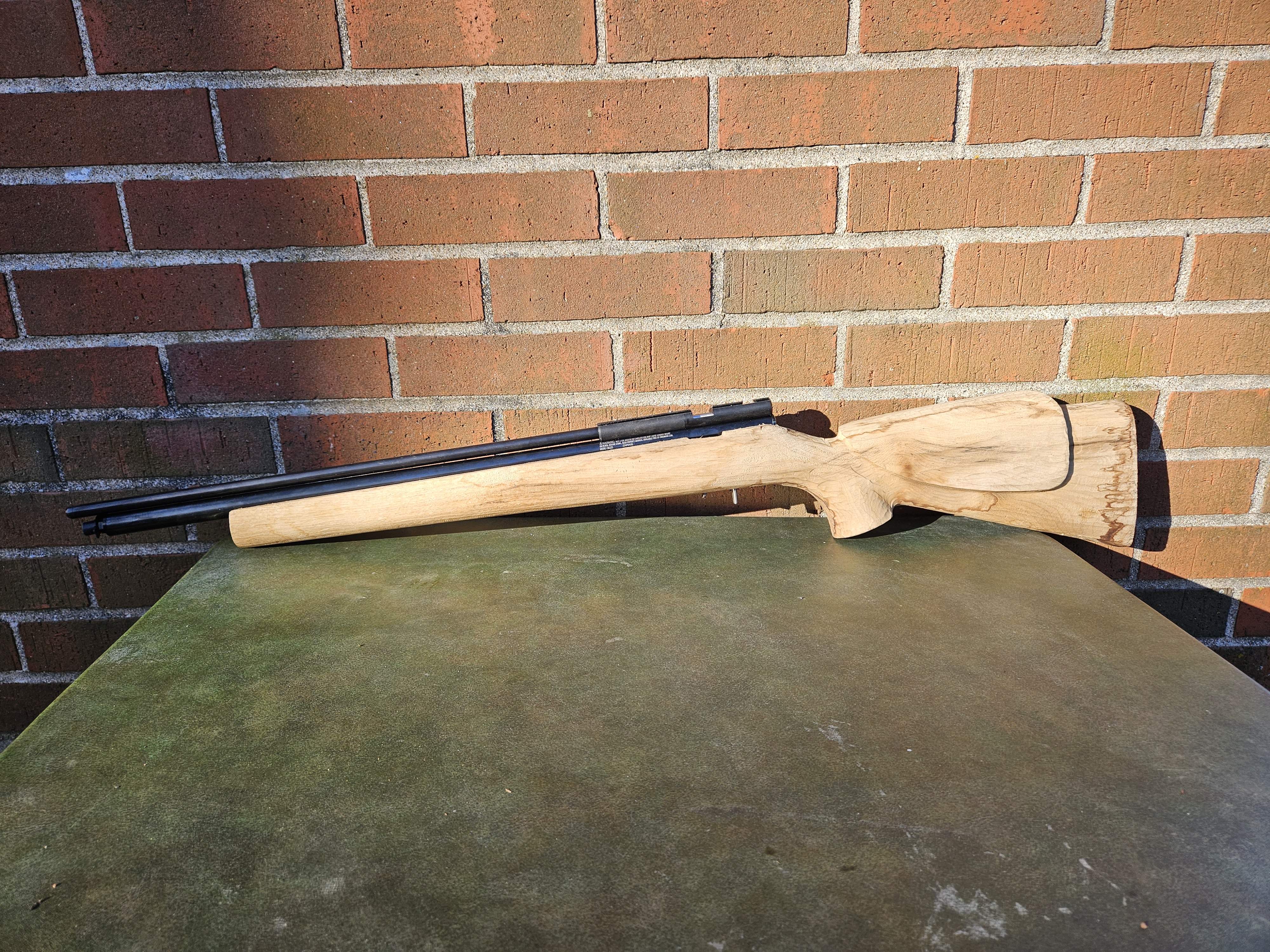

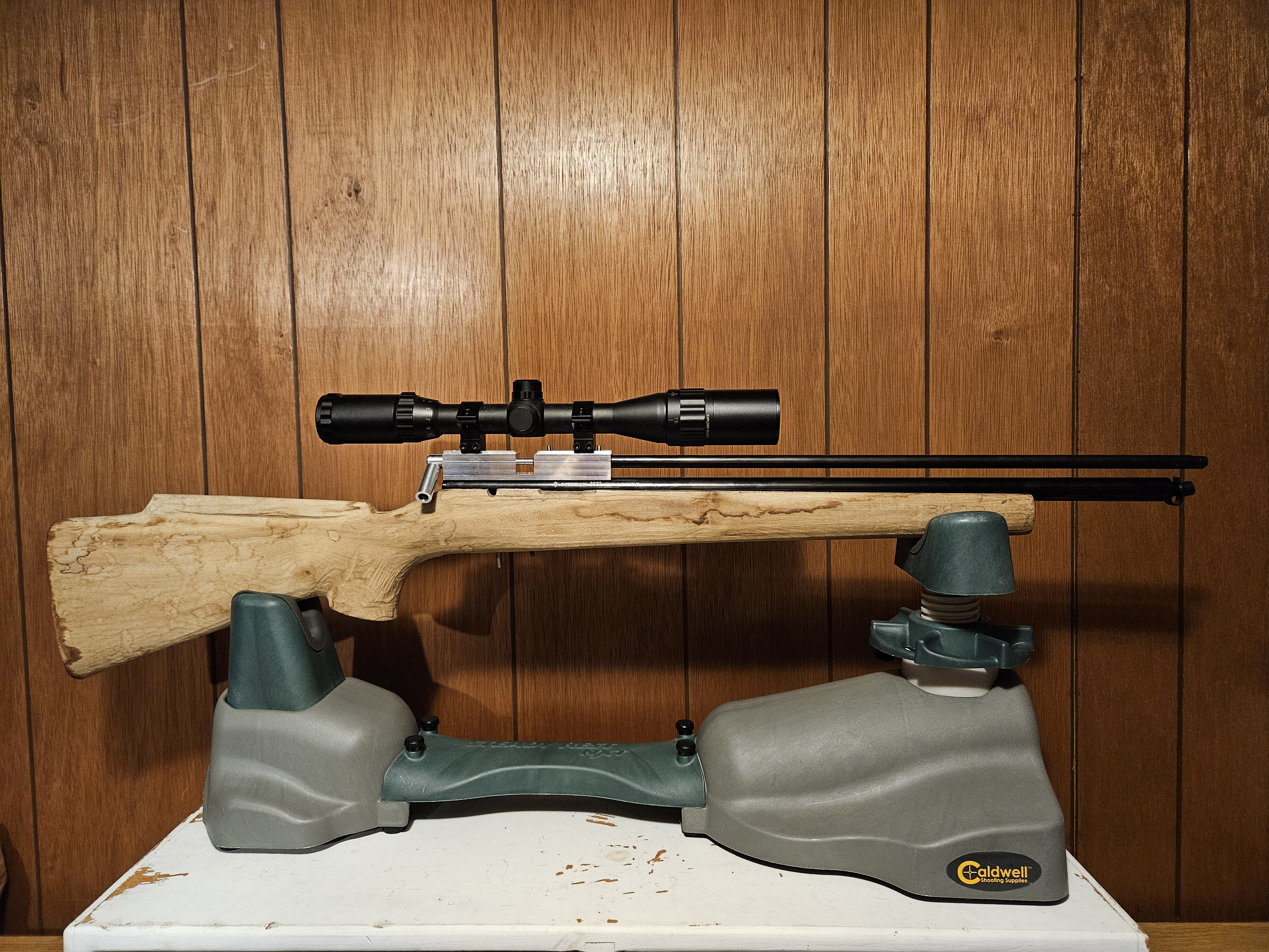

Now I moved on to the stock. I have 4 sporter style K98 Sako mauser stocks I got off ebay on an auction. They are semi finished, so plenty of meat to play with. Always loved the lines of those stocks, remind me of the daystate Huntsman stocks with the rollover comb.
I did just a bit of inletting to fit the trigger, and used a 3/4" drum sander to open up the barrel channel so the air tube would drop in. The bolt handle lines up damn near perfect with the mauser stock notch once I inlet the trigger channel just a little more, it will drop right in to the notch.
View attachment 446042View attachment 446043
I had planned to mount my multi shot breech to this action, but im liking the slim look of the rifle right now.
Here she is with the scope back on it.
Man, I love that stock! Amazed that so little inletting is required to make rhe 3622 components fit.
