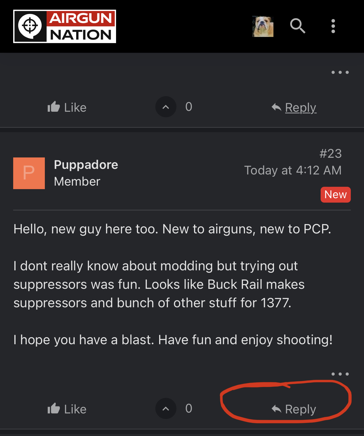

@smhardesty In a prior post I believe that you asked about quoting other members in repense to their previous posts. Take a look at the photo below.
By going to a specific post and selecting “Reply” (tap the word) it should start your post with that member’s quote above the field where you will type your response. It will appear in a box. You want to start typing outside of that box. Tap beneath that quote box if your cursor is in the box. If that doesn’t work, tap the “return” button on your keyboard/keypad and the cursor should drop down below the quote box. This is also good if you wish to place emphasis on areas of a quote (italicizing, underlining, or using bold font on specific words or phrases) in addition to truncating other people’s quotes.
Also when you want to address certain members type the “@“ symbol in front of their name. That way they will be notified when you mention them in your response. Otherwise if they are not following your thread they won’t know that you have responded to something they said unless they drop in to check out new posts on your thread. You’ll get used to these features the more that you post.
OK. I see that now. I was looking for an option to select "Quote" in the menu bar. I sometimes try and quote 2 or 3 different guys if I get behind and need to respond to multiple posts. I can use the "Reply" to get around. If need be, I can always just copy and paste selected text and place it inside quote marks. It's just a little different than a lot of other forums I visit.

@smhardesty No problem. You can quote one person, type a response to that quote then scroll to another person’s quote, tap “reply” and respond to that quote. In theory I think that you can do that as many times as you please. I haven’t seen many folks quote more than 3-4 people in a post, but it seems like you have an idea about how it works.
