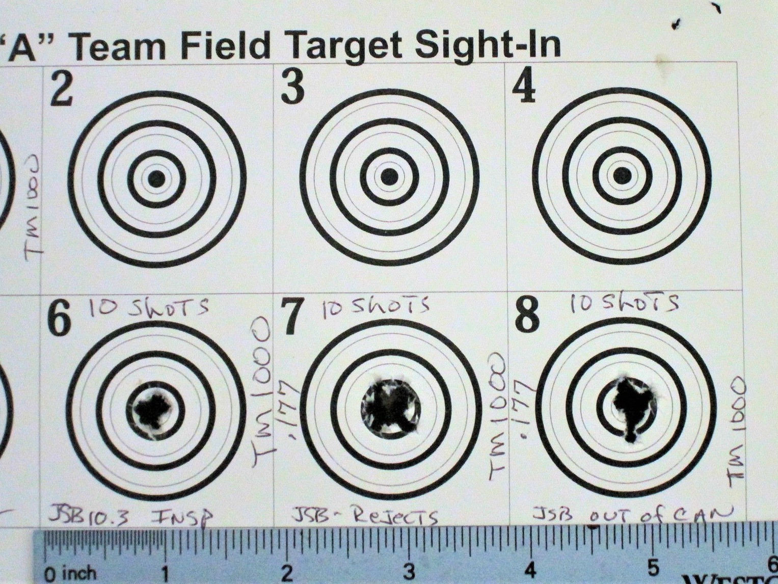

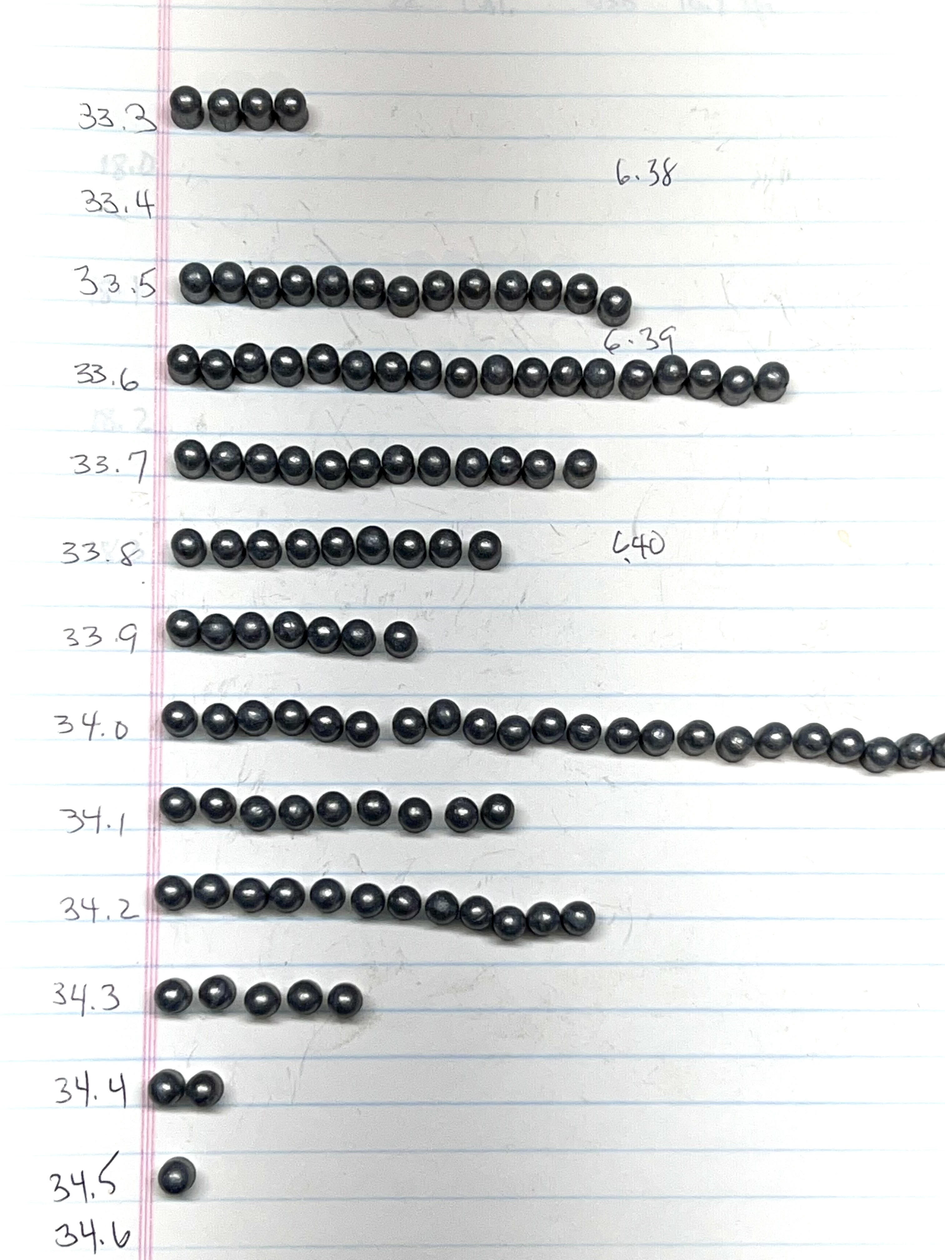

Do you think sorting doesn't make a difference?? Think again. Look at this weight distribution of 25 cal JSB 25.4 gr pellets. Here's another test that I did with .177 gr pellets. The groups do shrink in size for sure, and if you are a competition shooter, then you have to sort, at least by weight. The difference between an 8 or 9 and a 10 on the target means winning or losing.
View attachment 435136View attachment 435137
Nice work
