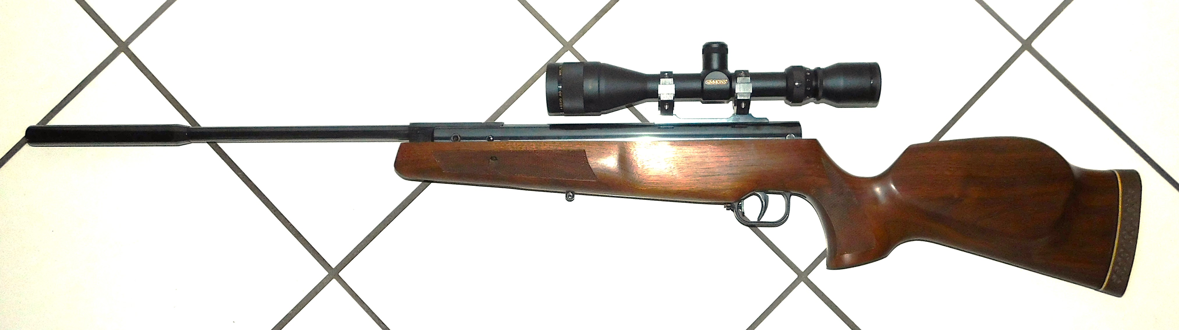

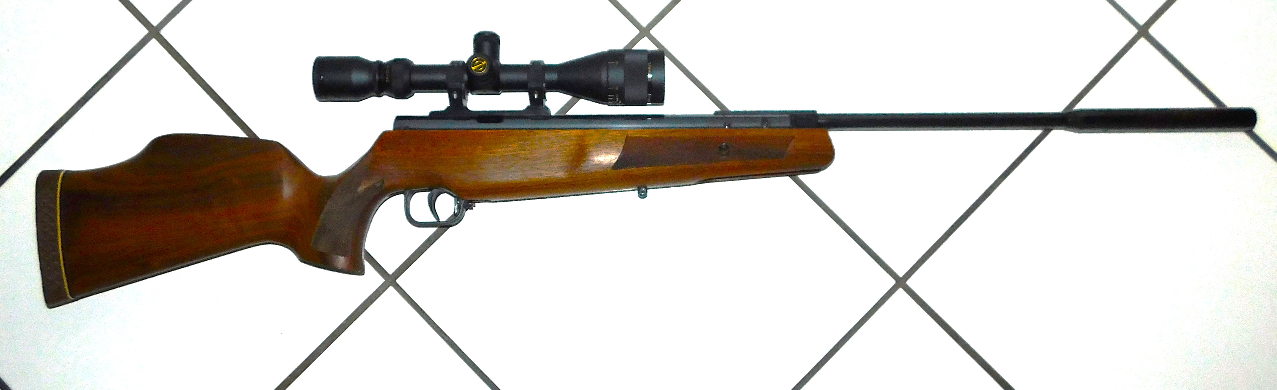

Beeman Another rare find
Beeman Classic Magnum in .20 cal. only made in 1992. Another Theoben product through and through but marked and marketed by Beeman. Rated @910fps I'll likely keep it a bit below that and test some pellets to see which is most accurate then decide what power level to shoot and keep it.

Beeman Classic Magnum in .20 cal. made in 1992 only. Another Theoben product through and through but marked and marketed by Beeman. Rated @910fps I'll likely keep it a bit below that and test some pellets to see which is most accurate then decide what power level to shoot and keep it.
Congratulations, great find! Looks to be in nice condition too.
