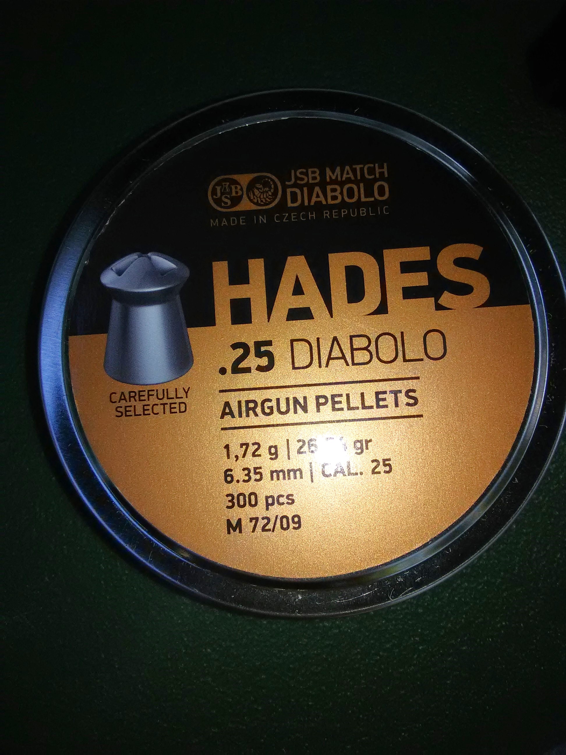

With unwanted "self-tightening" valve spring hopefully corrected, decided on another overall repair attempt. Completed full cleaning and lube, followed by removal of DonnyFL adapter and re-installation of baffles/air stripper. Regulator increased from 130b to 150 and HS adjusted fully in, out enough to just allow side-lever operation. Shotgun patterns and pellet clipping forced return to DonnyFL adapter and (pictured) empty can (STO-FALX) for noise control. Chronograph revealed JSB 33.95s were leaving muzzle @ 650FPS so lighter pellets needed. Out of (26 grain) Predator Polymags, (27.47grain) H&N Barracuda Hunters, JSB Hades (26.54 grain) and H&N FTT (20.06 grain), only Barracudas and Hades grouped. Further HS adjustments and testing showed Hades was best with HS one full turn out, from seated, Six shot group @ 50 yards (pictured) with median of 840 FPS and SD 6.5. More Hades on order, further testing ahead but promising results, WM

I'm STILL amazed that Hades are the most accurate pellet out of my Royale 500. Started using them about 5 or 6 years ago & never looked back.
Had a tin for couple years, no PCP would group, tried many times. Glad I had them, kind of saved the day. Ordered another tin from Pellet Shop, 27% off .25 Hades sale. WM

Thanks to The Pellet Shop for quick, well-packaged delivery of JSB Hades. Noticed a full air charge caused MAX regulator to creep from 2200 to 2300psi, which Hades seemed to prefer. After 10 shots, Hades grouping opened up. Re-adjusting regulator from 150 to 165b happened to stop creep and provided consistent Hades grouping, HS remained one full turn out from fully seated. Chrono work ahead but formula seems promising. WM
