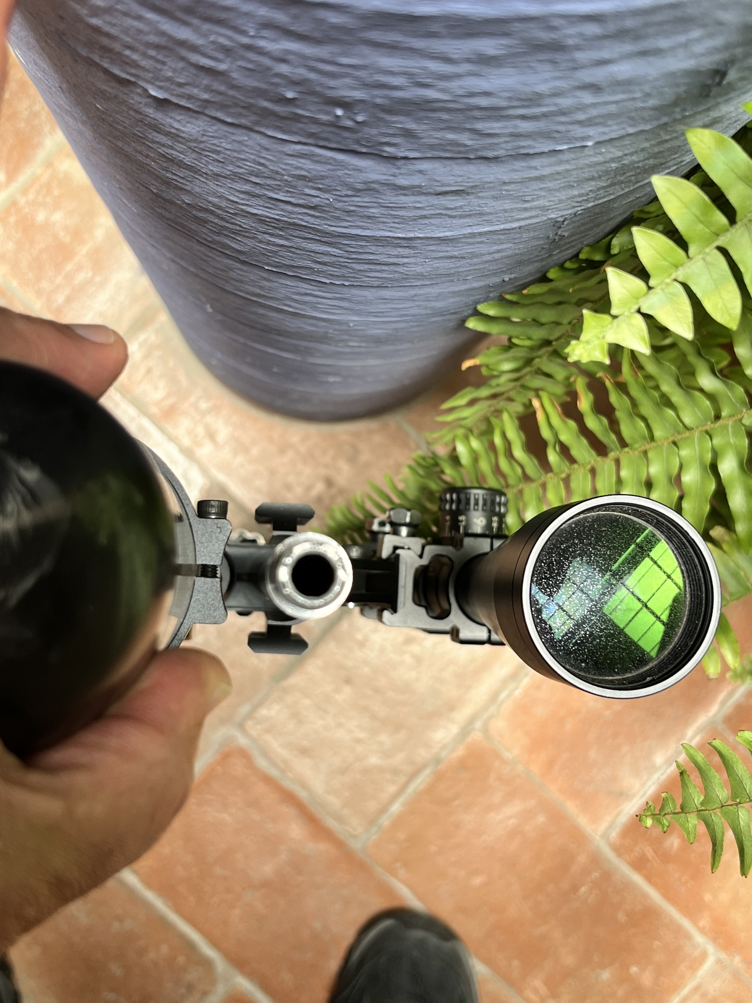

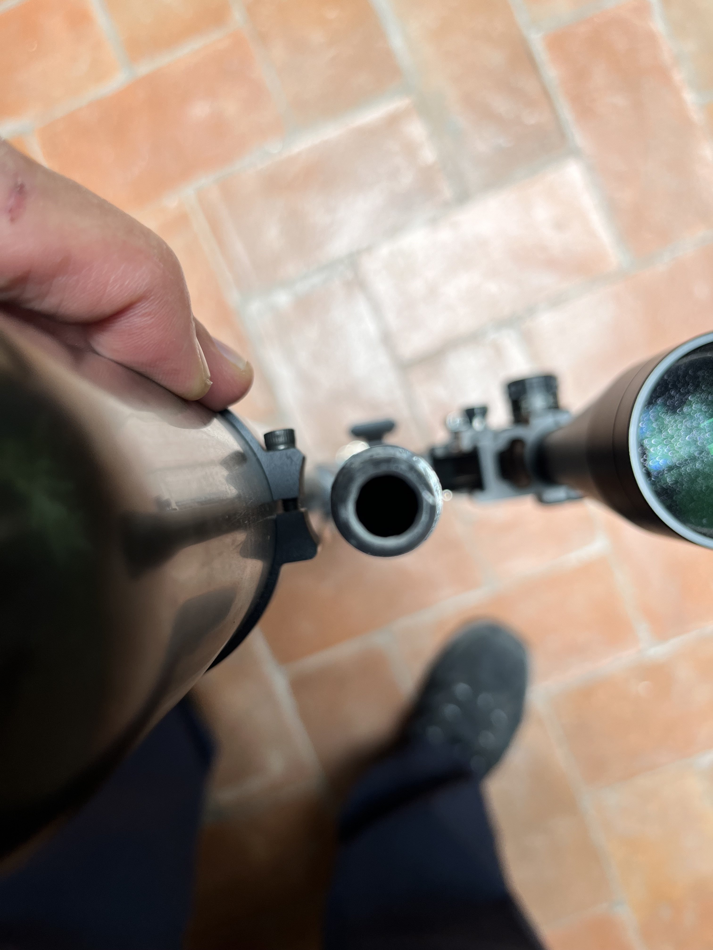

Western Airguns Another unarguably success of the weird drill tip
Now the magic was made on the Sidewinder .30 Cal.
I was not entirely happy with the accuracy of this rifle.
Went for the help of the weird drill tip, made the recrown of the barrel of the Sidewinder and now the accuracy is as good as expected.

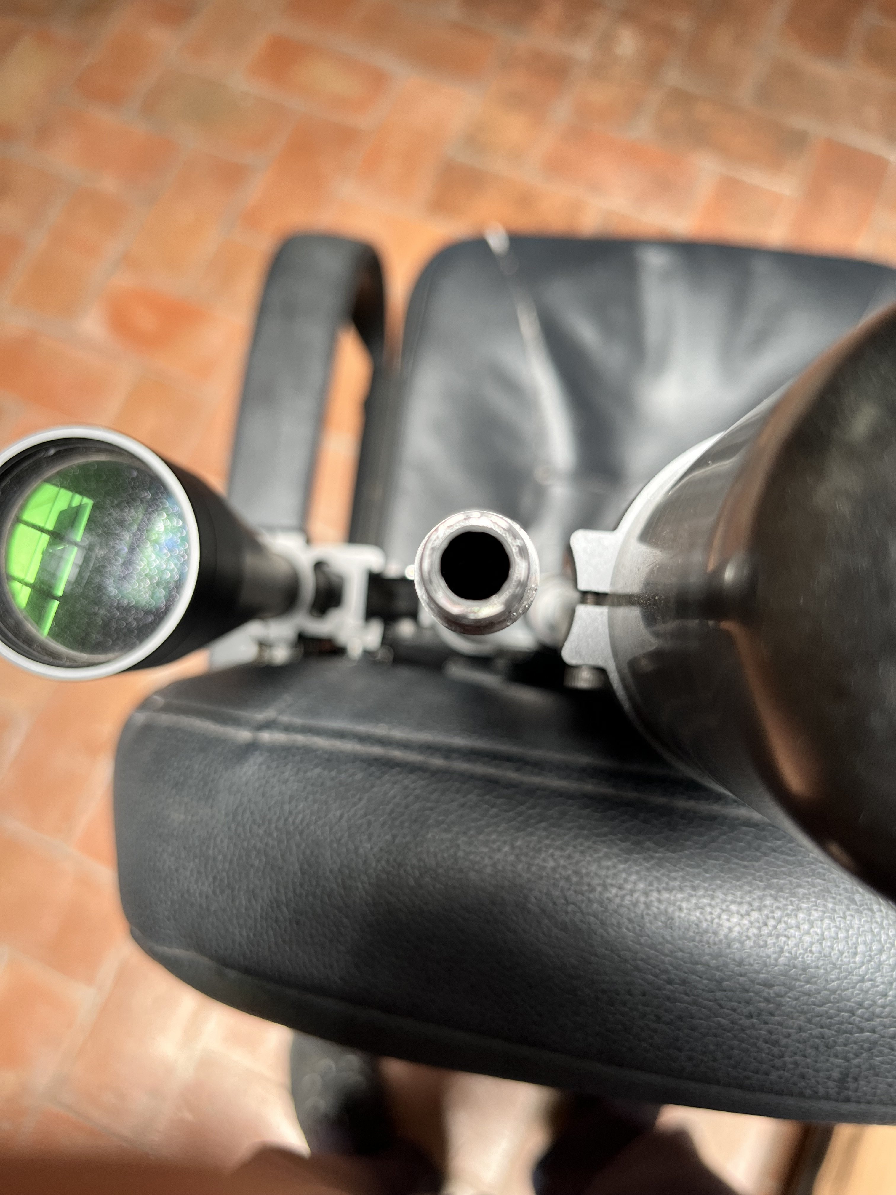

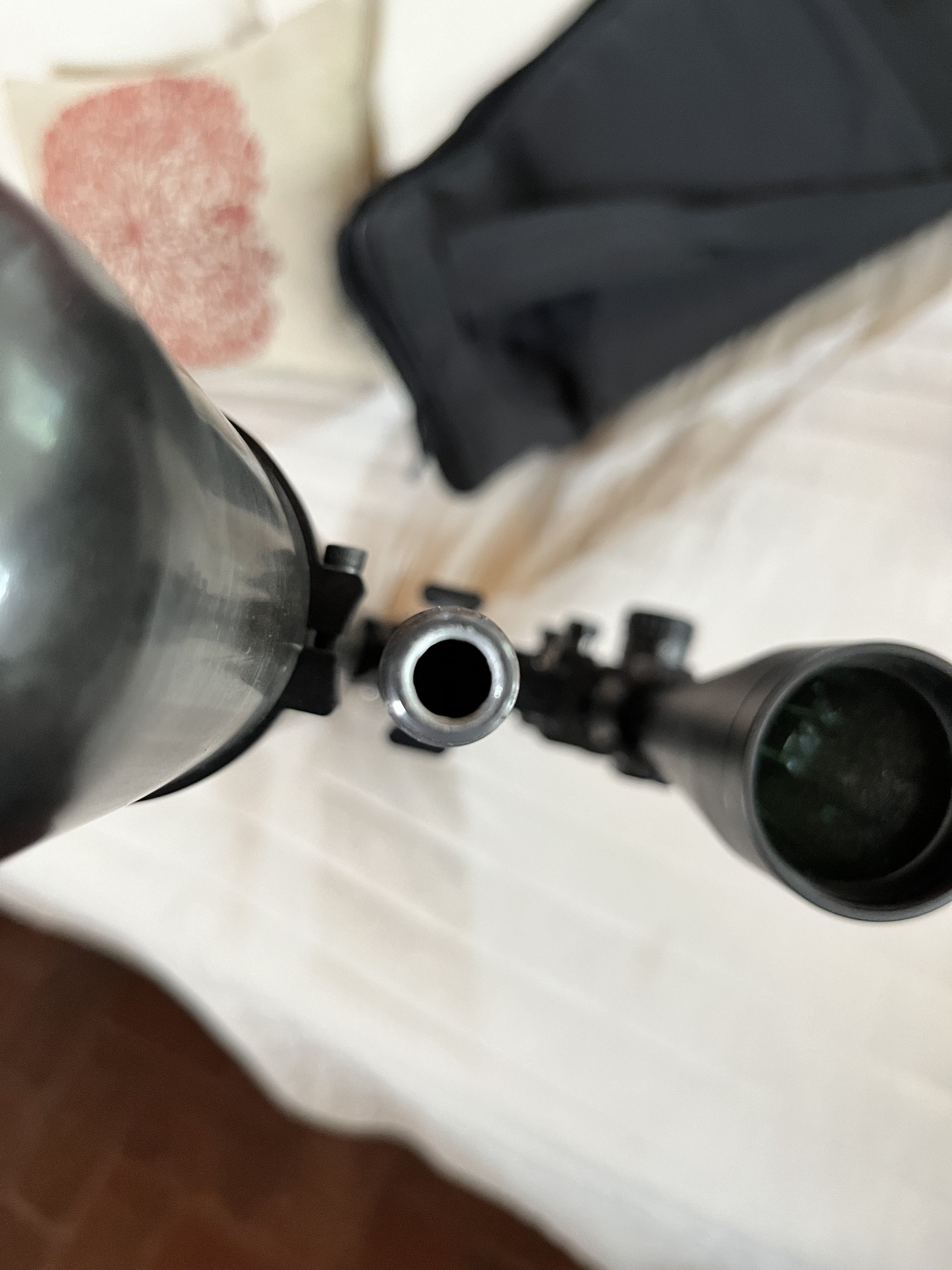

That was a bold move with that cutter, how about a pic of the new crown.
Can't argue with results, curious what possessed you to attempt the re-crown with that attachment?
I looked at a video at YouTube on which the recrown was made with the head of a flat screw.
As soon as I saw that I realized that that tip would work much better and indeed does it.... Has not fail one time on the assignment !
