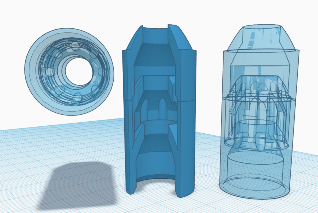

Here is a Tesla valve insert I designed yesterday for a narrow shroud space. 11mm bore in a 22 mm i.d. I went the Tesla valve route because there’s not a lot of space for conventional baffles I think and they might just perform well in this circumstance. Who knows. Three of these will fit in the shroud tubes I have and I can just print it as a monocore or separate baffles.
I know there’s a lot of volume occupied by those thick walls but I don’t want to start with something flimsy. If this works at all then I’ll start hollowing out a little more volume and maybe contouring the baffle rims to direct air flow backward rather than trapping it in a corner and forcing it back due to filling.
