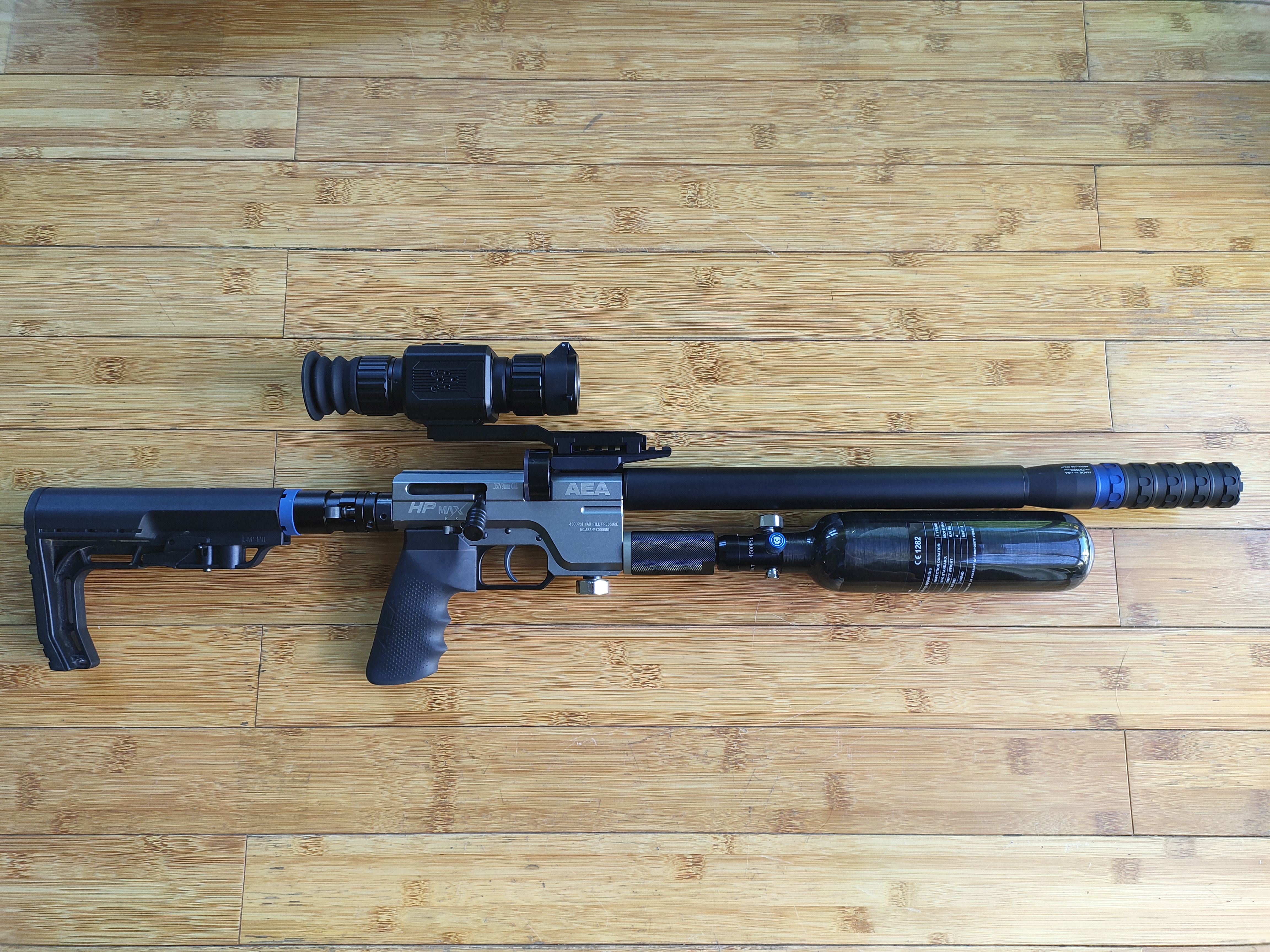

I have an AEA pro. 9mm I absolutely love it I have 7 air guns and it' in 2nd place behind the FX dreamline bullpup .30 in 3rd place is the Air Venturi .25
I ended up picking up a used .357 Max and tuned it down to be a backyard night pesting gun. This one probably gets the most use now out of my entire collection.

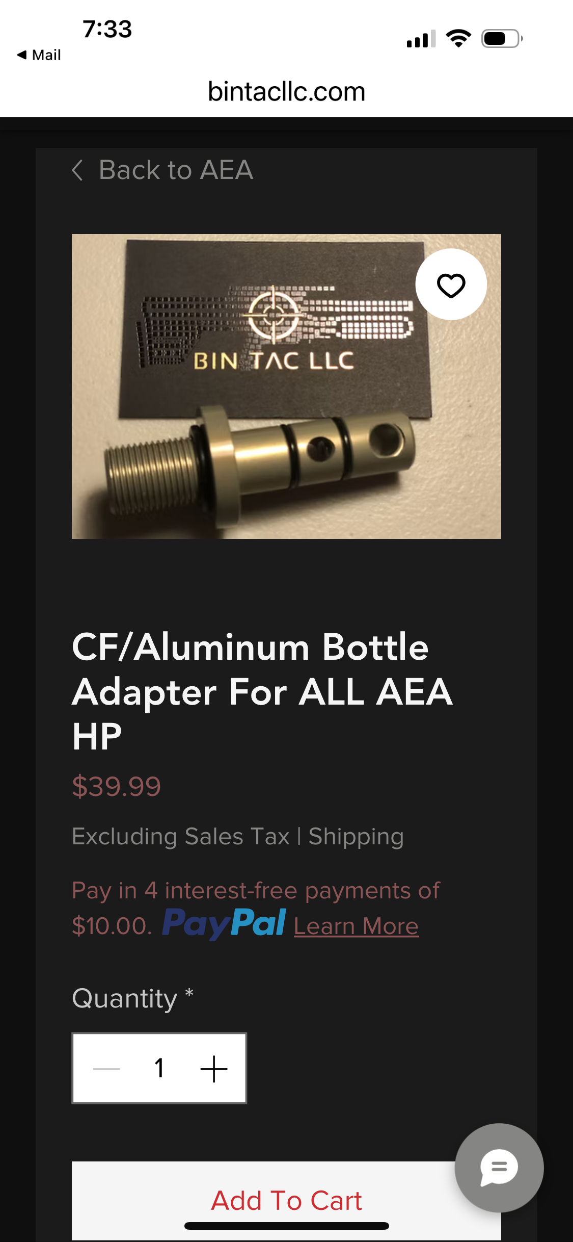

i got a DonnyFL adapter for the Max but the adapter doesn’t fit any of the ldc’s I have (which all use a common standard). Does anybody make adapters for DonnyFL adapters? LOL. I should have known it would have a larger diameter I guess.
Donny fl makes them

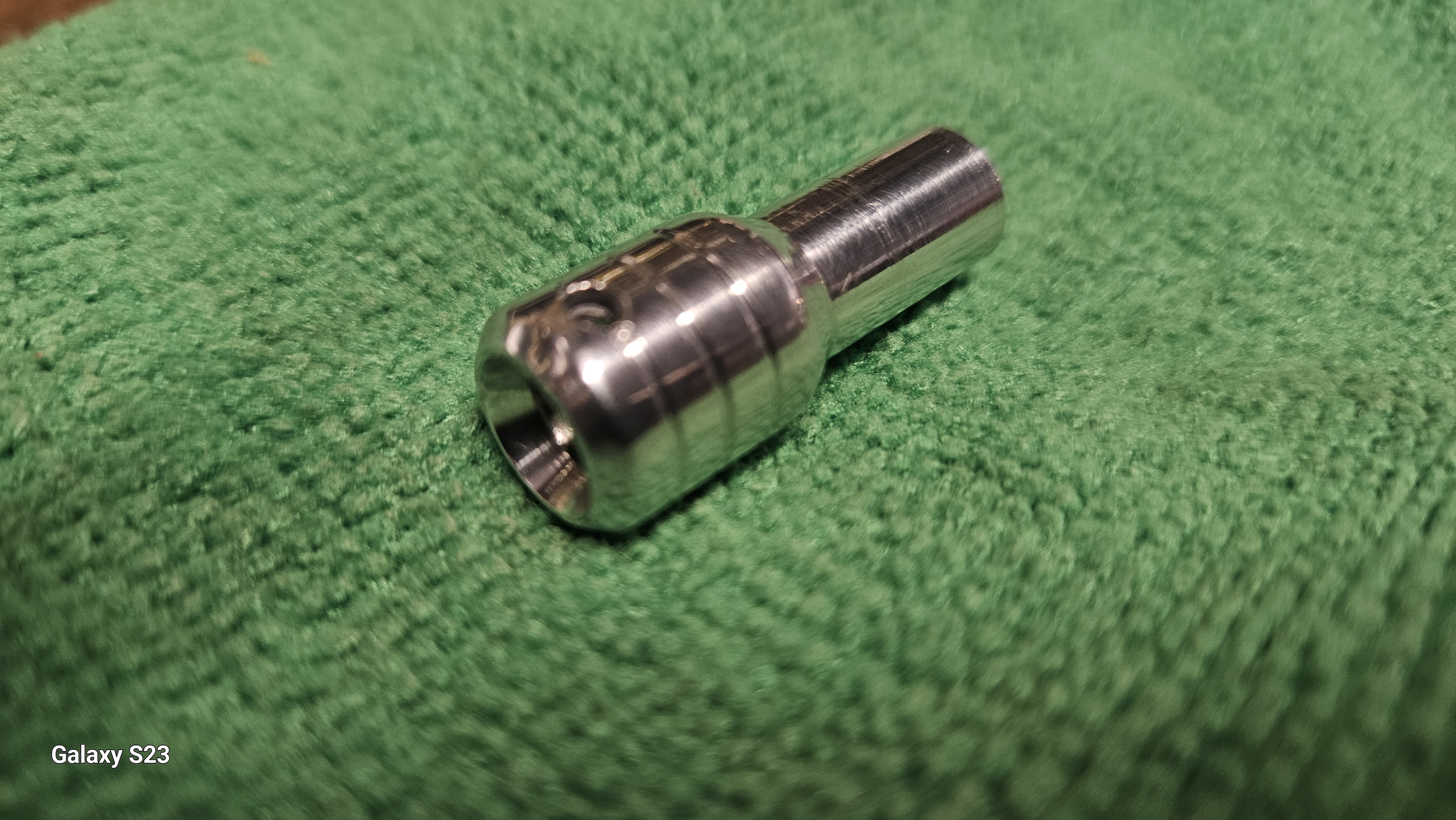

I have Swede mags for my TD in 25 and SS in 22. Makes a world of difference in reliability. I made bolt handles for mine to give it more grip. And for increasing power I made some bushings that fit in the back of stock on the guide rod. You can also adjust spring pressure down by unscrewing stock some.
Make sure the bolt handles are not to heavy. Added weight will make the bolt rod snap off. Happened to me. Pellet shop fixed it
I have several thousand rounds on mine. Made them for others have not had a problem. I use aluminum and handle is hollow. The rod you talk of is hardened. Has a hole drilled through most of it. It will fatigue after a while and break at the tapped hole. Had one do that couple years ago at about 5k rounds. A heavy bolt also throws the cycle off and it will not load consistently. I have three AEA's. Two HP's and a 30 Terminator. Terminator is a tank.
