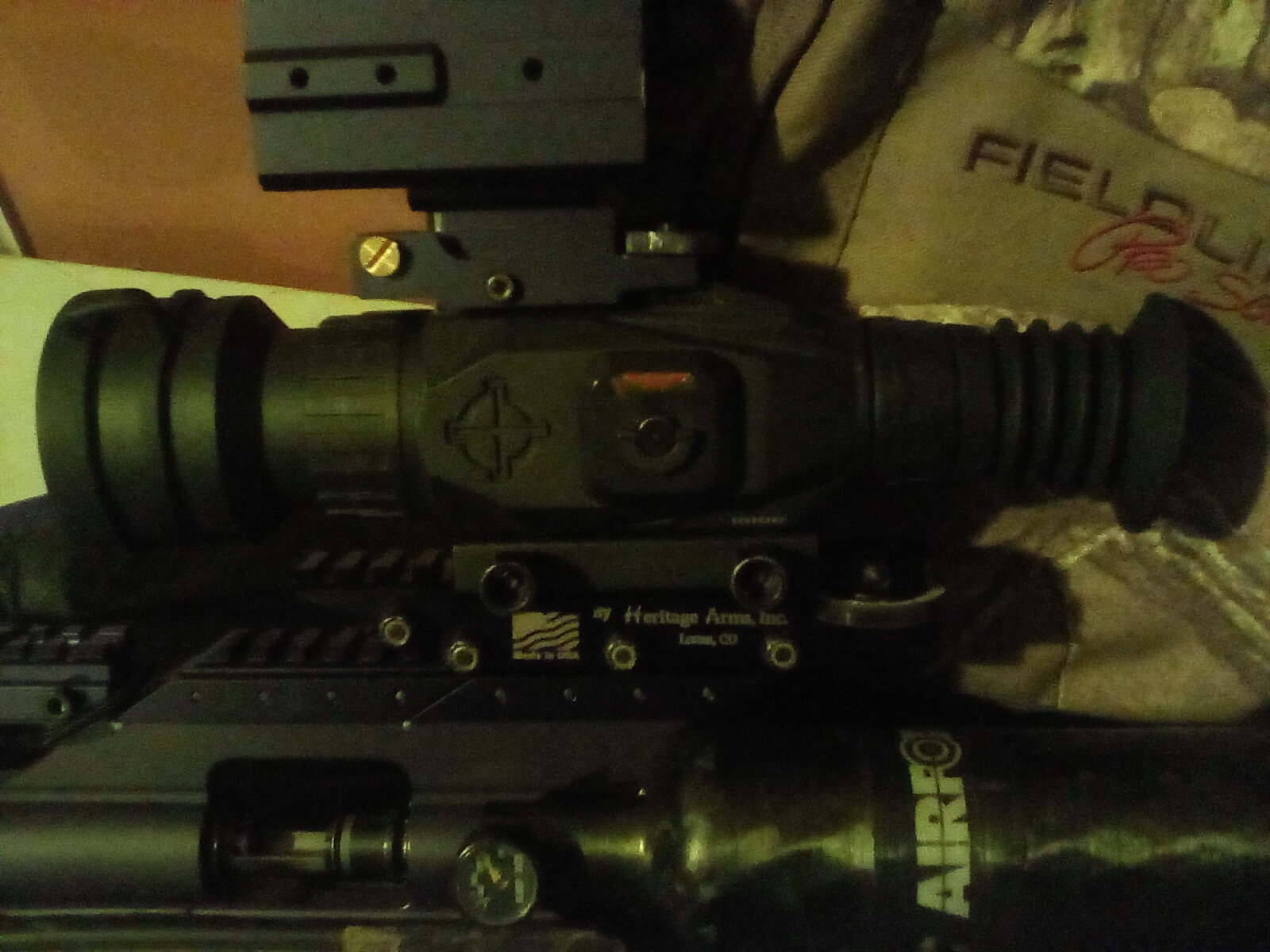

At 300 it wasn't on my range. and before I lapped my barrel . I hit the two ft metal first shot and knocked over the metal. I was pretty gimped up and couldn't get out there and check it. I was happy my drop charts and B.C were good. Also happy with my sightmark wraith 4-32 with cold shot adjustable base. I shot some plastic bottles at 350 yards and was in the ball park. I had major ankle surgery and was on crutches. Its really made it hard. My Texan barrel was horrible then I had to clean hard every 4 shots for any kind of accuracy. 1 fouling and 3 good shots.Also Texan broke Twice!!! And rebuild yong heng 2 more times. I'm doing much better now and have some yong legs to help me so ill do.some long range distance shooting with videos outta my sightmark wraith.. Also I hand lapped my barrel for a few hours with 6 lead laps... Now it is consistent.. Long range hard with poopty barrel..but I lucked out it is smooth and uniform now . enough to.do a lil long range testing..

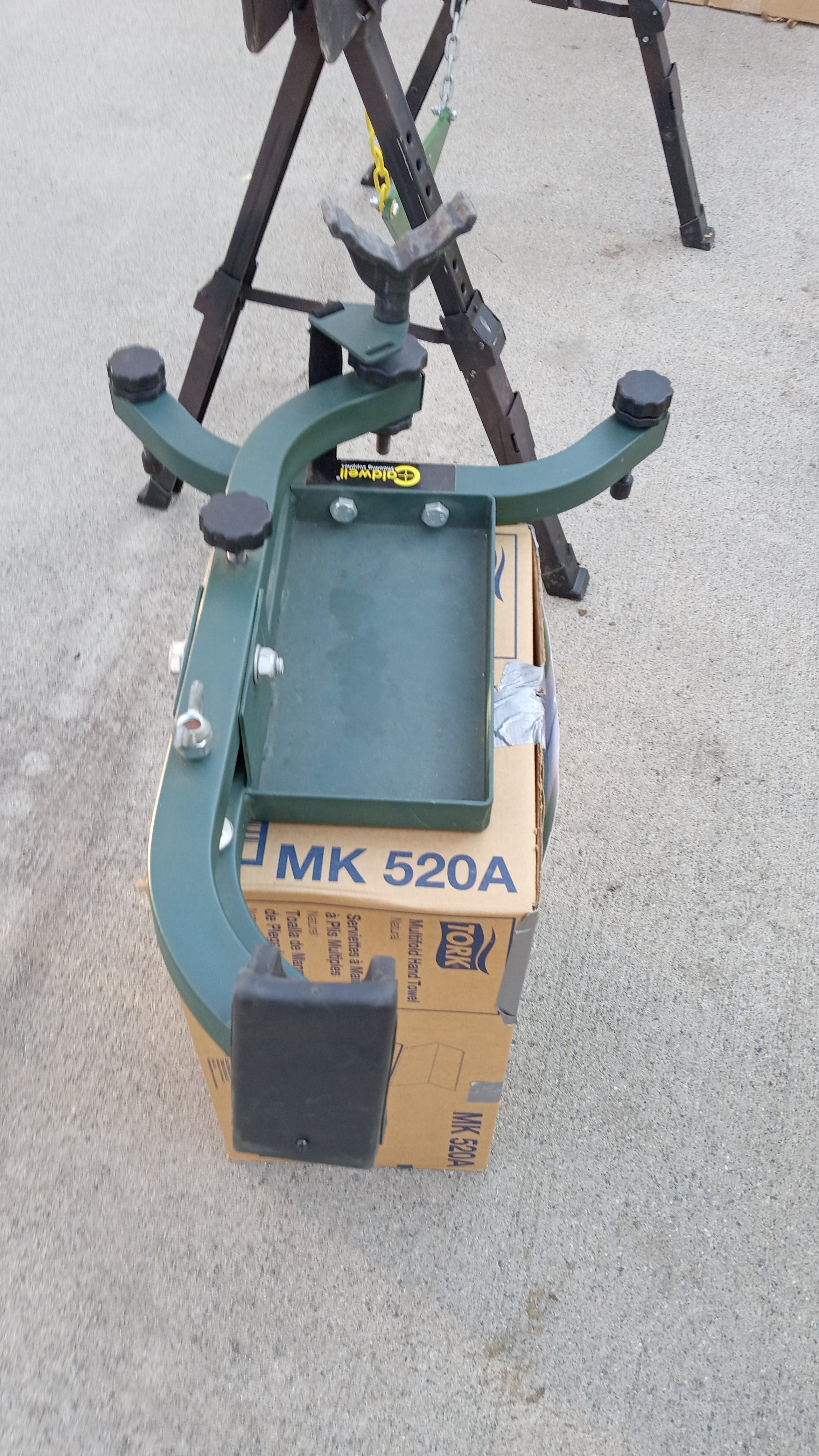

I have a AirForce Texan 257 that i have only a few days, Yesterday i went to sight it in, lol I shoot left handed but my friend has a Caldwell rest for right-handed shooter and there was a 9 mph cross wind. This is what i got at 100 yards with 72gr HP and the 3rd pic was at a different location, no wind at 140 yards same ammo, the big target is 4 inch and the next one i thing is 2 inch. I Have a AEA 357 big bore 357 and 25 cal avenger that's modified but my fav is the 257, not even in the same league.
