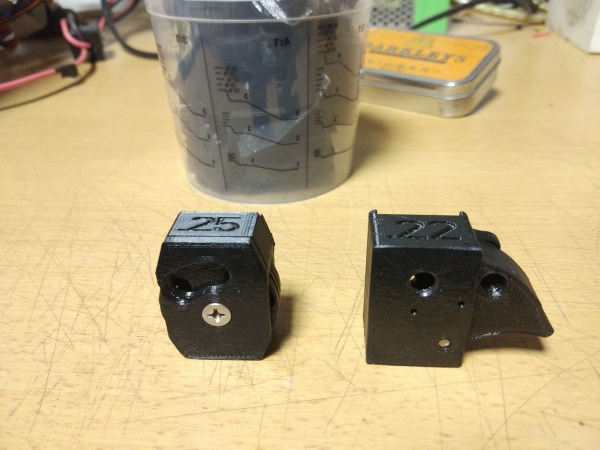

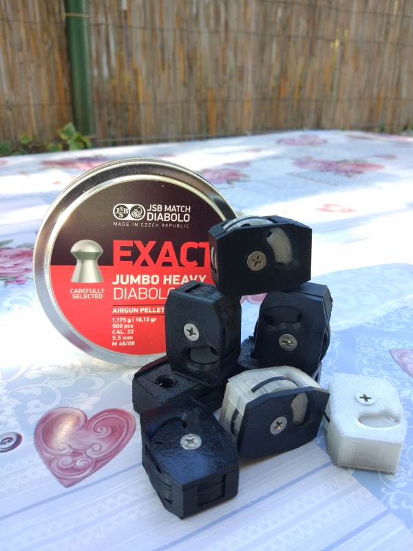

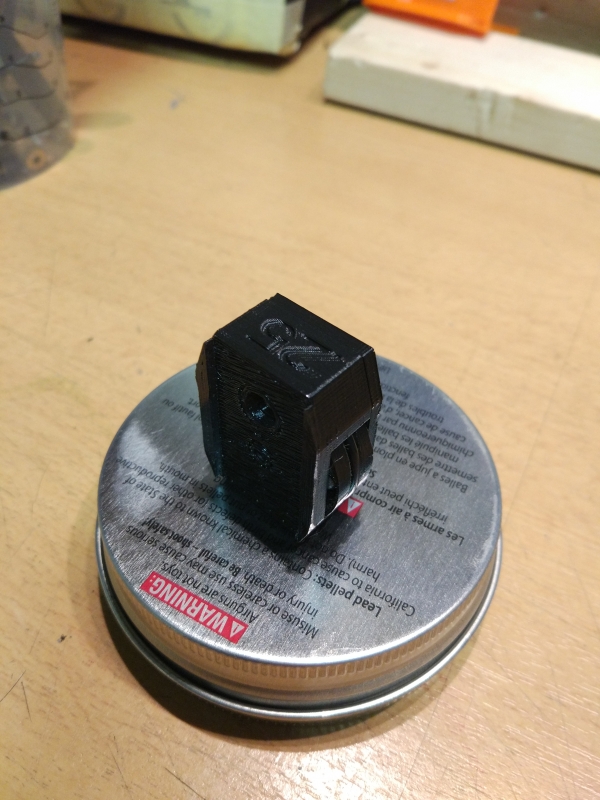

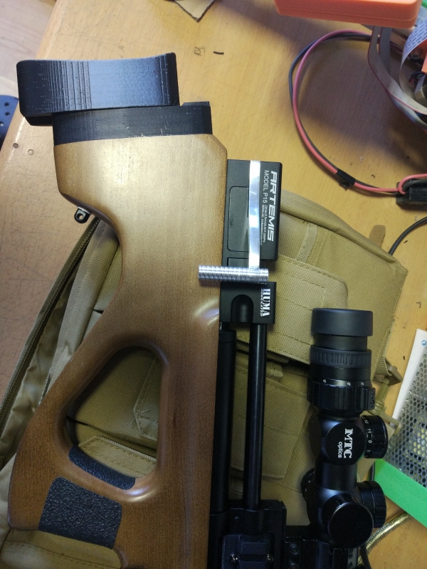

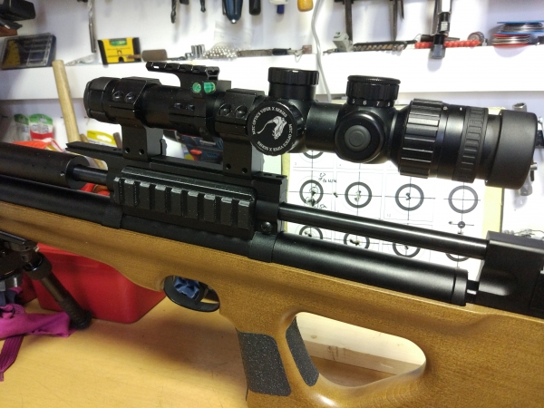

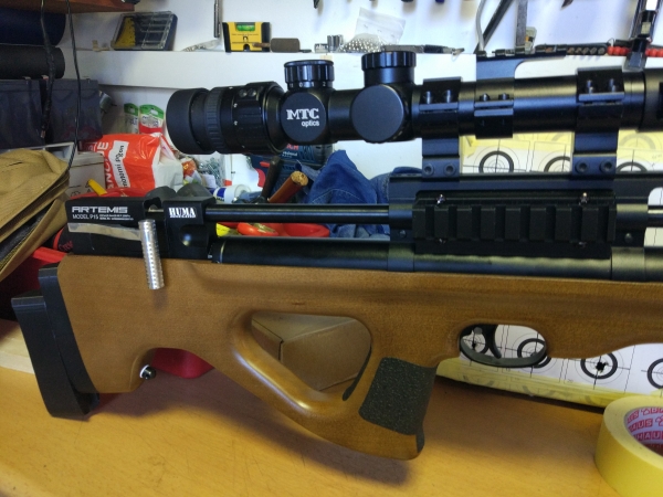

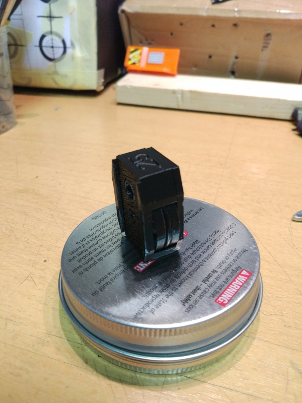

I have P15 i .22 and i love this little baby. I made some modifications (new shroud baffles, longer but stock, biathlon lever, huma regulator and i designed new magazines because i did not like original ones. Scope is MTC Viper Connect 3-12x24 and fits beautifully on this rifle. You can see shooting at 50 meter in video and new magazines i made (they are only 7 pellets but much easier to load and no flyers.

How's the new mags test's going? any issues with it so far?
They are working perfectly (shooting in video is from the magazines) . I will finish . 177 version in few days (waiting for spring wire) and i will send them to few people to test them .
If you ever make them in .25 and decide to sell them, I will buy 2. I haven't messed with the ones that came with the gun much. My gun had other issues. I did notice they seemed very tight when chambering a pellet. Switched to single shot tray until I get gun lined out.
