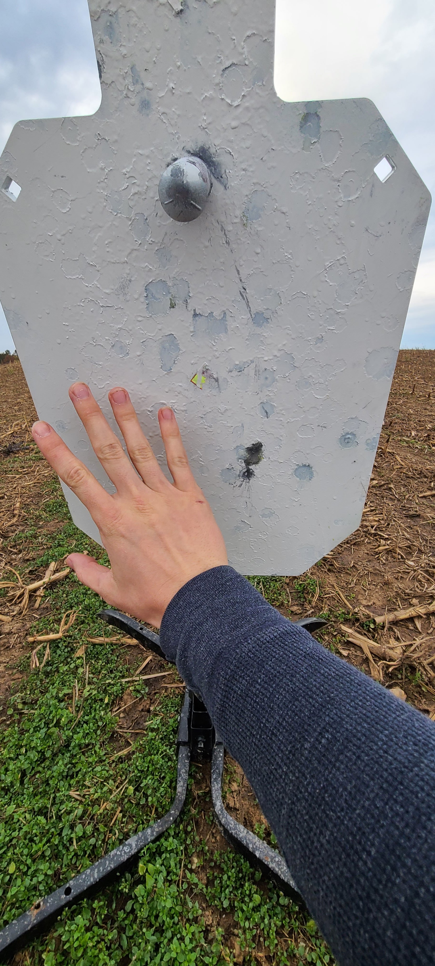

I have a western rattler 357 i shoot out to 400 pretty easily.
I shot out to 600 yards with a 357 texan last week. The only real difficulty is wind.
I shoot at a steel head and torso thats 13 inches wide by 20 inches tall. At 400 yards its pretty much an 100% hit rate if you know your wind call.
Here is the best 3 shot group ive ever shot at 400 yards which i managed to get last week with my stock airforce texan .357
On average i can get handsized groups at 400 with both the rattler and the texan.
Edit: i guess i should add that i have a coldshot moab on the texan, its tethered with a huma inline regulator set to 2750 psi and im shooting 174gr raptors from higharc hunter.
Your groups are impressing coming from a stock .357 Texan.
This is great intel and gives me hope for a really big bore for long distance.
