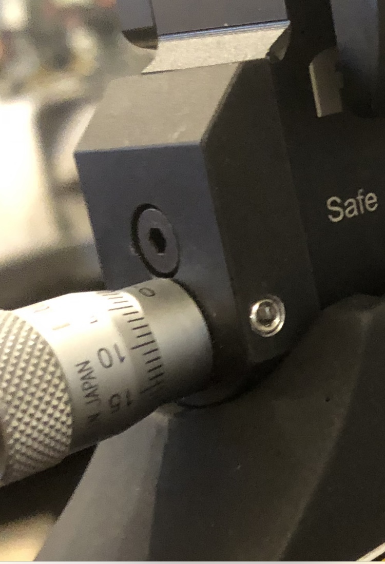

I don't have to own the 20-position wheel to tell you that it will have all the same downsides as the original fx powerwheel. Phil's micrometer is the only upgrade to the fx power wheel worth doing -- and it does it right. I was concerned about the micrometer's thimbal accidentally moving, but with normal handling it has never moved unintentionally. There is a fairly snug o-ring inside of the micrometer to keep it from free-spinning. If it's not enough resistance for you, then you can add a 2nd o-ring. I've had no need to change anything about Phil's micrometer mod.

It's really amazing, the nano changes you can do with it can speed up the tune significantly.

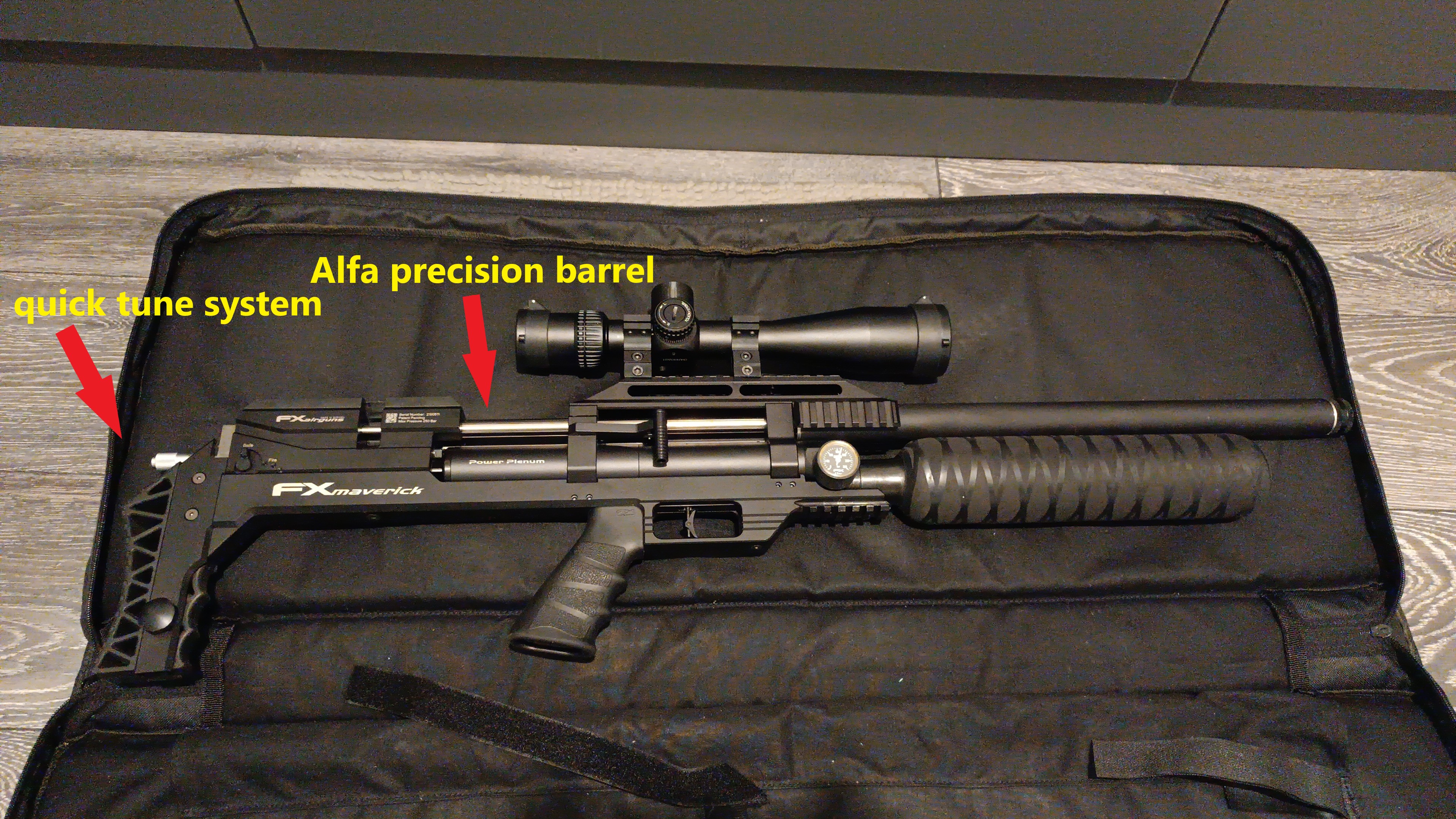

Here is my pride, maintained and extremely well run. Alpha Precision's barrel+synchronized quick tuning system = oh my god.
It is capable of results:
