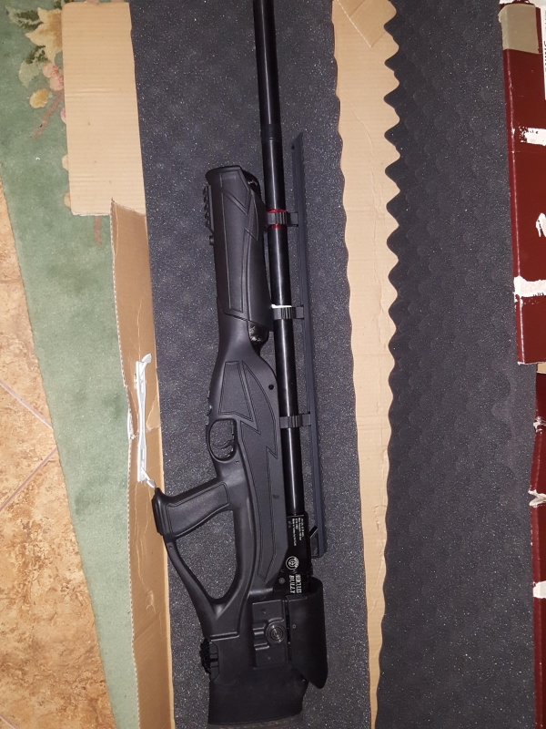

And you are right...the bottlecover is not a good place for a tripod i use a position before the bottle
I have put some very smal plastik peaces between the barrel shroud and the barrel bands becouse its
a smal place between this conection this is in my eyes an accuracy error place to
I am in oktober in serbia and can you send some pics from what i mean

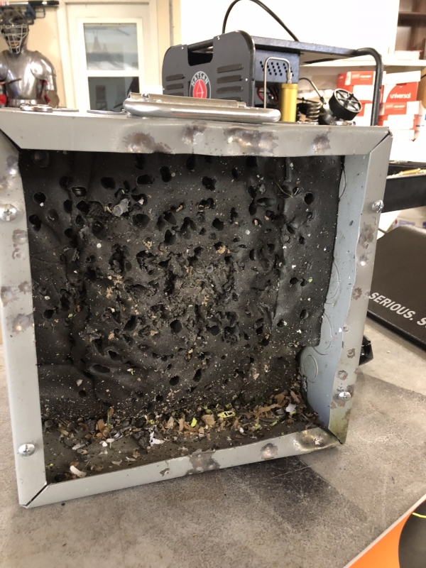

Well, finally got decent groups on paper at 40 yards. I’m starting to realize this Bully has a sweet spot at around 3200 to 3000 psi. The problem I’m having is I’m chasing groups. It started with all those scattered ones at 11:00, trying to walk the crosshairs in to the bulls eye. These shots were at a fill of 3600 psi. I walked the shots over to the three shots two inches above the bulls eye, adjusted the dials and finally hammered out the groups at the bull, and noticed at those more consistent groups I was hovering around 3150 psi. Refilled the gun back up to 3600 psi, Then all of a sudden, the group way over at bottom right at 5:00 came about. With my Marauder, a re fill only moves the impact off 3/4” max, and within a couple of shots I’m back on target. If it was a squirrel it would get hit. With this Bully after a fill, I’m not so sure.
This gun gun is high maintenance, I swear. I need to get a regulator for this, but Altaros said the highest they have is set at 190 bar. I don’t think that’s sufficient?
Meanwhile, this 30 caliber is just hammering my 16 ga pellet trap. I use magnets to attach the targets to the trap, and I’ve already shattered a few of those.
