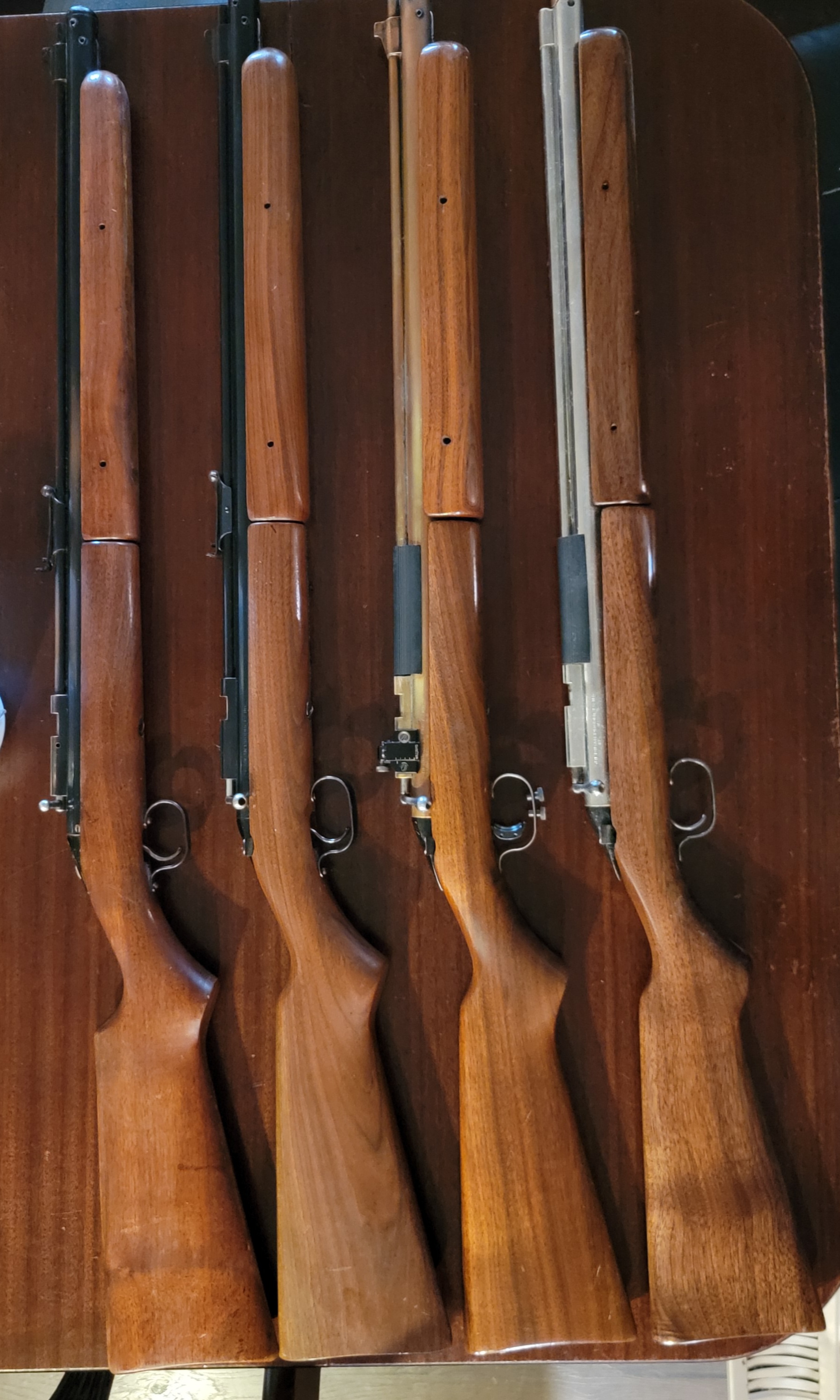

My favorite pumpers are the Sheridan/ Benjamin/Crosman models built in the 90’s. American made quality (before Crosman had them very long) with Walnut stocks. Easy to work on, lighten the triggers and rebuild. Incredibly solid and accurate. Becoming very popular and $ for these reasons.
I go older then that.
I get iffy after 76..
Mine are 55, 65, and two 71's.

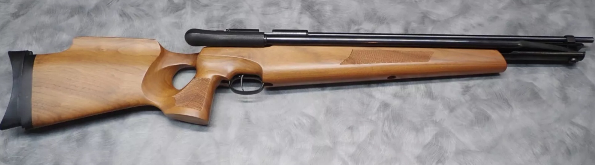

I wish someone would produce these you can find them but they have a huge price tag. Titan Mohawk. View attachment 503324
That is one uniquely good-lookin' stock!
Hmm... all I'd need to do is copy it -- maybe mahogany or walnut or some other equally beautiful hardwood -- chop it off up front for forearm separation, lovingly hand finish the pieces to perfection, carefully plug in and secure all the business bits of a Crosman 362 with a steel breech and Williams notched rear sight, get 'er impeccably sighted in and by thunder, I'll be walkin' in some of that tall cotton for sure!
That's the ticket. Hey, it could happen (sigh).... :)
Thanks for the photo anyway!
Hmmm interesting :unsure: I'm a big fan of pumpers. Modified 362??
