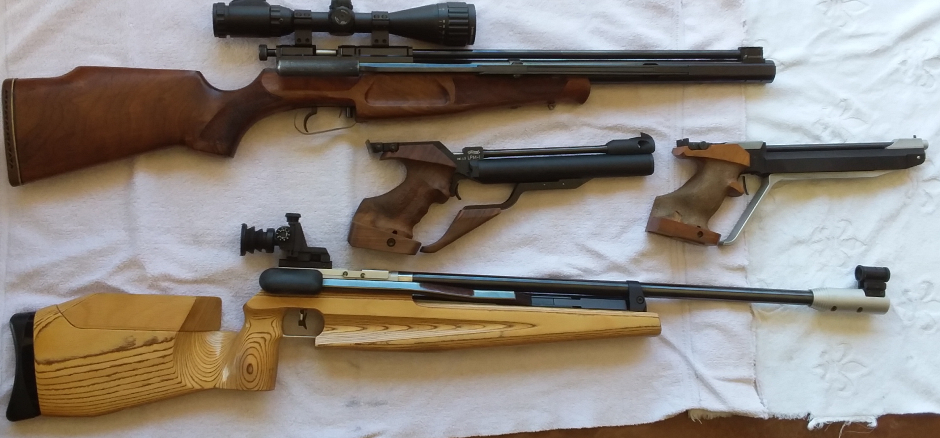

Only a couple of these are still being produced but it's my little collection of pumpers...
Just my opinions based on being inside a LOT of airguns but the Aspen is really close to being a GREAT ... maybe the best pumper of all. It's a little less than durable but maybe could be fixed. I didn't have the same feeling about the Independence... it felt sloppy, rickety, and very short lived. Both are really good ideas with not so great execution. In my little collection, the Sharp Aces reign supreme but the pumping effort can be high for the power. I had a Quigley rifle for a while and it also brought some good ideas to the table. The Phillipine Survival rifle isn't bad either, but pretty heavy. The Dragon is only 10.5 ft lb but interesting. It has weaknesses too. Sportsman is heavy and can can be pretty powerful but pumping effort is high. The Benjis and Sheridans are SO hard to beat but the lack of scope mounting is a pretty huge thing imho... My 140 Custom is incredibly accurate and not too difficult to pump but has a weak valve arrangement... which was addressed one way in a previous post. The old 100 could be PHENOMENAL but the valve is an ancient design that limits power and requires a big hammer hit...

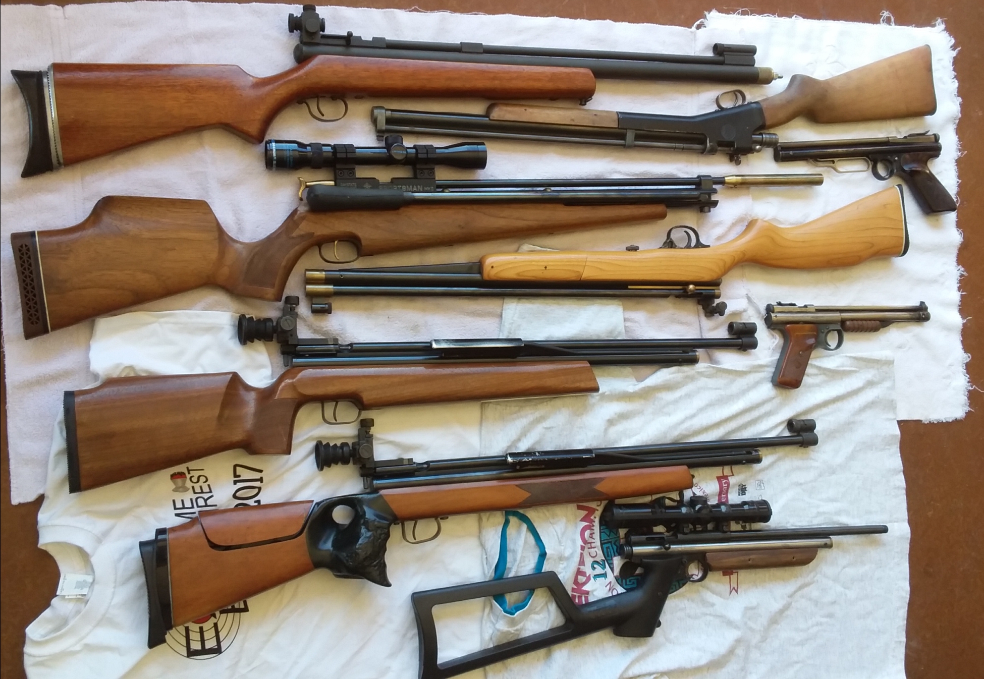

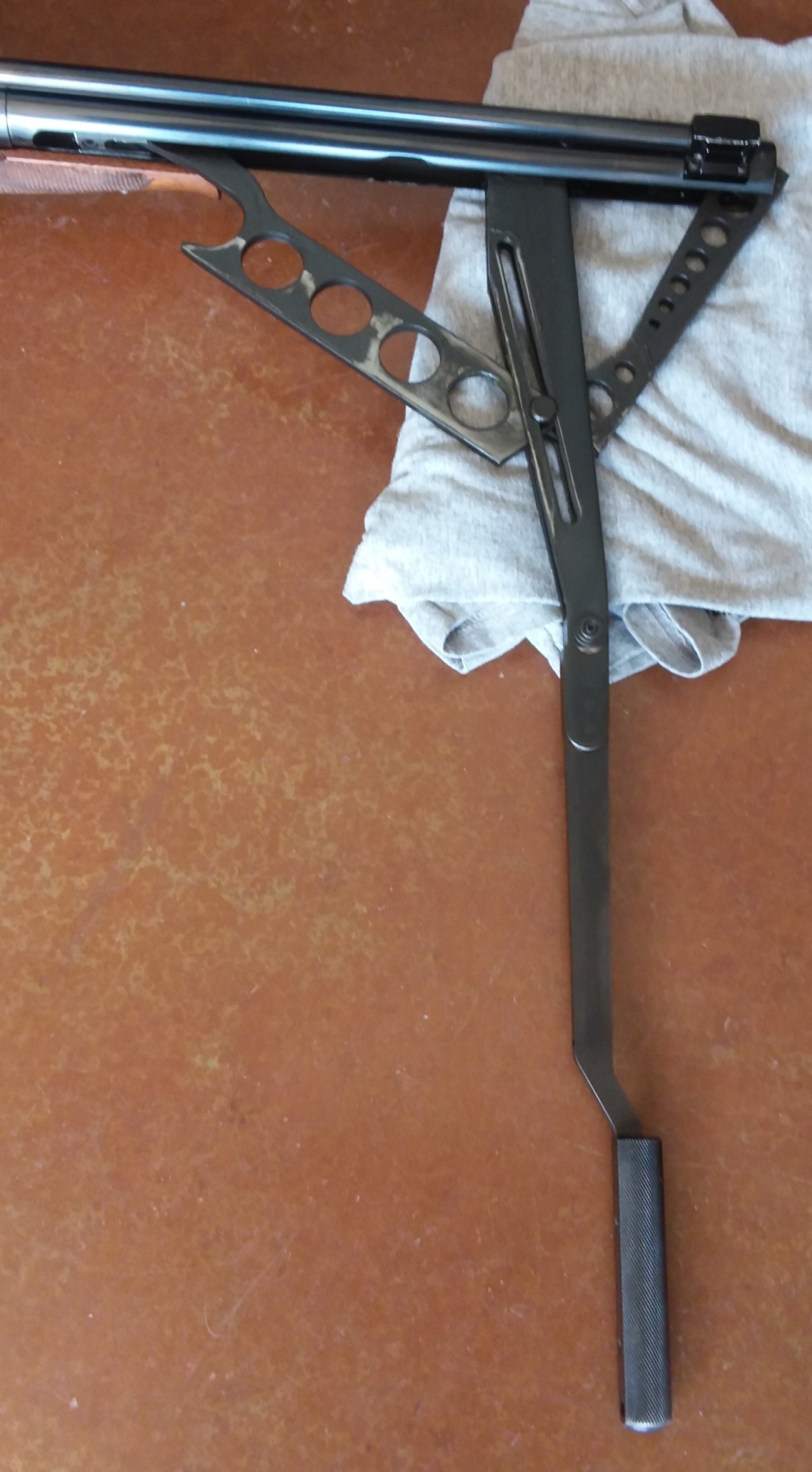

I was just looking at the pump lever on the IZH 46 wondering if a similar mechanism would make an easier pump on a Sheridan ? maybe i will find a junk Sheridan to experiment with ?

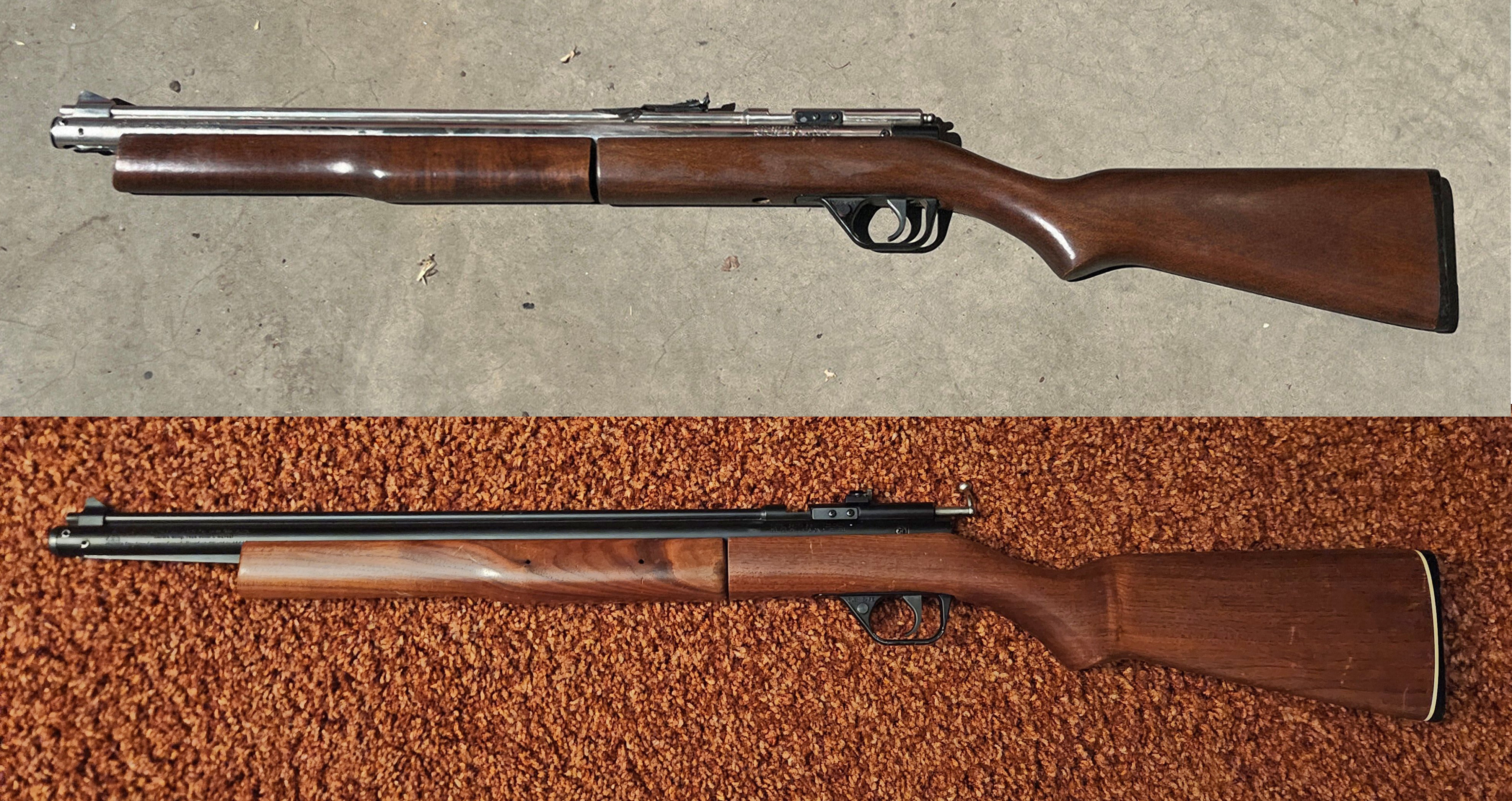

Although not quite as extreme as that, Mac1 used to have another modification he would do where he cut the front portion of the stock off just in front of the trigger guard and then moved the forearm back creating a longer pump lever.
I believe the bottom gun is a Mac1 Steroid that has the extension mod. Top gun is factory.

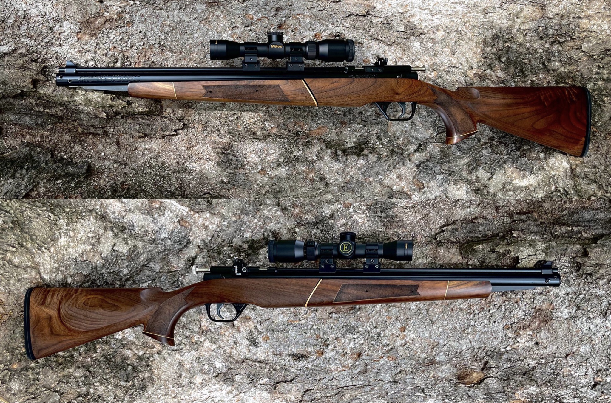

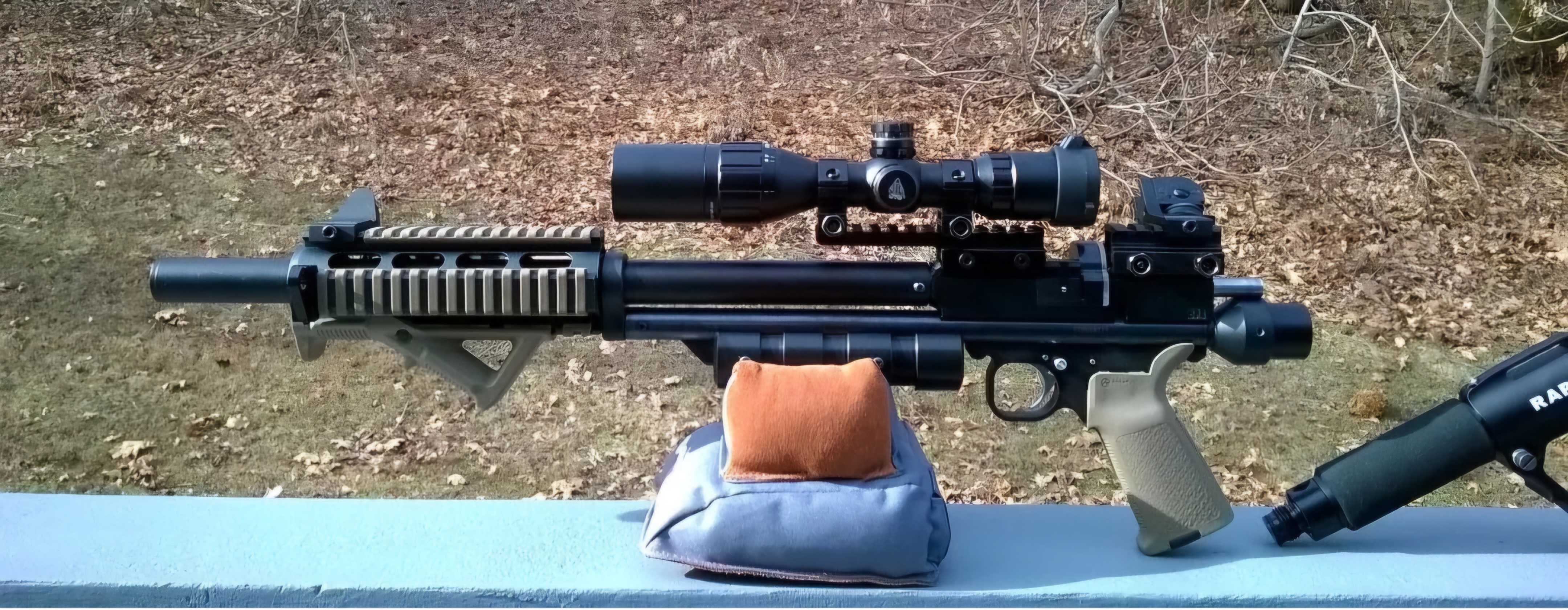

I picked this up from AOA’s used airgun list. It has a Steve Corcoran custom stock and a Mac1 Steroid mod. Unbelievable pumper. I call it the “Machine”. Just so easy to pump and a true tack driver. Had a hunch that someone who would drop $ for the SC stock had it worked over also. Probably, because it was so accurate. And now “I know the rest of the story”.
I picked this up from AOA’s used airgun list. It has a Steve Corcoran custom stock and a Mac1 Steroid mod. Unbelievable pumper. I call it the “Machine”. Just so easy to pump and a true tack driver. Had a hunch that someone who would drop $ for the SC stock had it worked over also. Probably, because it was so accurate. And now “I know the rest of the story”.View attachment 504070
Amazing looking build!
