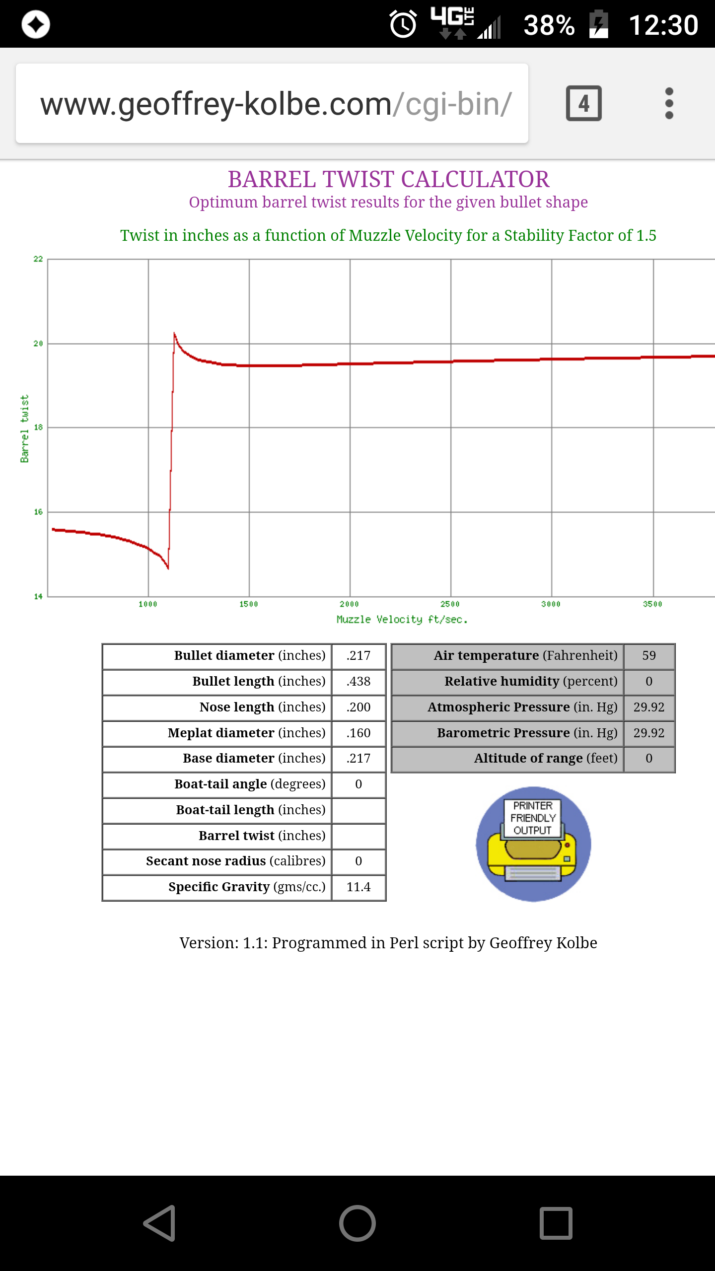

The geoffry-kolbe twist rate calculator indicates that twist would probably work well. If you made them to drop into a few popular guns, like an FX Impact they may sell pretty well. I don't have a .22 barrel for mine, so I'd be interested in going this route.

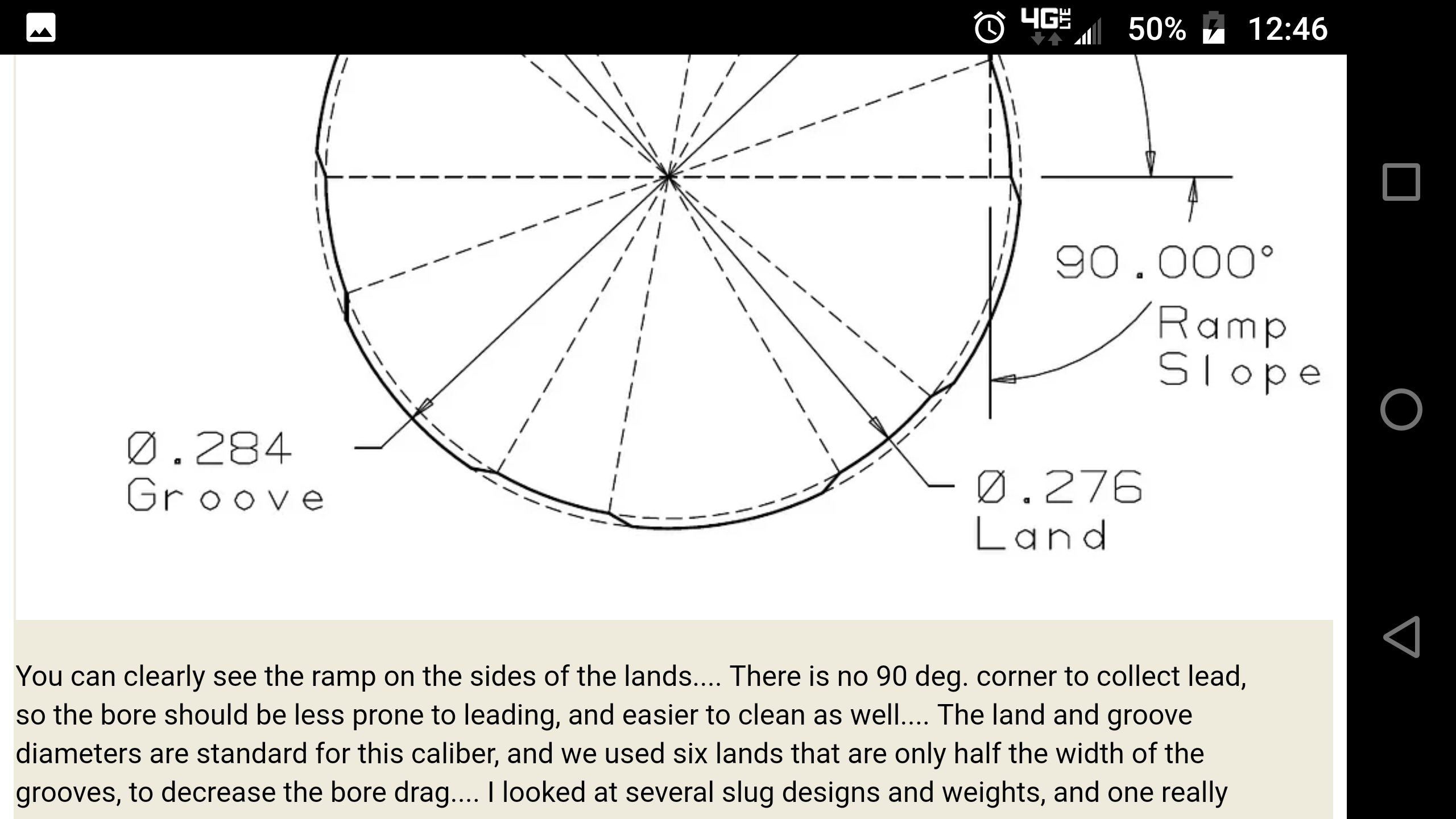

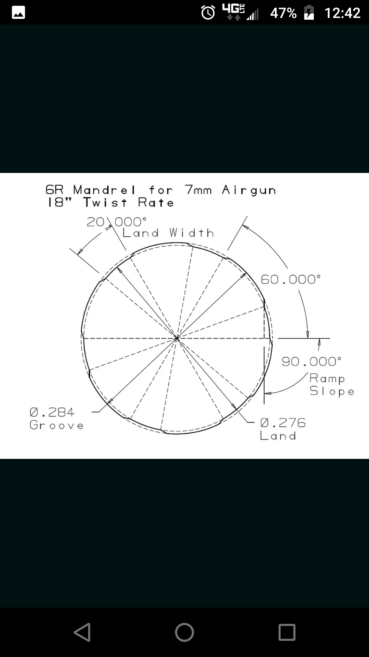

Bill, if making a mandrel for .216 airgun and slug use (small i.d. for polishing to size), here's an image and link to a proven land and groove design that prevents leading, brought to us by valued AGN and Gateway member Bob @rsterne. As the images and link shows, the mandrel was made for 7mm projects, hammered by TJ's as well.
Where does the above graph show optimal velocity for rate of twist? At the vertical spike around 1100 fps?
The graph does not show “optimal velocity” for rate of twist.
The left side vertical axis of the graph indicates the twist rate needed by that slug to have a stability factor of 1.5, vs velocity.
At slower twist rates (above the curve), the stability factor will be lower than 1.5. At faster twist rates (below the curve), the stability factor will be higher than 1.5.
Optimal velocity is up to you to decide. i.e. acceptable accuracy, fpe, drop, drift, at the distances that you plan on shooting.
