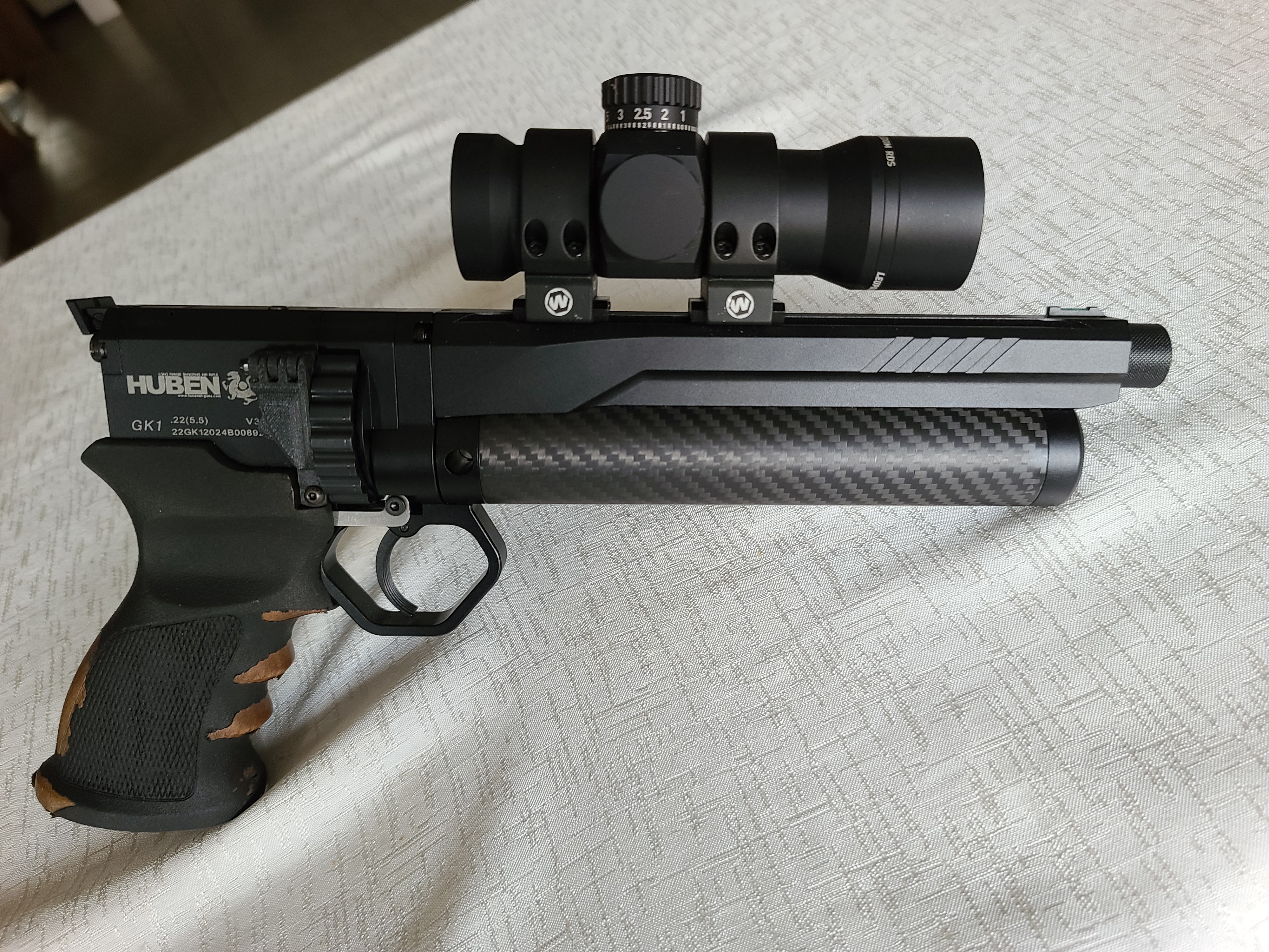

A per request of the OP:
I would like to report another issue or problem with the Huben GK1:
As a scope buying airgunner I am a magnification addict.
With the clinical tests to prove it.
(Just within a few months I purchased not one, not two, but three optics with 30x and more magnification.)
The Huben GK1 is now causing an issue with that addiction. 😳
I explain:
One of the shooting scenarios where the GK1 shines are close range shots that require fast target acquisition (as the quarry is likely not to sit still for more than a couple of seconds).
● Why the GK1:
➧ because it is so light — quick to bring on target
➧ because it is semi-auto — so I can keep firing at that pesky pest in case I missed the first shot
➧ because it does not require to be squeezed for all 60FPE it can produce — I shoot it at 12FPE. With a Sumo, it doesn't go "blam" — it goes "click".
Here is where the GK1 really is causing an issue for me:
The best optic for the above shooting scenario is a dot sight (reflex dot sight, holographic dot sight, or prismatic dot sight).
But those optics typically have NO MAGNIFICATION AT ALL!!! 😱
➠ You can imagine, this wreaks havoc for a magnification addict like me!
After using a prism dot sight for a few weeks, my addiction won out. Off came the dot sight, on came a 5-20x — aaaaaah, feels so good, the rush of magnification cursing through my blood stream!!! 😃
But today.... — I liberated myself from the magnification urge, and put the dot sight back on. 💪🏼
➠ I had great fun with those quick short range shots! 😃
Matthias

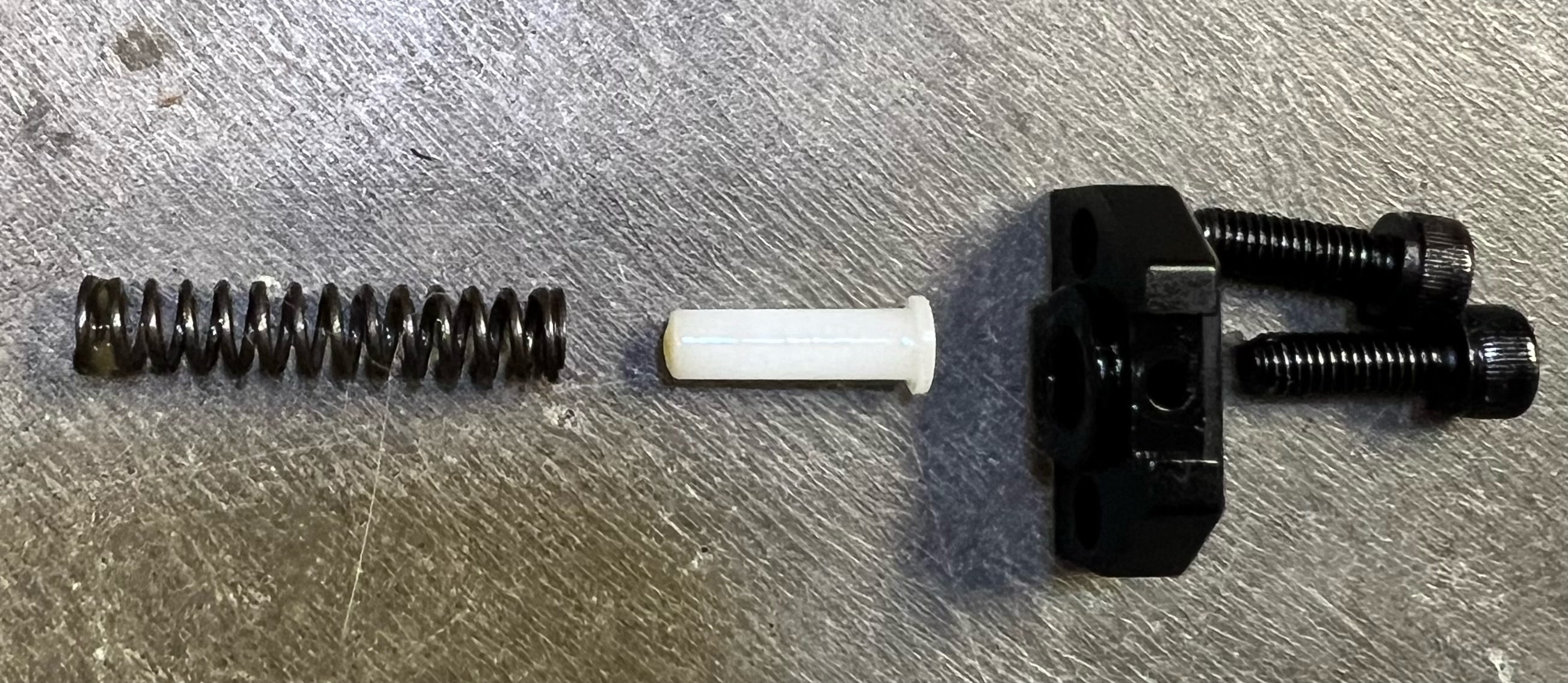

As much as I love the gk1, it really shouldn’t be labeled as a 350 bar gun in its current form. I said this when we first got our pistols and some guys springs were deforming or breaking. User error? No. 350 bar driving the striker back into a spring that was made for much lower pressure is the error. The spring did not get beefed up for the non regulated gk1, it’s the same spring that’s in the regulated k1. However, I don’t hear that problem happening anymore so maybe they used a stronger spring for the new versions; and the guys who experienced broken springs probably aren’t filling to 350 bar anymore. I don’t fill mine passed 270 bar and I’m still using the original spring with no issues. To be honest, I’m scared to fill it to 350 bar. Considering most non regulated gun will only be filled to 250 bar and most regulated guns are subjecting the internals to less than 200 bar. I don’t fear the pistol exploding rather the sear failing (that holds back the striker which prevents the gun from discharging).
I agree with pale Rider. I think 350 bar is abuse. Yes, it can handle that for a while, but it is not necessary. I now have thousands of rounds through both of my GK1s without any issues. I fill to 300 bar and recharge after every magazine. I set my power to 720 fps and after each mag, the gun pressure will be 210 bar. With those settings, I get very consistent speed for all 17 shots.
Reactions: Pale_Rider
I've been shooting from 350 bar since I got it. Thousands of rounds, not even a hiccup. I'll have to open it up and take a look at the spring one of these days and see if there's any sign of wear.
First, I think you are very fortunate that you have not experienced issues. You are stressing the pistol to its factory stated max. At the same time, it proves just how solid the gun really is. Like all air guns, the GK1 should be tuned for its optimum performance i.e. highest consistent velocity with the least amount of HPA consumed. That tune usually never occurs at max rated pressure.
Reactions: MrP
I'm one of the people who has had springs bend while shooting 46-50 grain .254 slugs at 80 FPE ( at least for the first few shots) after bending a few and lube not helping, I reduced the power to 52 FPE but I think my current spring might still be bent. At the current tune I am getting very consistent speeds for all 17 shots and have 20ish mpa left after a 5000 psi fill. As for whether it's the fill pressure or high power tunes that's bad for the springs, I do not know. Since huben advertised them as 40 joule if I recall, I can see the arguement to be made that by making them do 80 FPE we are exceeding the design parameters but I reject the notion that filling to 5000 psi does. If the same components designed for lower pressures are used, then huben should have advertised it as having a lower fill pressure, or at least what pressure is best for the components. In any case, it would be cool to have it capable of standing up to 80 FPE tunes.
Texted Kelly today to see if there's news of a new spring, huben has released one. Gonna get a few and see how they hold up. Came to check this thread to see if anyone else has already got their hands on one, surprised to not see it mentioned yet. Once i get mine I will test it and see how it holds up. Previously the springs bent on me at high tunes after as few as 300 shots so i figure I'll try to get 600 out of it, then remove the spring to see how it has held up. I'll share results when I can although i am currently a busy guy with my normal job
