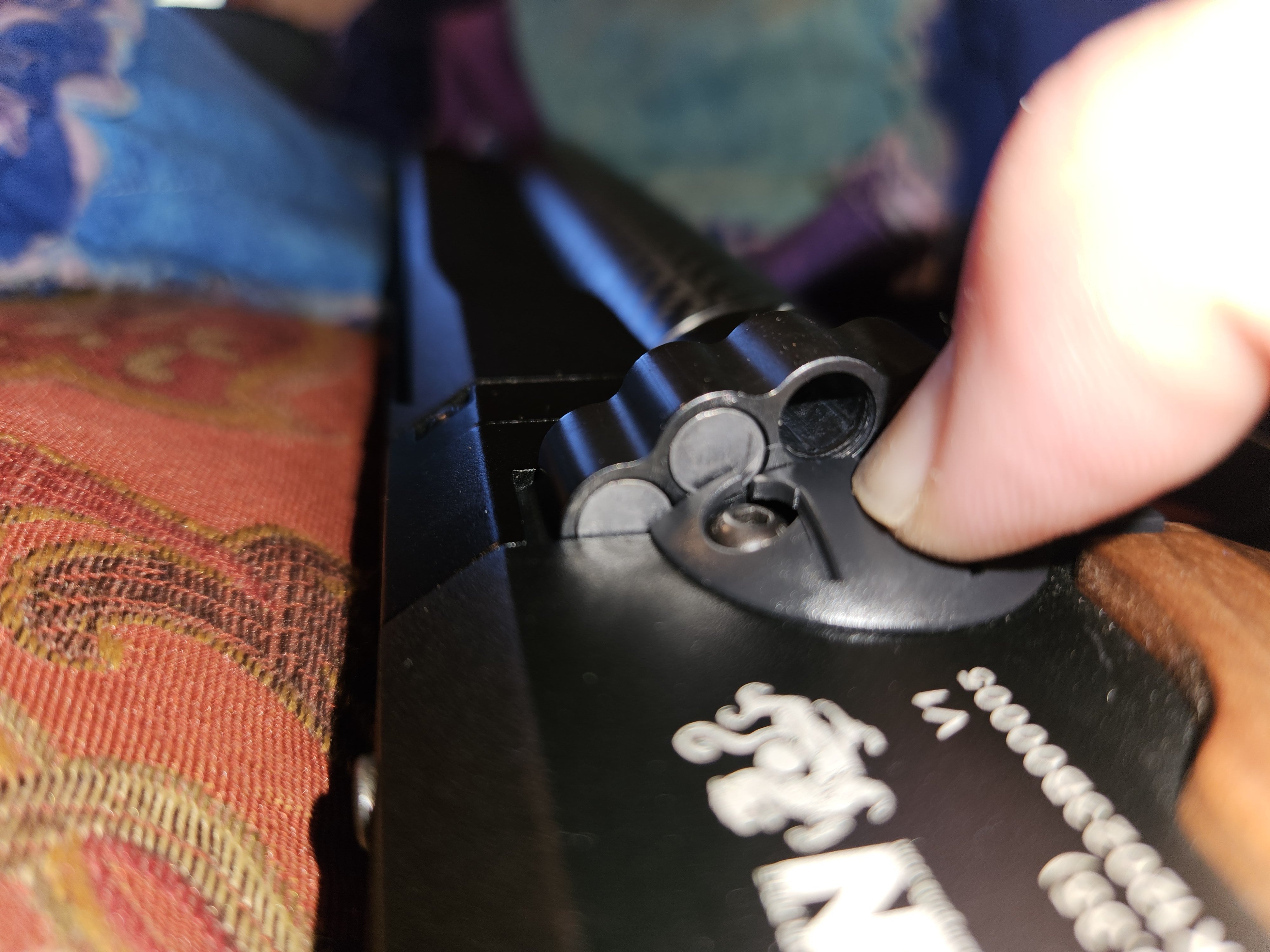

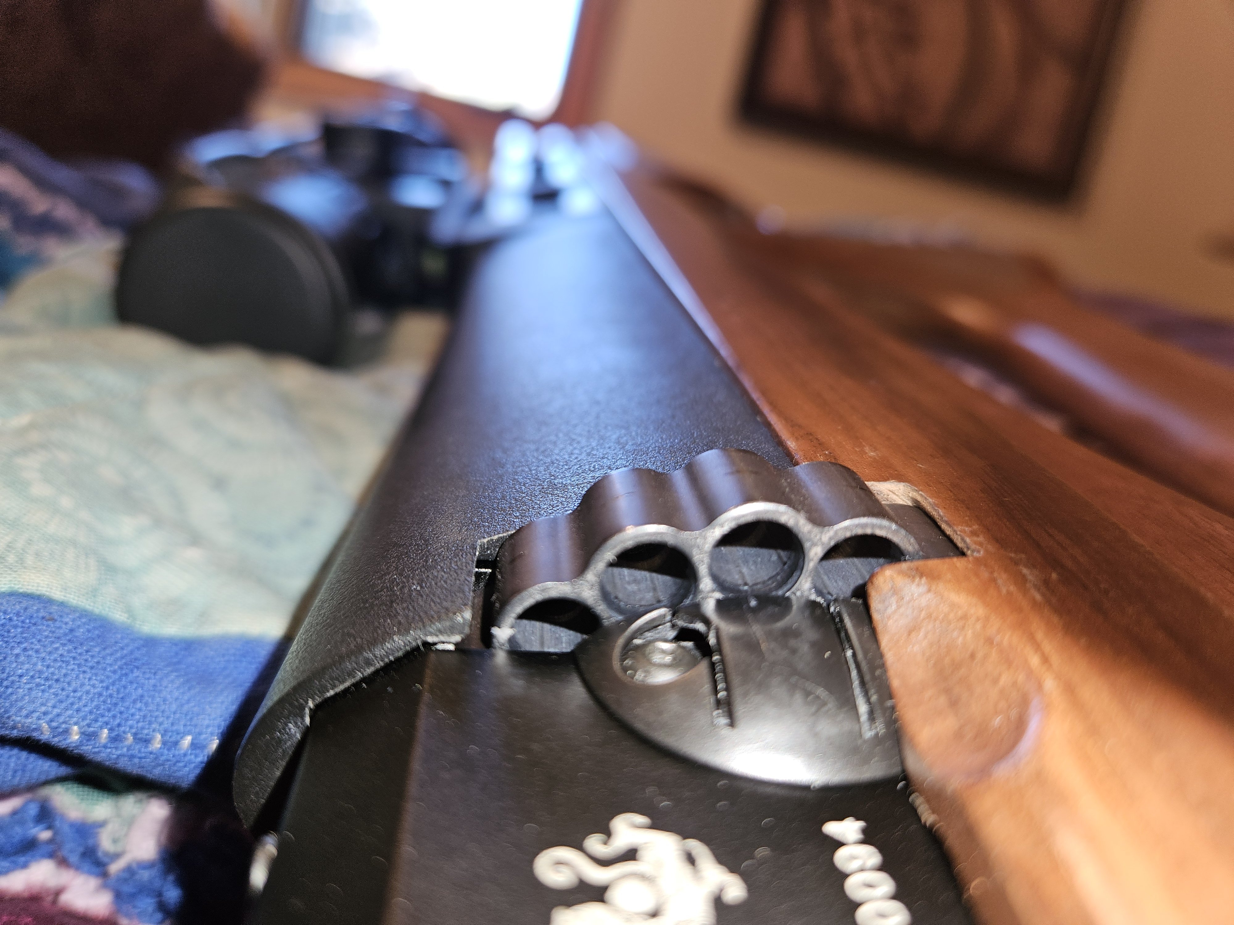

Anyway, here's a Pic of the k1 (mine is a 2021 model so can be certain there aren't minor differences with other years, they do alter these as time goes on) and my gk1 in .25, I have the 5th one made

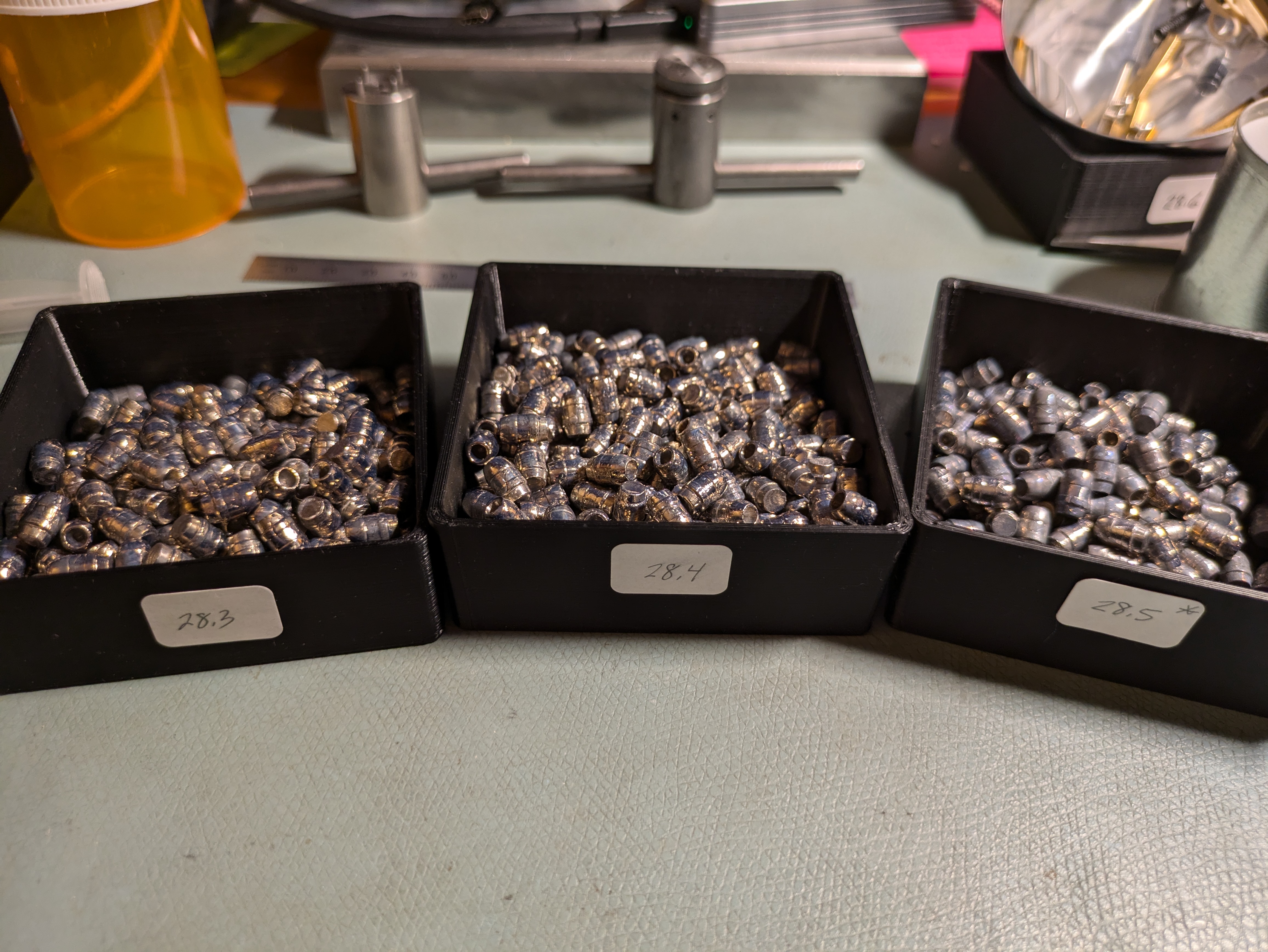

I shoot NOE BBT 0.22 cal 28gr hollow point slugs that I cast. They are cheaper for me to cast than to buy pellets. Of course, I'm not counting my time. Fortunately they work well with my GK1. Yours may differ, so you need to slug it to see what size to use, and perhaps what style. (Drive bands.)
Find casting to be enjoyable. The outlay is not too great for casting gear, and it makes for a pleasant afternoon of casting, and anticipation of shooting my GK1. A leisurely afternoon will get me about 500 or so within 28.4 grains plus or minus 0.1 grains. I also cast 17gr wad cutters. Comparatively speaking, the slugs are a whole lot easier to cast, as the slug yields are far greater than for the flyweight wad cutters. It's hard to keep the mold hot for the smaller weight pellets. All the rejects go back in the pot. If I shoot into my rubber mulch trap, the recovered cast projectiles can all be recycled.

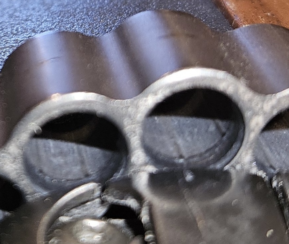

Please note Asher's photos, there are no rifling grooves to retain slugs in the K1's magazine. The method for pellet retention in the mag is the light chamfer in the rear of the mags bores. This chamfer capturers the pellet skirt, which is always slightly larger in diameter than the pellet head. Get your caliper out and measure this fact yourself if you don't believe me. Slugs have no skirt and without this slightly oversize skirt there is no way to retain the slug except for bore resistance. The rub here is it is very difficult to get the correct slug diameter that provides just the right amount of resistance to prevent the slug slipping forward and jamming the gun. So for sb327, Asher, and WobblyHand, these guns are not designed for slugs without skirts and I know of no slugs that have a skirt.
There are rifling grooves in both. I can see it in both pics, I'm sorry if you can't. My previous phone had a macro camera, this one does not. In both of them, I have found .254 slugs to work best, and they're both sufficiently snug as to not slip. When jams occur with the slug between the barrel and mag, it's almost always a spring issue, and that goes for both the k1 and gk1
Not sure what your problem is but the magazines do in fact have lands in them. I can see them in the picture. Of course they are subtle because they are designed to hold a projectile with the least amount of deformation to the lead.

Below is from the picture posted above, I magnified the mag and screen shot it.
