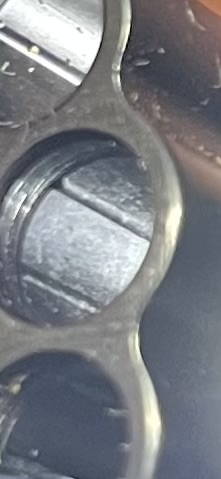

Not lead striationsWhat you folks are referring to are Striations, not rifling. They are caused by lead smearing through friction. Those bores in the mag are smooth. The mags are the same in both the GK1 and K1. Although I have only GK1s in .25, I can assure you the mag bores are exactly .250 in diameter checked with a precision set of pin gauges, which I own. To prove my point, remove your mags with these striations and clean their bores with Hoppes number 9 and a bronze bore brush and see for yourself.
My apologies, both my V1 and my V3 have those grooves. I missed them. I did however recheck the bore size in both my 25 cal. V1 and V3 magazines. The sizes are the same .250 go .251 very tight almost no go.. My barrel land diameter is .247 go .248 no go. These sizes are the same as I reported earlier in other threads here on this forum. Those grooves are NOT rifling, just grooves.Not lead striations

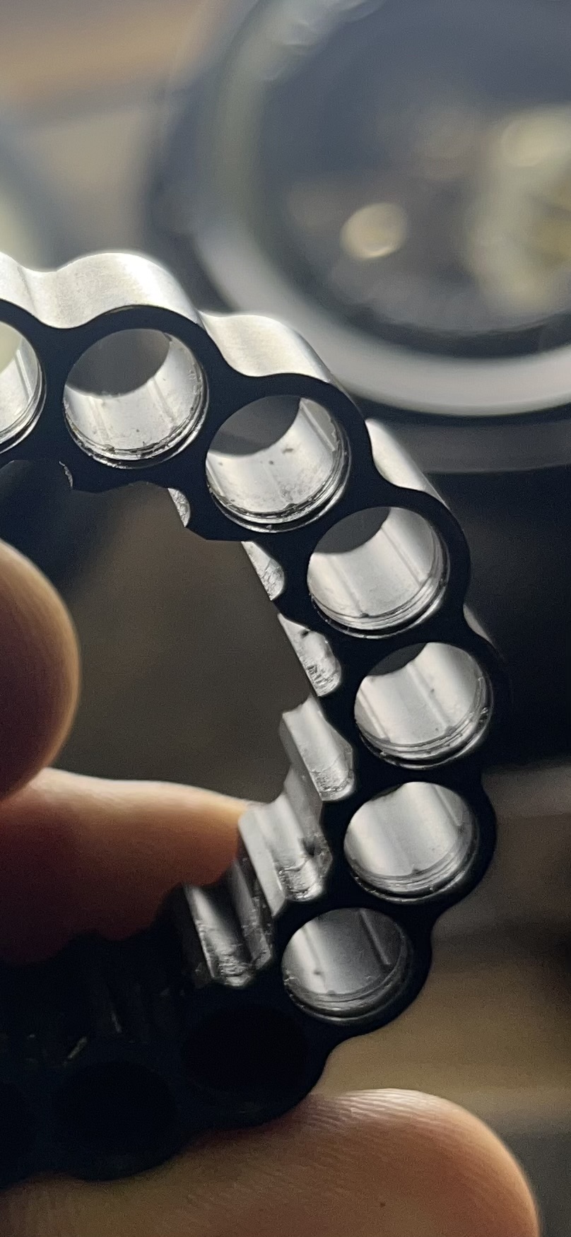

This is a 25cal mag I pulled from my gk when I switched it to 22.

View attachment 497278View attachment 497279
You are correct, they are not rifling. I said they are rifling LIKE lands in one of my previous posts on the subject.The rifling like lands in the mag hold the slug.
I have posted in other threads on the forum a way of ‘knurling’ common slugs that works perfectly for the huben mags and transition to barrel (forcing cone). And are easy to load.

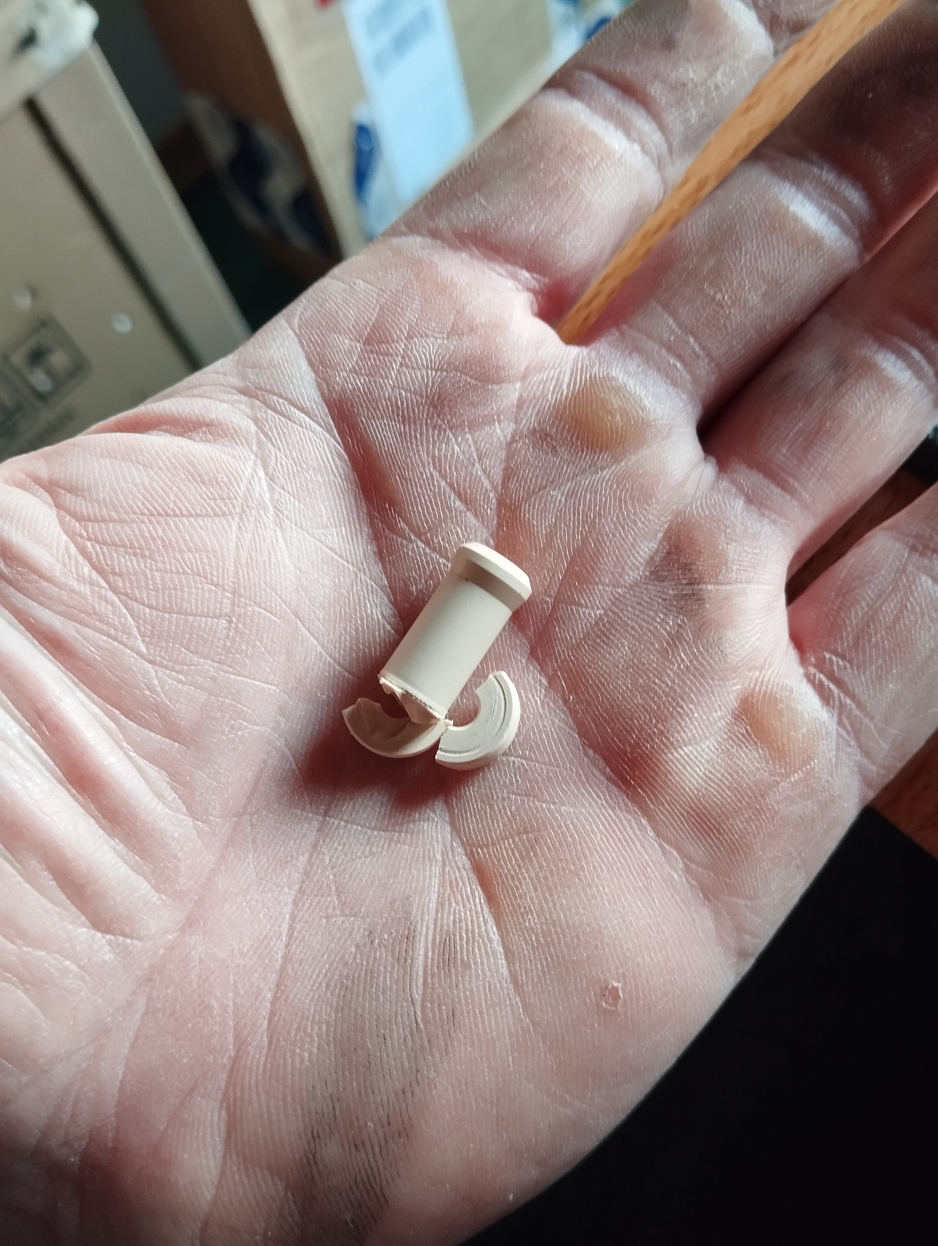

Interesting part. Doesn't seem that complicated, but perhaps I'm over simplifying it, and shouldn't. Does something go through the bore? Ah, part 21, the close valve spring stem goes in part way. Looks like a simple lathe project, and a small sized one at that. If I have to deal with that, maybe I'd make one out of aluminum. Seems like that plastic piece is marginal for it's load - even if by a rookie.The springs are good. Maybe a rookie mistake. Here's my thought of why this happened. When you remove the trigger guard make sure that you only put it back on when the system is depressurized or screw the adjustment screw all the way out to prevent any force on the on the closing valve. Perhaps that lead to damaging/weakening the valve. It's an quite expensive part. Costs 30 Euros
Removing the trigger guard should have no effect on the closing valve. I’m sure you are aware but it is contained via the adjustment stem housing (brass) and that part doesn’t get disturbed by just removing the trigger guard.The springs are good. Maybe a rookie mistake. Here's my thought of why this happened. When you remove the trigger guard make sure that you only put it back on when the system is depressurized or screw the adjustment screw all the way out to prevent any force on the on the closing valve. Perhaps that lead to damaging/weakening the valve. It's a quite expensive part. Costs 30 Euros
