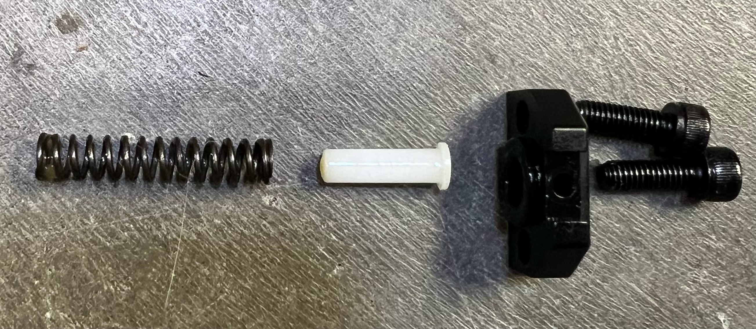

So I torture tested my gk1 with the new spring setup. Lots of rapid firing at high power levels. The spring held up great, however the rubber ring part around it got chewed up like has not happened before. Wondering if using a very sharp knife to cut a small bevel on the inside edge on each side might help
New spring setup?
New spring setup?
New for mine anyway, I would imagine current ones come that way?
I mentioned it a few pages back, but here's the pic again
Reactions: MrP
