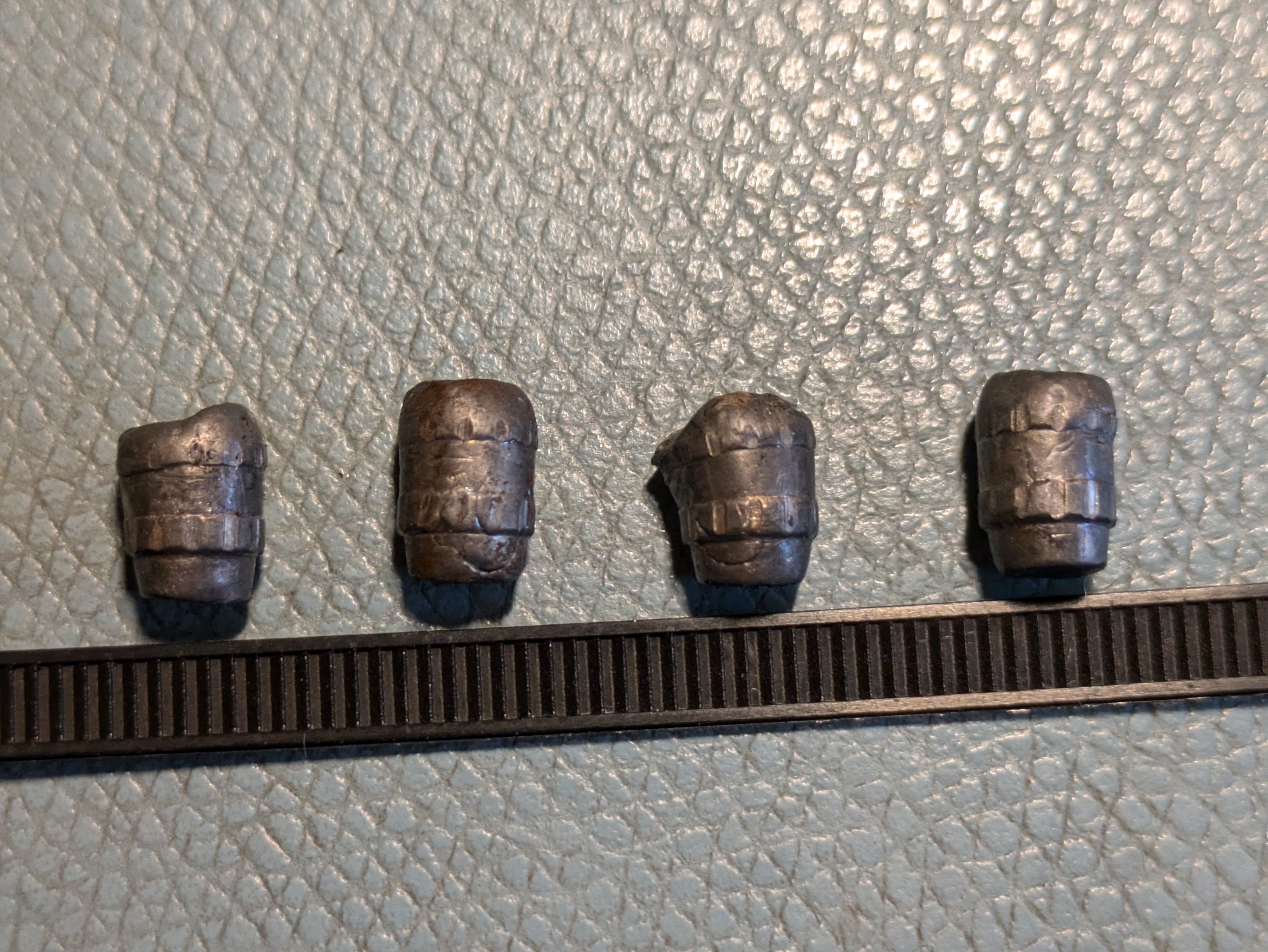

I do know that my GK1 bore is larger than my PP700SA bore. I can barely chamber the above slug in my PP700, it takes a slug starter. Whereas on my GK1 the slug goes in much, much easier. The PP mics at 218, and the GK1 around 0.220. At least this is what I can tell from recovered slugs from a mulch trap. The GK1 shot at 36 FPE, no idea for the PP700, undoubtedly a lot less. Yeah, these slugs are poorly cast, they came from my first round of casting on this mold. Dug them out from my trap a couple days ago.
