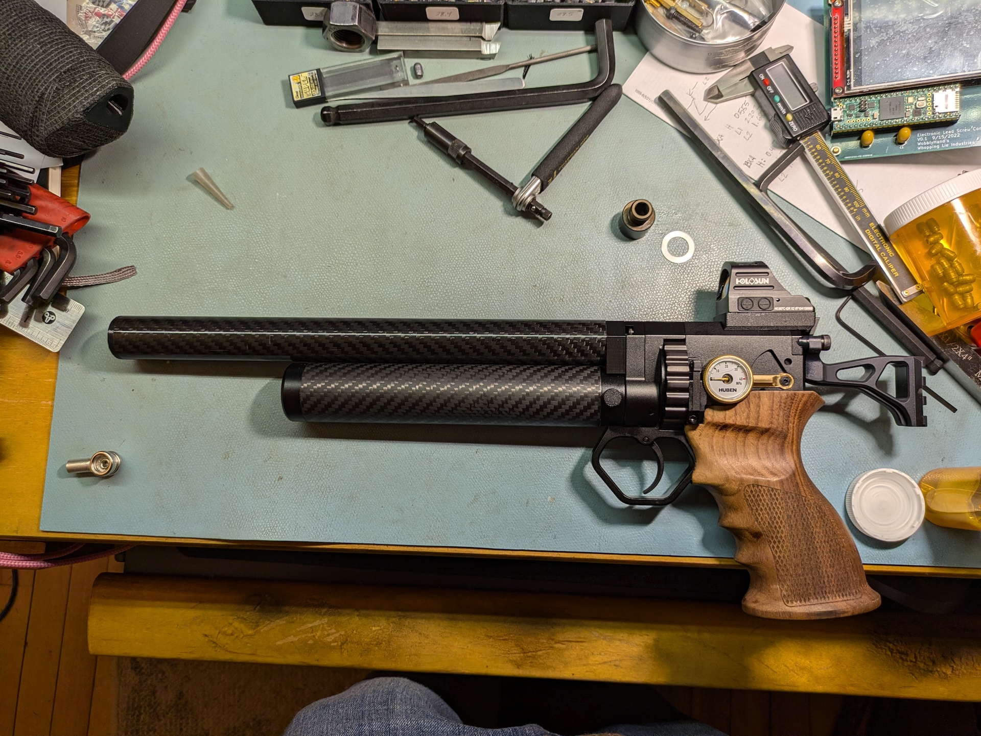

Never mind, found one of Kelly's videos - in the comment section, he mentioned about pulling the trigger AND then resetting the striker. All is good now. CF shroud replacing stock non functional shroud. Works pretty well, pretty quiet, well worth doing! Took me two days to do. A day for printing and a day to fit things and to cut the CF tube to size.

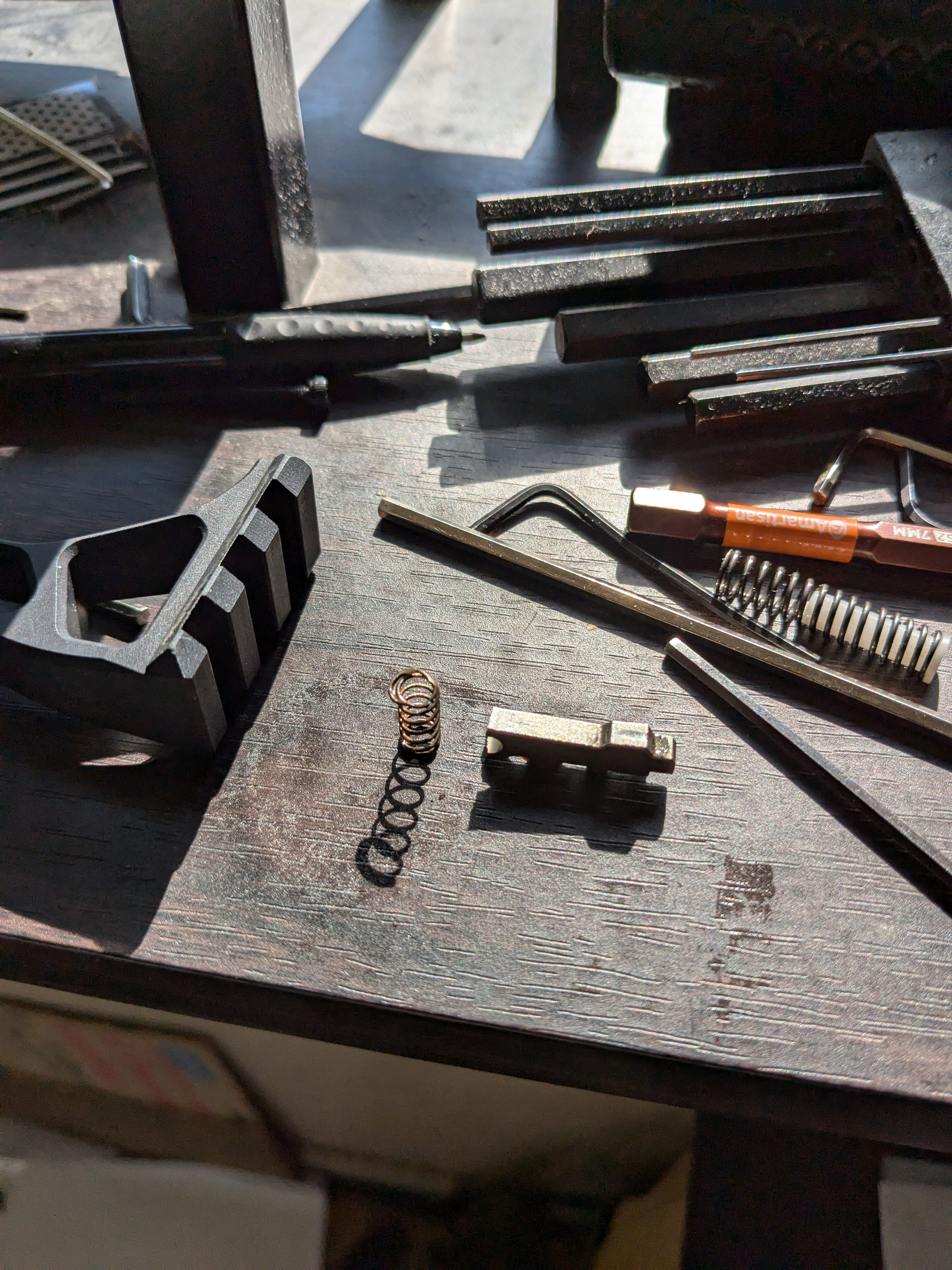

Mangled up the sear spring!View attachment 514348

After shooting 19 rounds successfully yesterday, (after resetting the striker) I took a shot today (dry fire) and I'm back to an air dump. Beats me why I've getting these dumps right now. Maybe something got damaged. Not sure why, everything was fine before degassing.
After getting annoyed at the sight interfering with disassembly, I removed the 1mm pin. Used a common pin to press it out. Both the 1mm pin and the sight are in a GK1 parts bag. Having to resight after these dumps has really annoyed me.

Crossing fingers, reprinted some parts in the shroud, and reassembled it. Reset the striker. Filled with air, to 250 bar, and filled the magazine. At least with 17.6gr Norma's, the sound is subdued indoors. No, not mouse fart quiet, but honestly, pretty good. It will be fine outdoors. A dry fire is quite a bit louder. We'll see how long this keeps up. When airing up, around 100 bar, there's an audible click as something moves inside the action. Not sure what that is, but will have to remember that.
In all the thrashing, I had to unscrew the air tank to access the barrel. I was half expecting a leak upon reassembly. Fortunately it didn't leak. Have to re-chrony this again, have no idea what I set it do, it's about 1/2 turn off the bottom. Kelly had set it to around 900 fps for the Norma's. I had to set it to minimum when degassing (per the recommendations). Hoping there are no more unexpected dumps.
