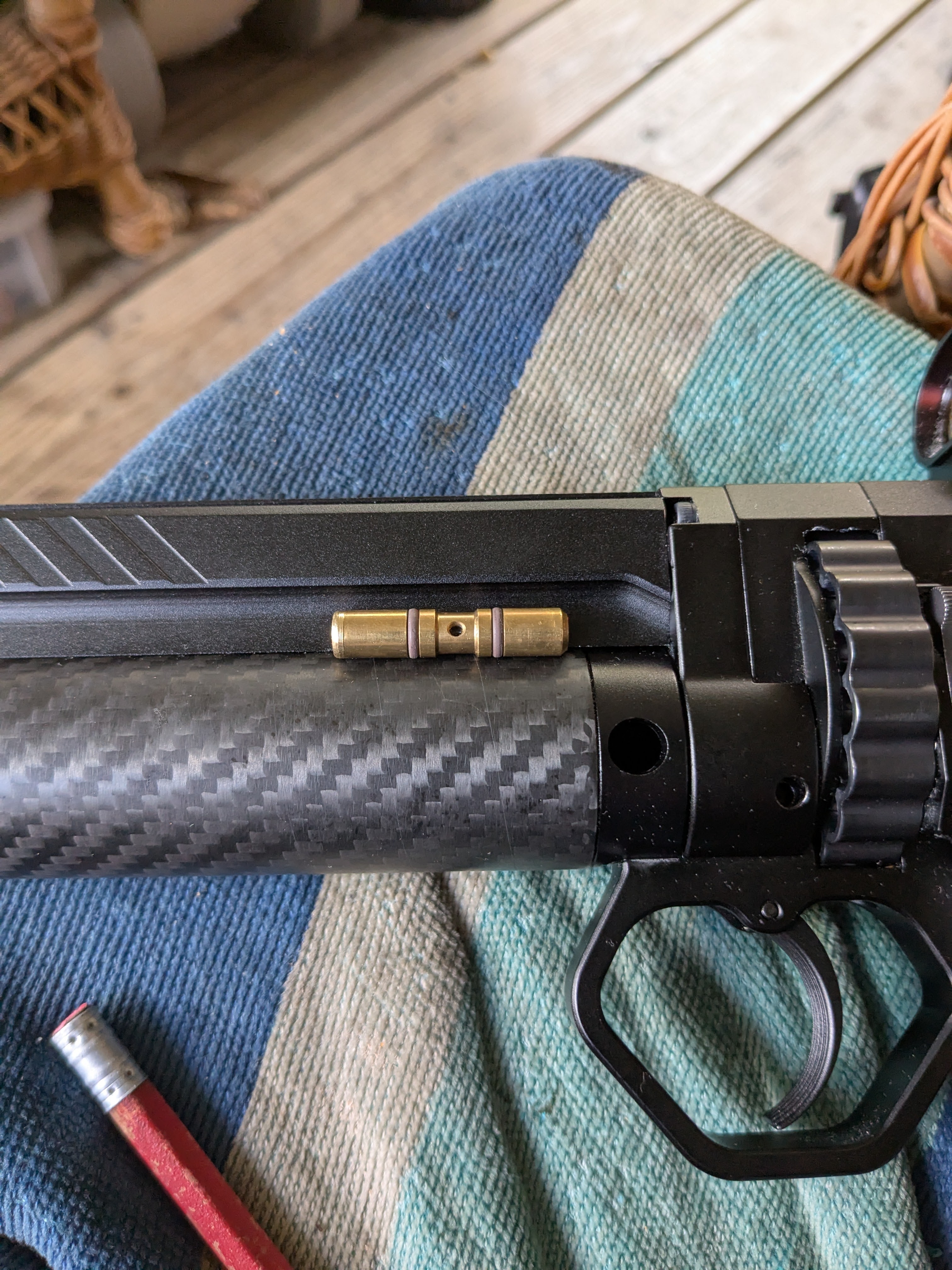

Good idea, I think I have an old fill probe that I can modify.
Pix
oh dang, thats not good! maybe time to figure out a set screw for that?
It is a set screw, with a rubber rod inserted in a hole parallel to it which presses on the threads to sort of keep it in place. It might be possible to make it 2 shallow/filed set screws one on top of the other, but the length of the original screw doesn't lend itself to that very easily.

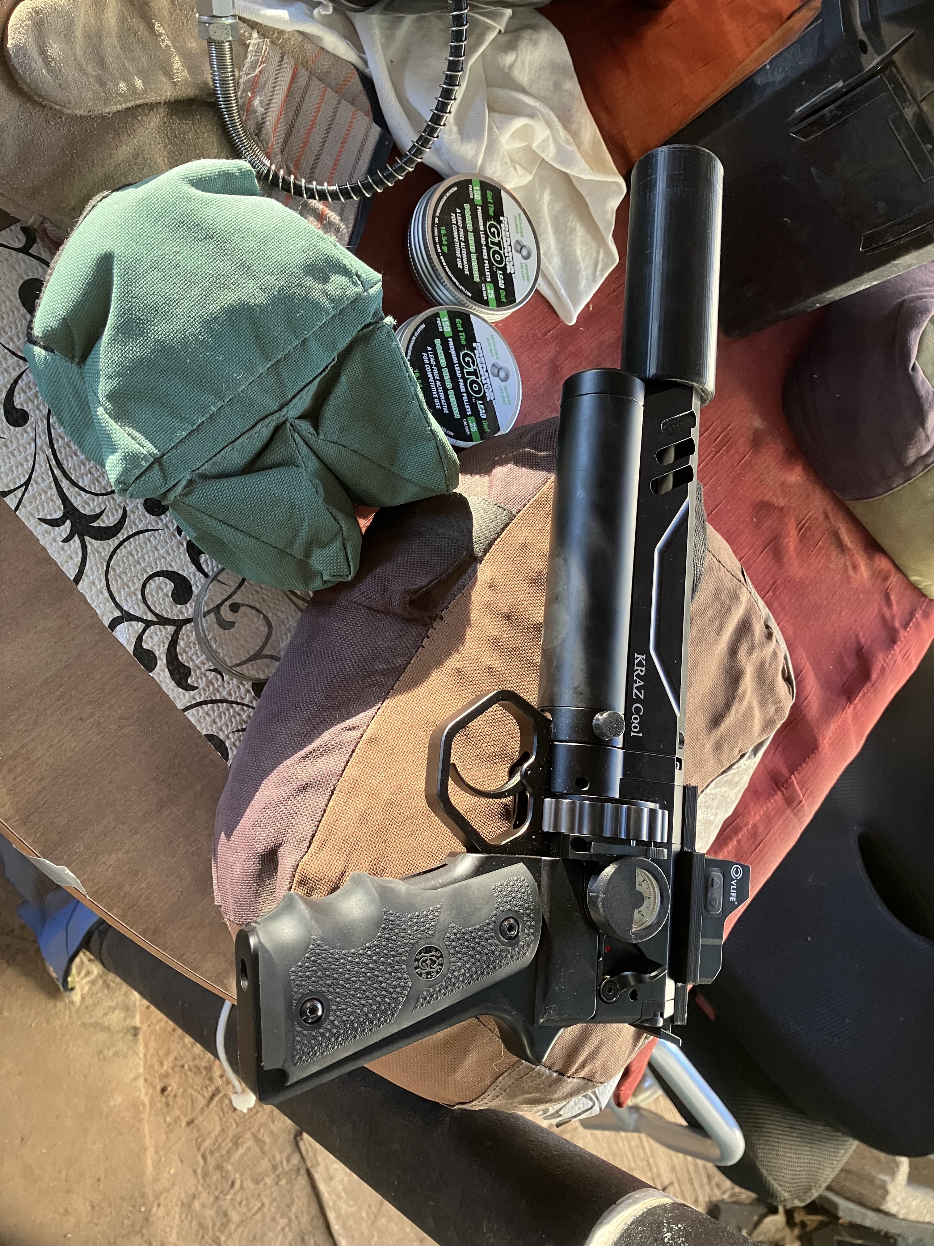

I didn't install the grip had problems with installing the shorty kit I bought from Kelly plus I had knocked the mag stop out of position. Kelly put his magic touch. Ask me if I wanted to try the new grips so I yes it and this is what I got back. Kinda reminds me of my old chrome plated llama .45.
Never noticed the V3.+ No idea lol. It looks to screw on just like the other grips. Pix with my V3 .177 & V1 .22.
Cool looking moderator on the shorty, I got one on my 25 shorty and really like it, Does a good job also.

Cool looking moderator on the shorty, I got one on my 25 shorty and really like it, Does a good job also.View attachment 528612
That is one beautiful looking pistol Mike!
