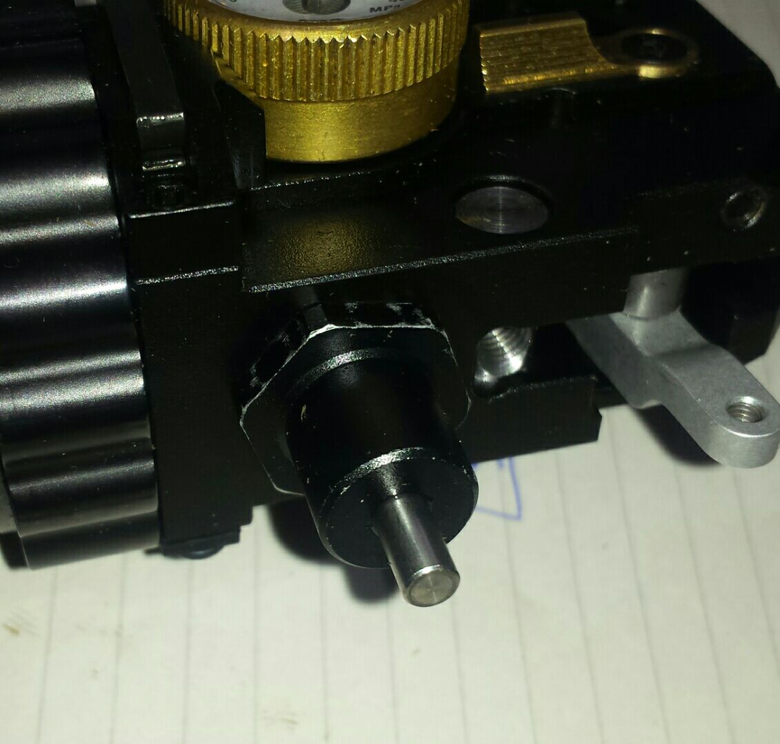

my GK1 also has a slow leak (about 100Bar over night), but i am not sure how to check from where it is leaking. i have tried some silicone spray on the check valve screw and around the power adjuster, but i can't see any bubbles so far. i wonder what are the other places and ways to check them? before i dismantle it further (for which i will have to degas it). thanks for any hints and help.

There's a brass screw under loading gate. Mine was leaking from there. There's also an o-ring below that screw. Granted, I used that screw to degas my GK1 once or twice before it started leaking. So this may not apply to yours. But it can't hurt to check.
checked this as well, and could not see any leak.

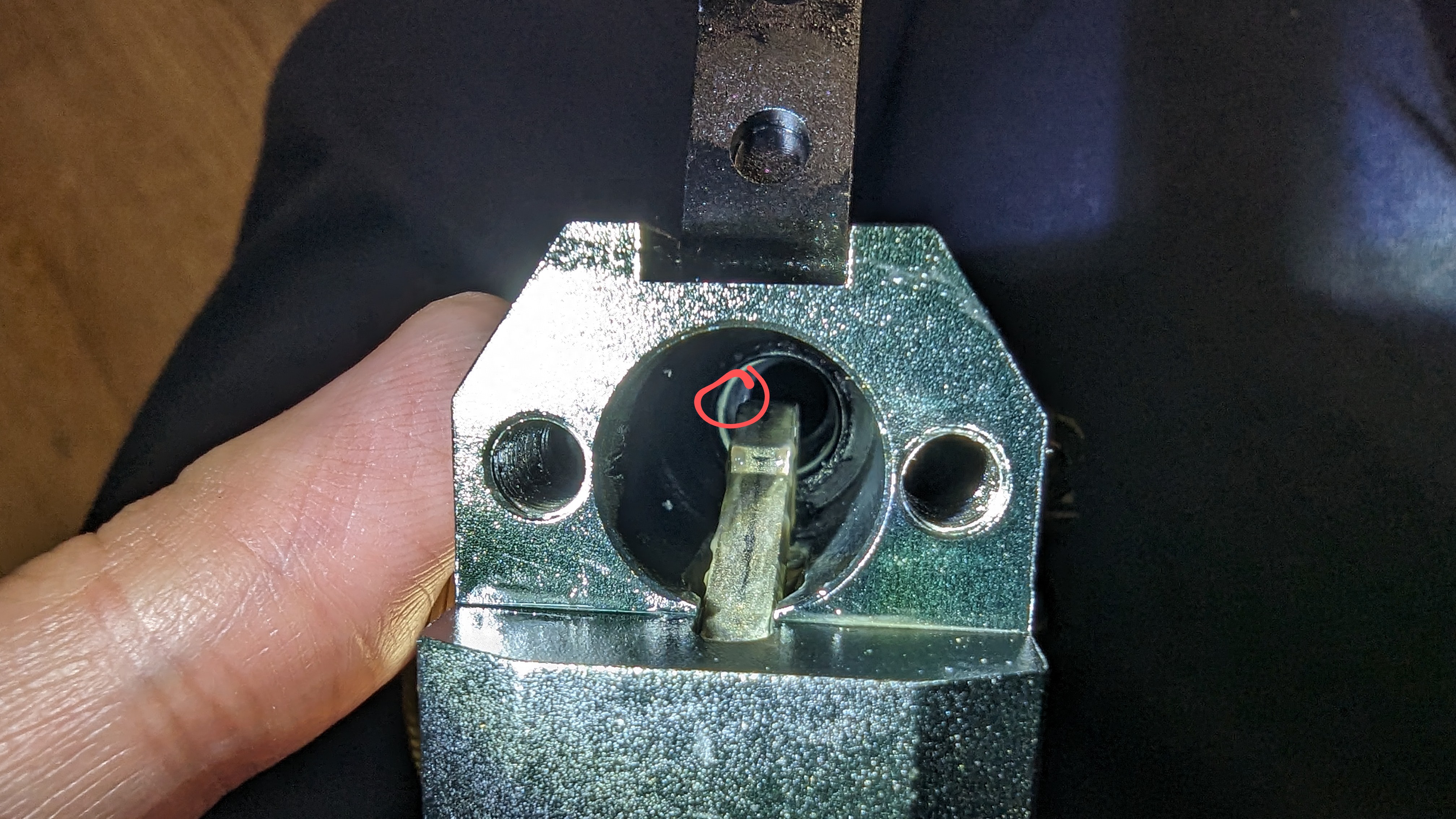

i have found a leak now. it is around the pretty scratched looking (straight from the vendor) closing valve.
i also got a message from the vendor, who said that from 200 guns they sold, 2 have been leaking, they also recommended to watch Gregor K.'s disassembly video to find out more to check or to send it back for them to fix it and i think i will do that, because i think on a new gun no parts should be this scratched and broken out of the box.
can't upload the bubbly clip here, for some reason.
update: while writing, i got a response from the vendor, who will send me a new part with new o-rings for me to try fixing it. if i can't i can send the gun back for repair.

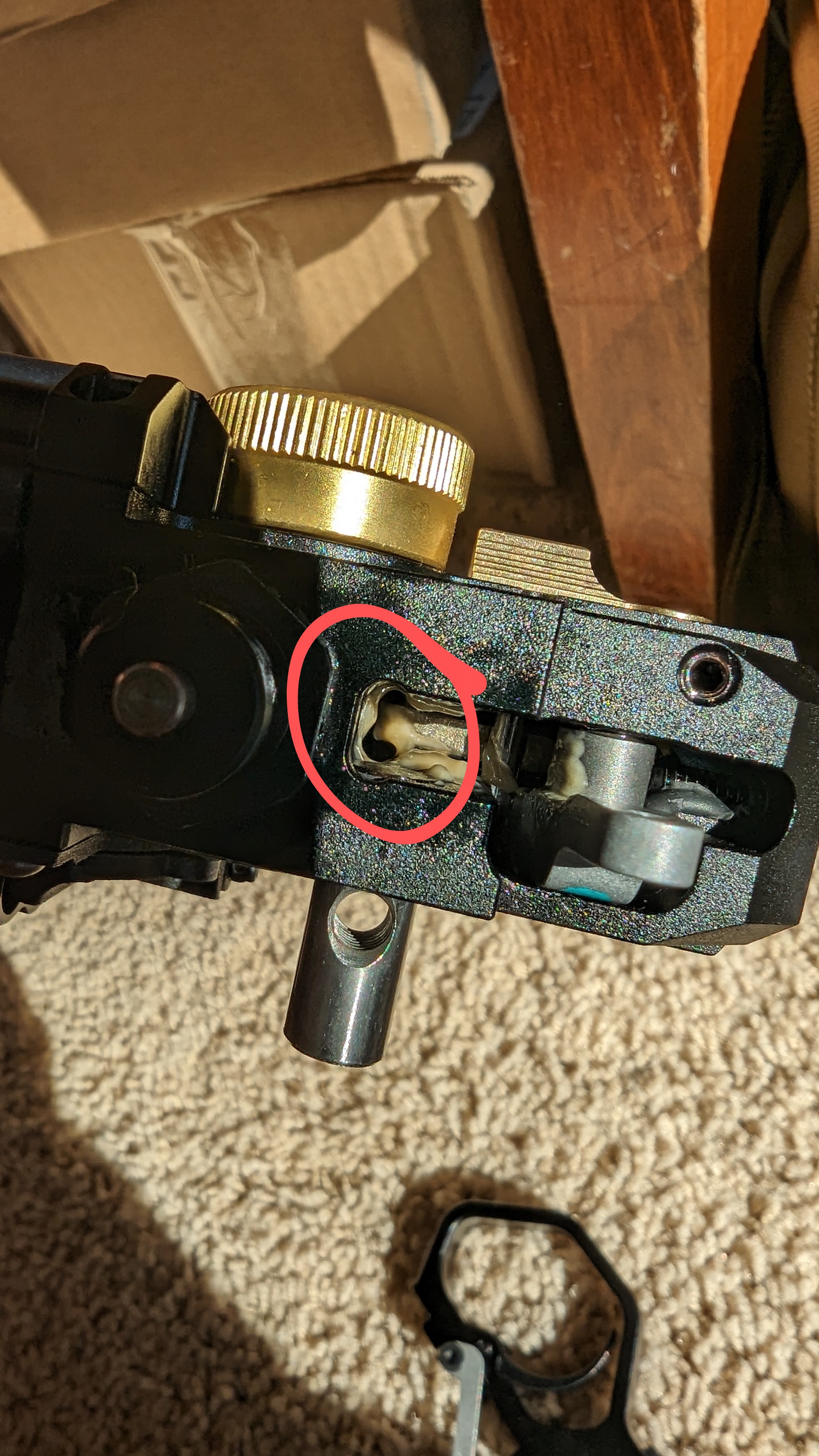

El orificio n.° 4 de mi v3 se rompió. Es difícil verlo en la foto, pero el orificio está defectuoso. Por supuesto, no es un oring que esté incluido en los repuestos y tiene un tamaño realmente extraño. Será divertido volver a pescar/asentarse.
Estoy pensando en empezar a tener estos anillos Huben de tamaño extraño en la tienda.
Las v1 todavía se mantienen fuertes.

¿Cómo te diste cuenta, perdía aire por ahí?.

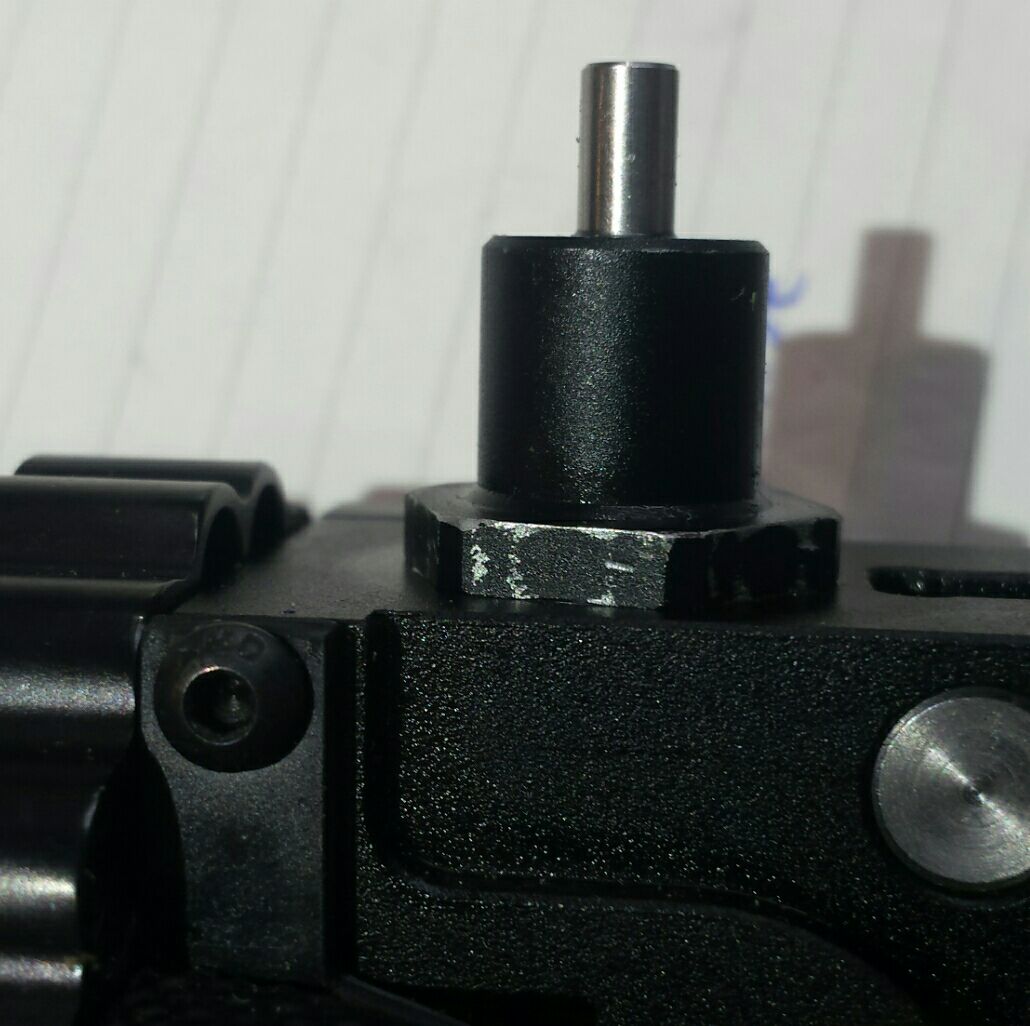

I had a annoying leak that I just fixed. Well 2 leaks. It would drain from 5000 psi but hold air once it got to 4500psi over a couple days. Changed the airguage and it's oring... Couldn't hear the tiny leak anymore but it did the same thing. Finally, I lubed up the air assist pin and oring also the o-ring on the brass screw and tighten it down pretty good. Fixed the leak! The brass screw tightened down puts pressure on the o-ring making it tighten on the pin. This better seal...
View attachment 455461View attachment 455463
That peice looks like it's been fiddled with a bunch. Sucks fixing a brand new gun. For the prices we pay Dealers should just be ship the replacement and pay for the return shipping of the defect one.
