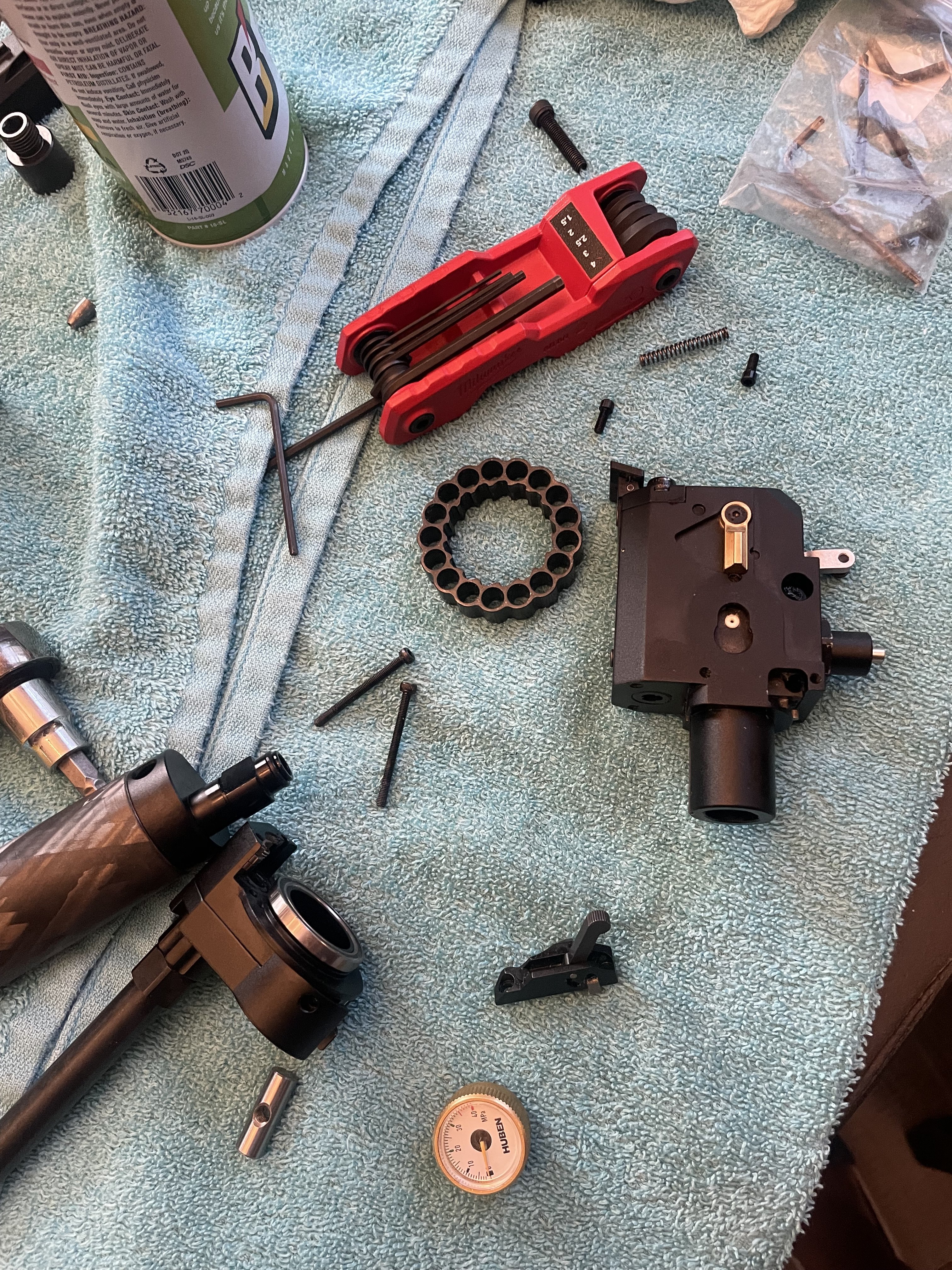

I have a slow leak from my 25 V3 gk1. It will leak from about 32mpa to about 24mpa in approximately 2weeks. I haven’t replaced any seals yet, but I have practice taking the gun partially apart. I just can’t seem to find where the leak is coming from because I don’t hear anything. Can anyone help?

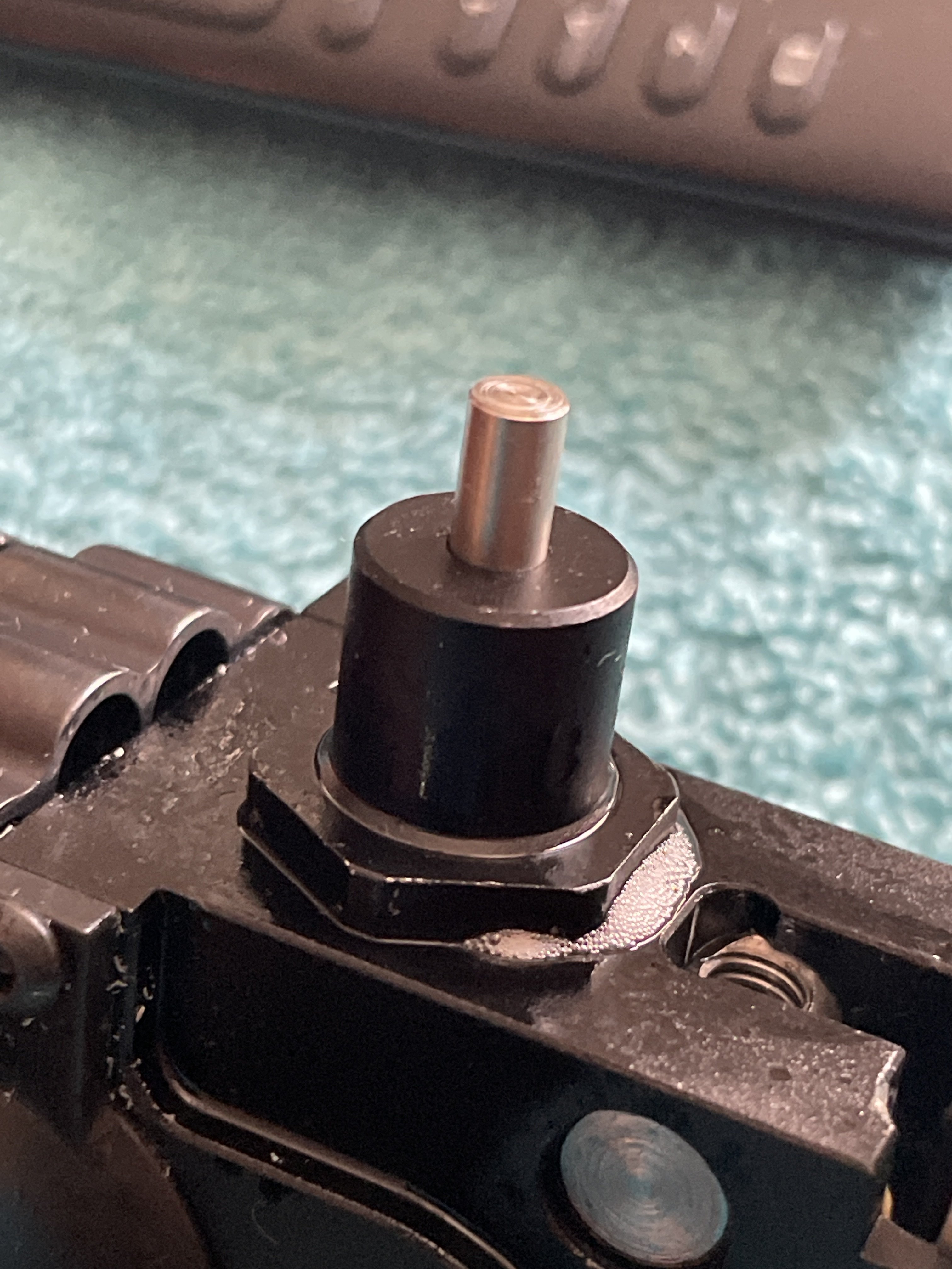

I ended up taking the valve out and inspected the O-ring, which looked to be fine. Inspected the plastic valve. There were no cracks or blemishes iso I cleaned up the threading and applied some thick silicone oil and bolted it back in. Then checked for the leak after refilling the tank and it appeared, problem solved. There’s actually a spare O-ring that comes in the kit number 26 but I didn’t use it yet. crossing my fingers and will check back in in a couple weeks to see if the problem reoccurs

That's great. Is accessing the valve easy to accomplish? I'm looking at that picture - that hexagonal bit unscrews I take it?

Could you point me in direction? I read your description, but I know myself enough. I need a video, or pics. If I disassemble without that, then maybe I will screw up even more. 🫣 😅
You took out the valve. Which valve? Where is that? You have to degas it for this whole process, right?

I think mine has the same problem. -50 bars in a couple of days. :(
I changed the o-ring here...still leaking this pos! 🤬
Same place, same way. But now -40bars in 1/2 day.

Psst! Here is a valuable clue. All air guns will leak sooner or later. "O" rings are a consumable. If you want to shoot these, you better be ready to change them out from time to time.
