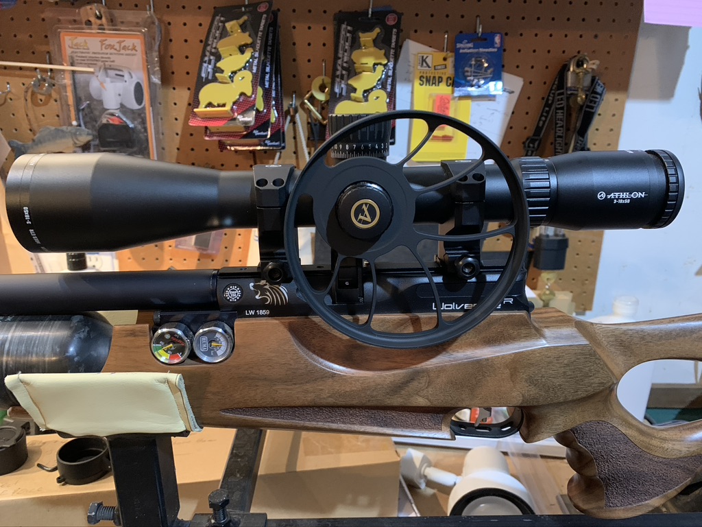

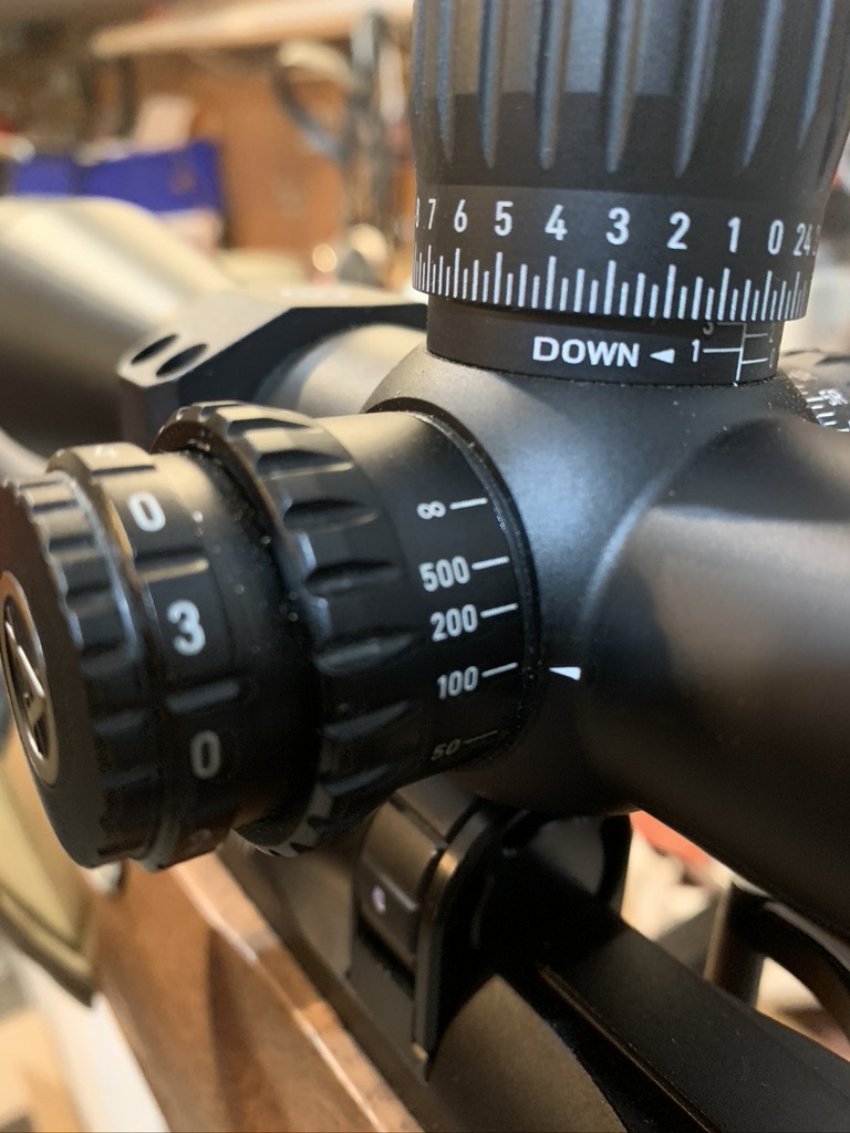

Here is my scope wheel journey thus far. I ordered one of the magnetic wheels from JD It is a good design, I really liked it. But for the Athlon ETR I didn't like the fit. This scope has a very thin flat spot on the focus wheel and I didn't think it would stay on the scope securely the hub is kind wide. I also couldn't use my ilumination wheel. I will include a picture of the scope focus wheel so you can see what I mean about it being narrow with a taper behind the flat spots..
I really wanted a wheel so I called up Eric from scope werks. We took lots of measurements. And he made me one up the set screws are at an angle so that they will grab onto the inward tampered spot pulling the wheel toward the scope body. It also has a piece of aluminum shim to keep the set screw from muring the scope. He did a good job. I installed it but need to mark the yardages this weekend.
