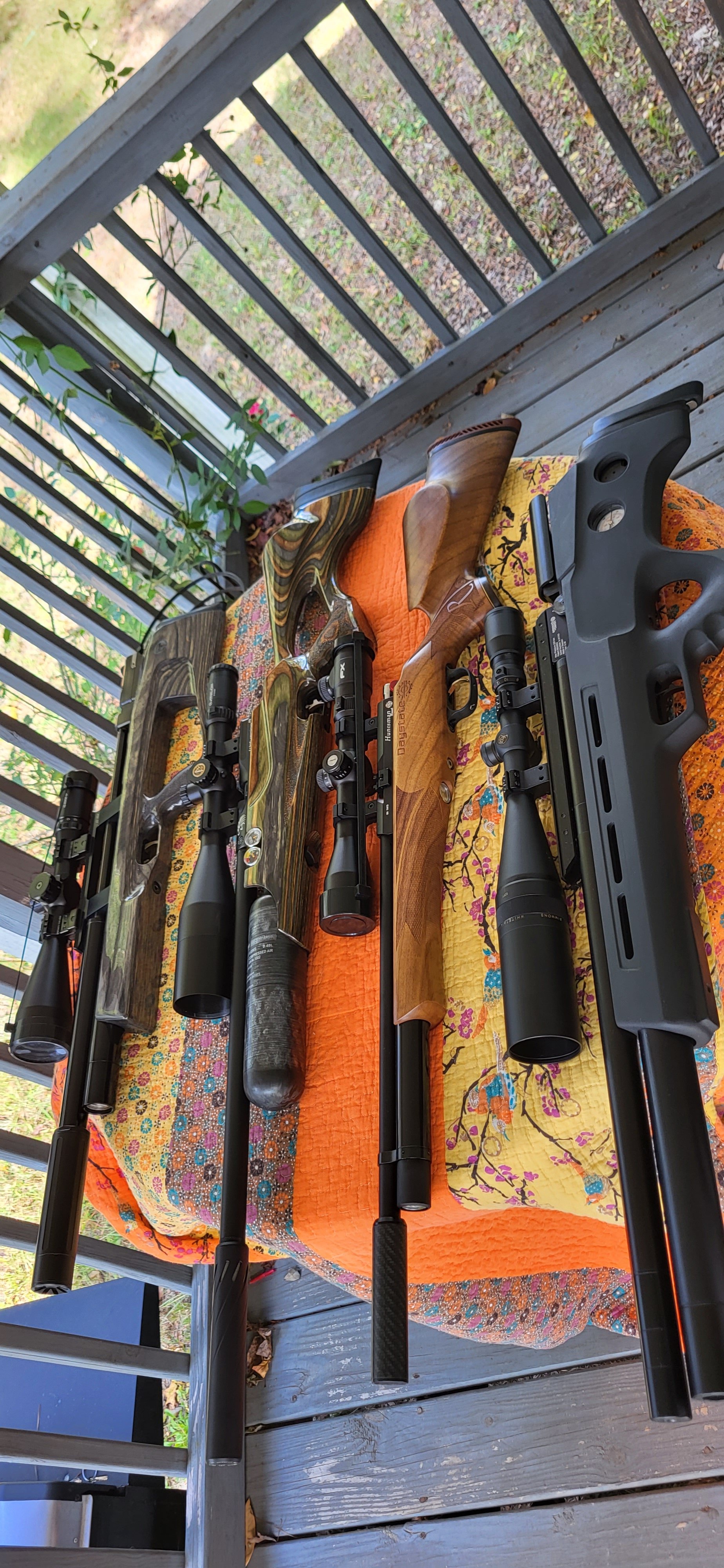

My Limited Edition is an Outstandingly accurate gun shooting the ZAN 33gr and 38gr slugs, 3/8 groups at 50 yards is the norm .. A simple turn of the power wheel and it becomes a powerhouse hunter.
Very comfortable, Ergonomic gun as well.
Top is the .25 Limited Edition
Bottom is a .22
Love both of them

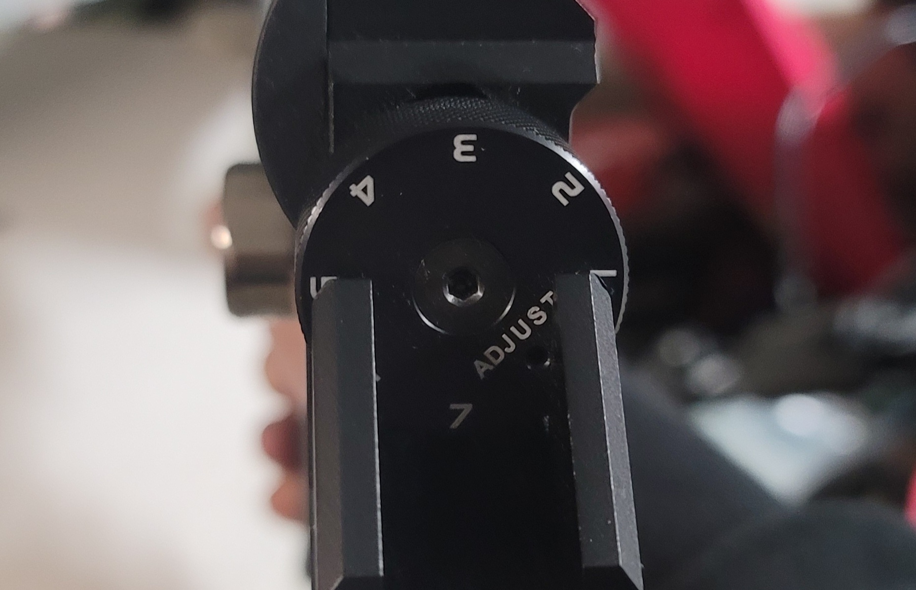

That is where the Maverick shines. With its 7 step power wheel, I can shoot at a constant 930 fps on 7 or down to around 790 fps on power wheel setting 1.
Moving my wheel to any of the 7 setting results in very repeatable velocity adjustments because each number has a detent, unlike some other airguns that don't.

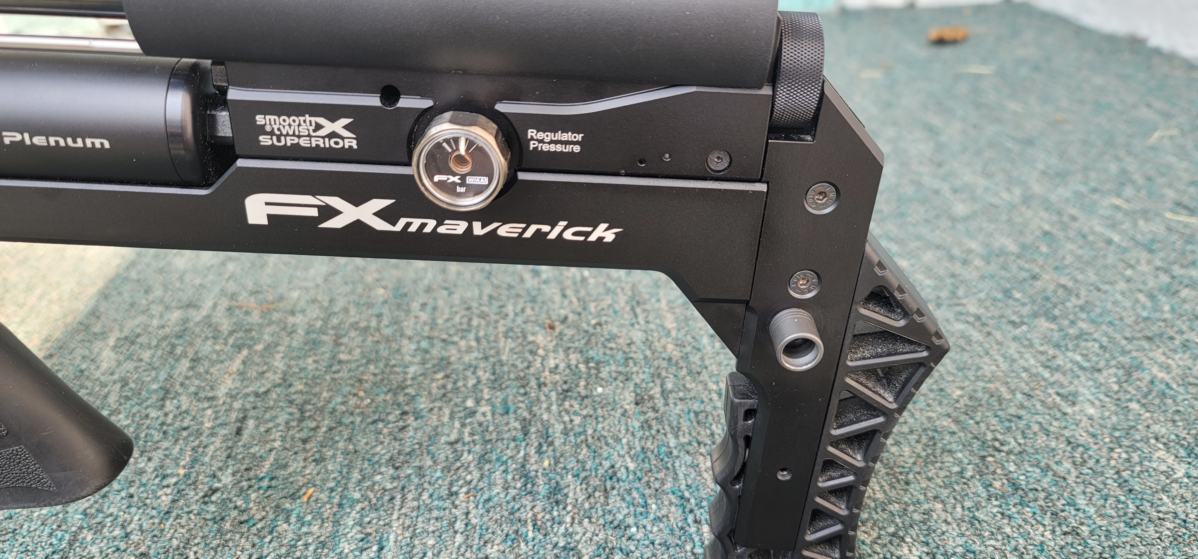

The Maverick and Wildcat are the same gun. They are dual regulated with the same AMP regs, same 89cc Plenum and the power wheel and IHS are the same. I believe the safety may be slightly different but it is located in the same poorly placed position on both guns. The safety position is my only gripe with both models.

They are absolutely identical, save for the Maverick having a 20 MOA scope rail. Barrels, liners, air tanks are completely interchangeable between the Maverick and Wildcat MK3 BT .

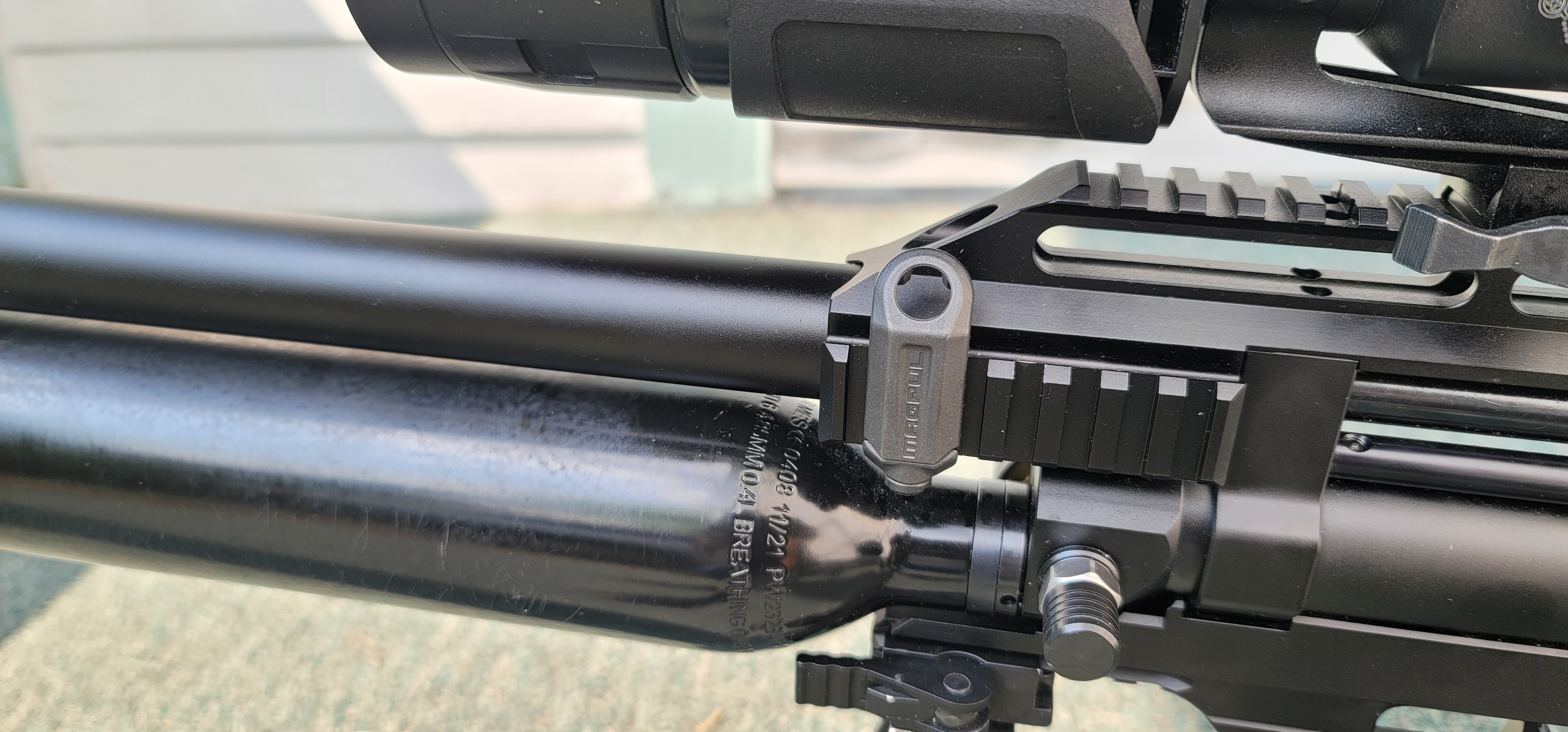

I even did a two point sling modification for my Maverick to make it the perfect woods walker.
