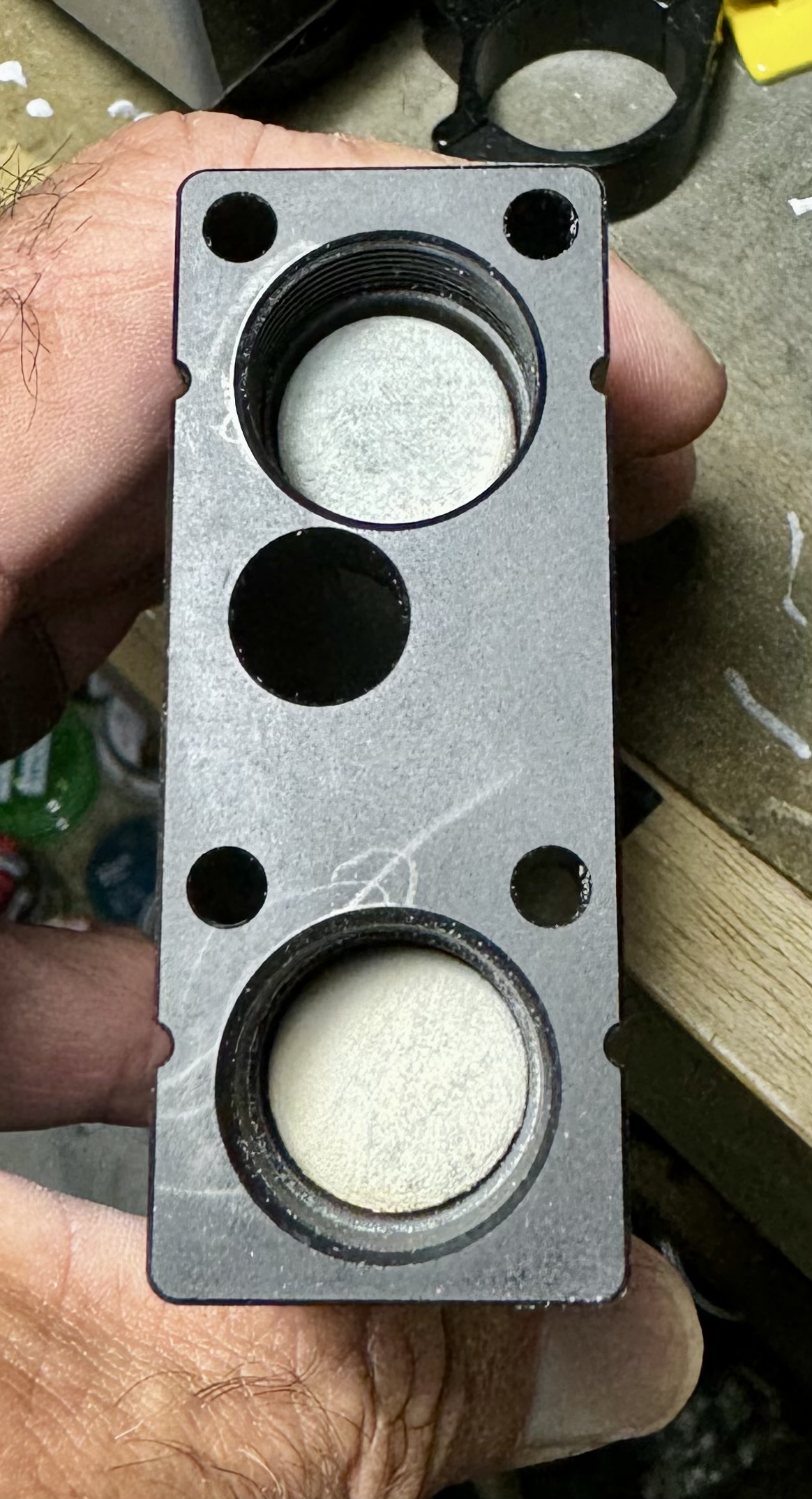

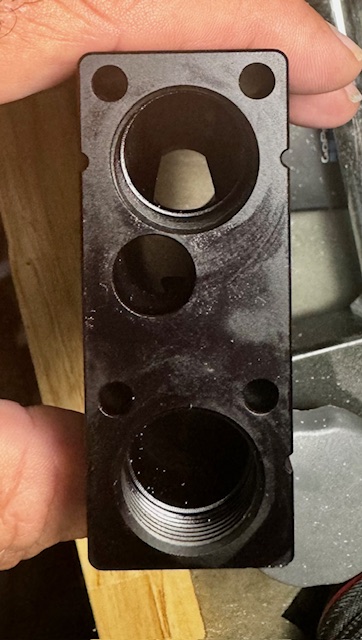

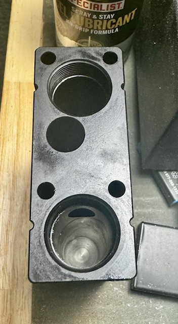

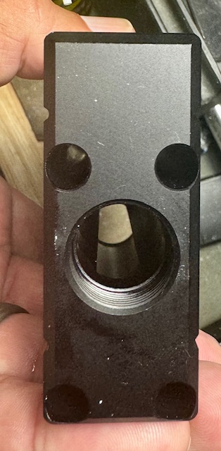

I have a similar idea. The SHP Plenum has 3 plugs similar to the one on the front of the standard plenum. When I move them there are essentially 3 holes connected by either open space of a passage way. The diameter of these holes is just shy of ⅝". I'm thinking of cutting a couple lengths of wooden dowel and just slipping them into the two opening accessible from the top of the plenum. This should reduce the overall volume but still allow air flow around the dowels. I'm on my way to Ace to pick up a 3" length of 5'8" dowel to see how it fits. I may have to sand it down some, but should be much. Then I can add one or both to essentially have a variable volume plenum!
So, a $5 ⅝” dowel from A e Hardware, a little sanding and cutting to the proper length and I have two plugs for the plenum. I need to do some math to figure out he actual volume offset by each dowel and I should be able to figure the plenum volume with each or both dowels installed.

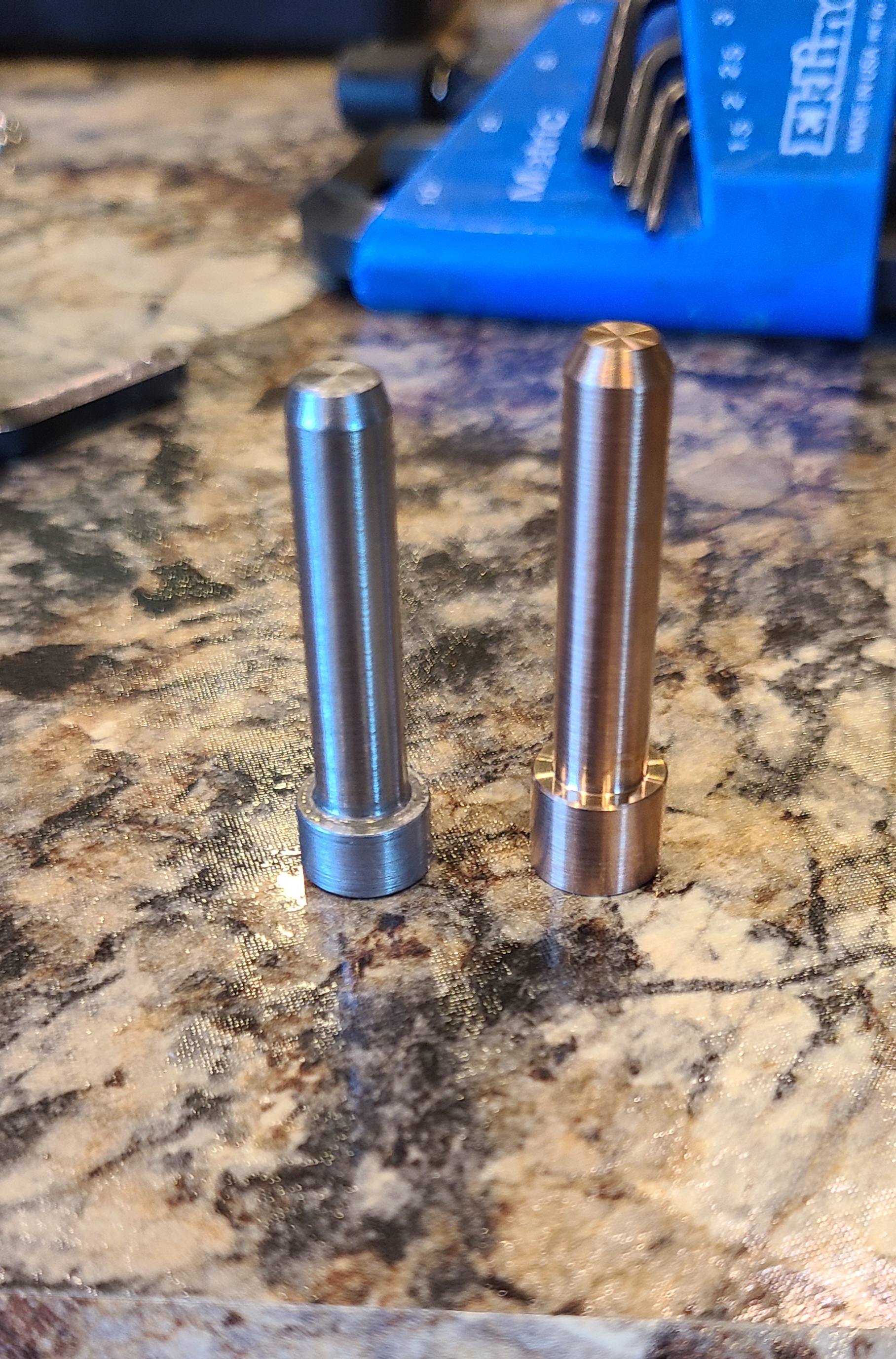

Until then, what about re-machining new threaded plugs (caps), and extend them, makeing them deeper, thus decreasing plenum volume inside?

Adding the 2 dowels reduced the volume by 26.5cc, so it's a tad over half the size it was. I was looking for between 25cc and 35cc and ended up with 36.5cc. I did a 10 shot string to test it out and the first shot was 898fps, the remaining 9 was 900 fps! This is shooting the 21.9 grain AEA pellets. Accuracy is also excellent, so I think I'm going to let it stay where it is for a while and just test some other pellets at this setting. I did swap out the tungsten hammer weight for a 14.5 gram brass hammer weight. The regulator is set to 110BAR and the HST is a full 4 turns in from flush with the back of the breech. The only thing left to do is check shot count, but with the volume of the plenum reduced by almost half, it should increase significantly over what it was before using all 63cc of the plenum.
