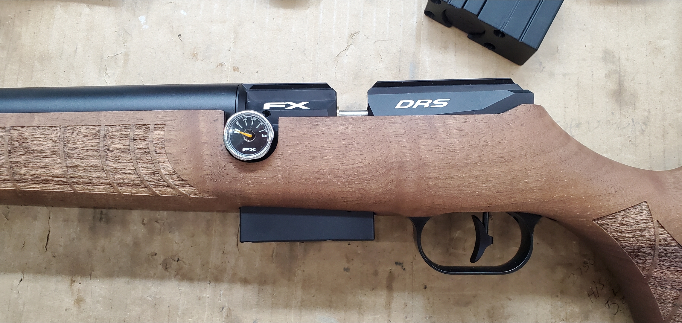

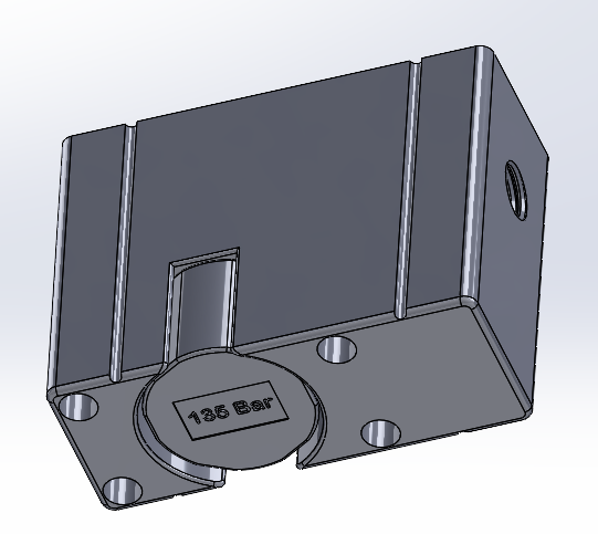

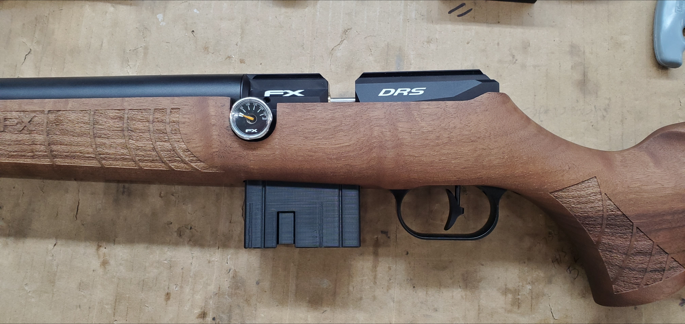

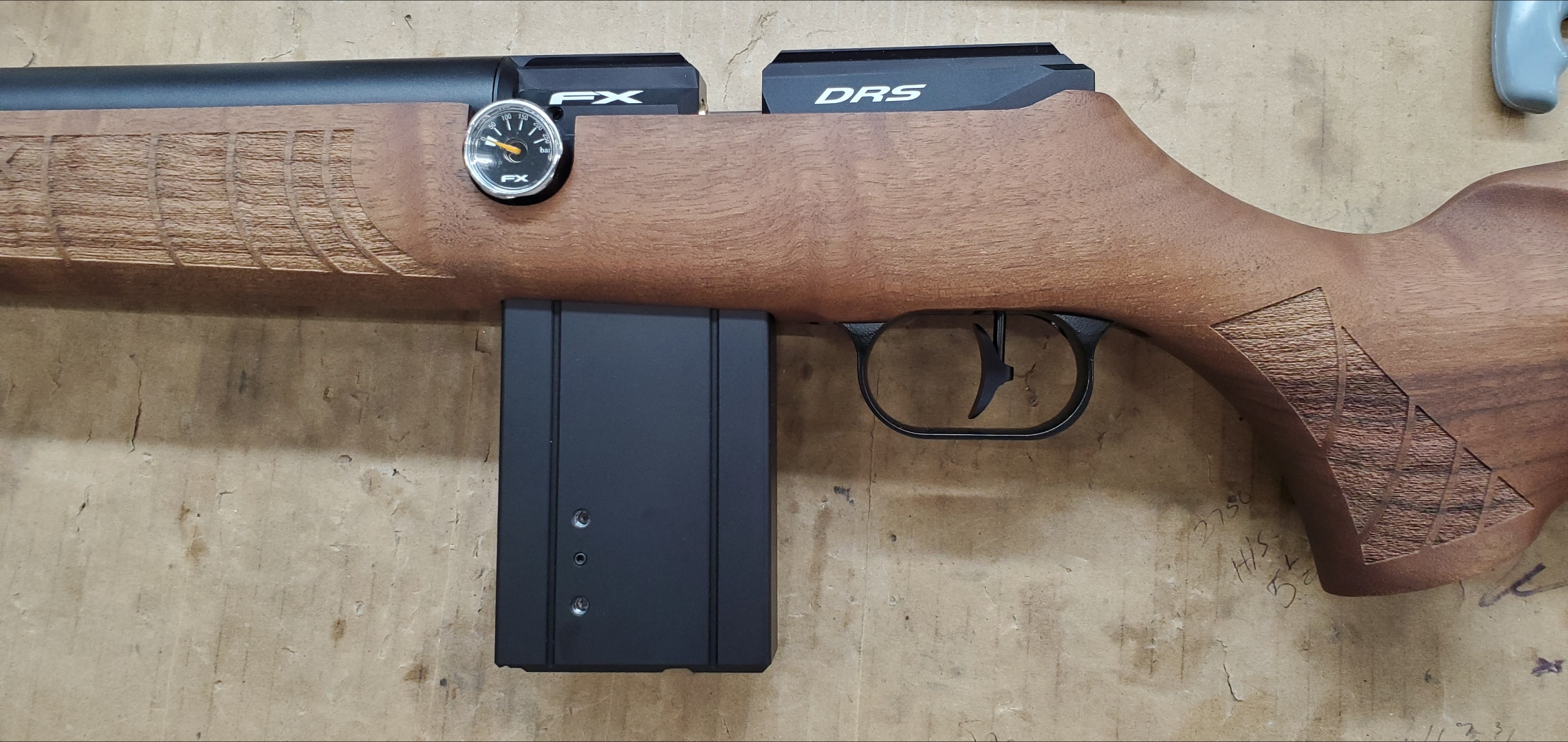

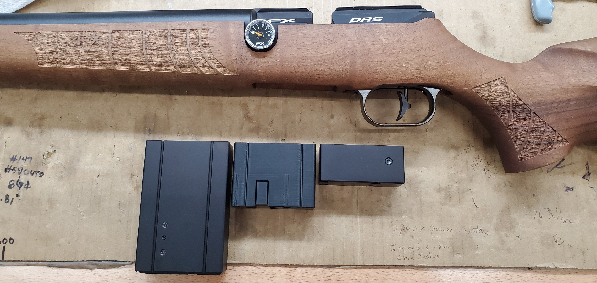

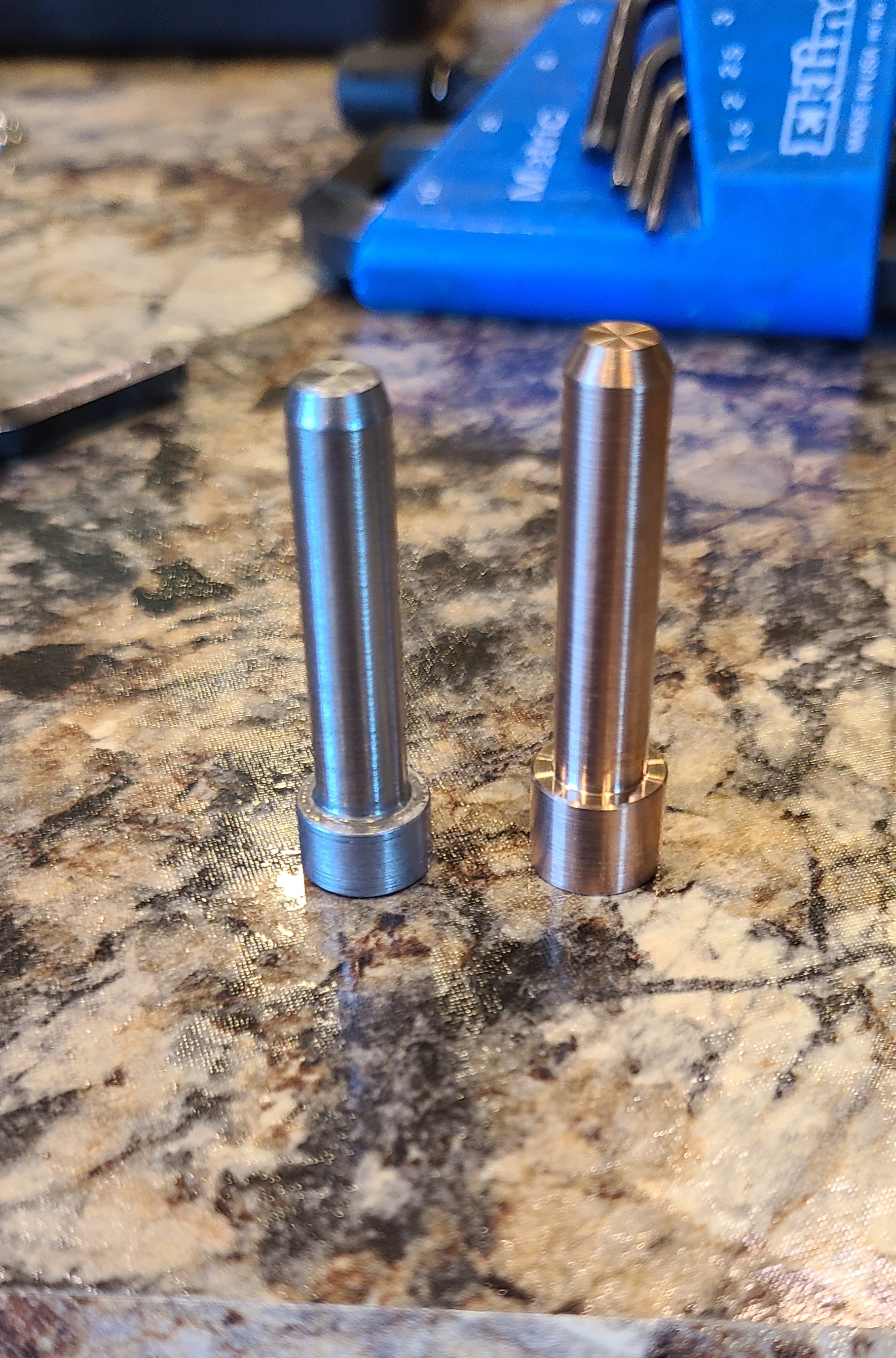

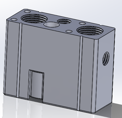

There you go. So we can say a plentum of around 30cc will give approximately 100 more fps on a 110bar plentum setting And a 600mm barrel. I would definitely buy one To shoot heavy pellets. Right now I’m at 140bar and the 28 grn Monster Grands shooting great at 840 fps but I would like to get them up over 900 and still get two mags per fill . I want this for Ground hogs out to 50 yards. I m happy with it now shooting 16 grain Hades at 1030 fps and 16 grn Polymags at 1020Fps. Both shoot less than 1/2” groups at 40 yards. That will be my squirrel load.I did run a shot string with the standard 11cc plenum before I swapped to the SHP plenum. Same pellets, same settings, just changed the plenum to the SHP with the 2 dowels, average FPS was 791. So, it gave it an increase of 109 FPS.
