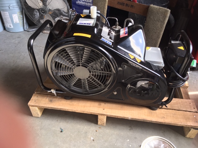

This is what I'm using now. Its an industrial grade unit meant to fill large tanks with breathable grade air and run for 8 hrs a day. Made with quality materials to last = to bauer compressors. This thing makes my Y/H look slow.
Yeah for 3k price tag. It also make the yong Heng more attractive. Not every haves money growing your trees. If I was the get a high end compressor, I'd go with the daystate at 2k price tag and save 1k for something else.

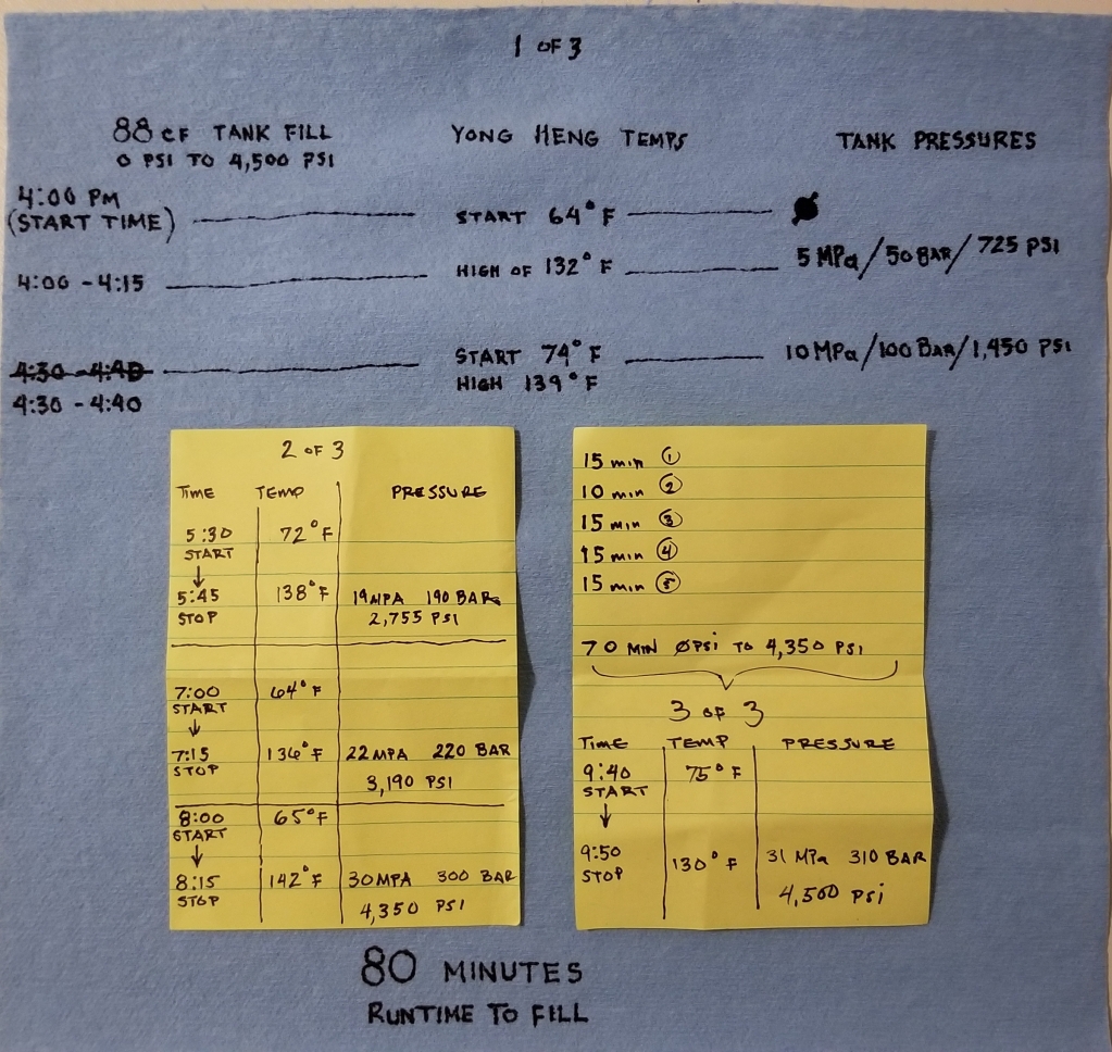

I recently (last month) got my Yong Heng. I am a complete newbie to PCP filling bottles, but it took my new Great White from 0-4500 in about 2.5 hours. It would have been shorter if I hadn't discovered on my own that you need to turn it off every so often to let it cool, even with ice in the water. :)
It tops off my tank from 3000-4500 in about 15 minutes.
