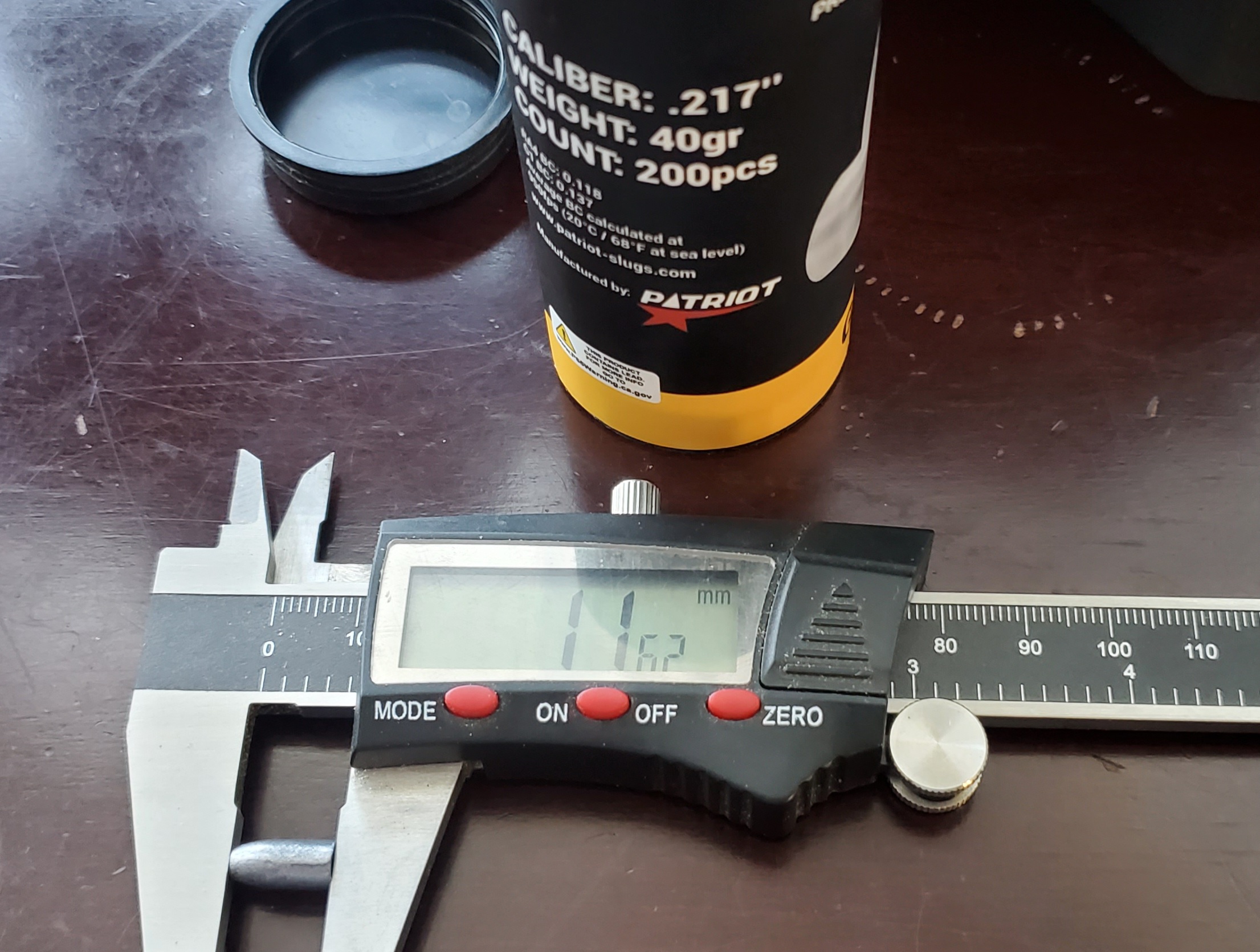

The last time I measured the 40 gr javelins gen 2 were 11.62, they actually dragged on a older version of Elis5713's extra deep mags. His newest version does not drag. Note however this is for the impact not the panthera.

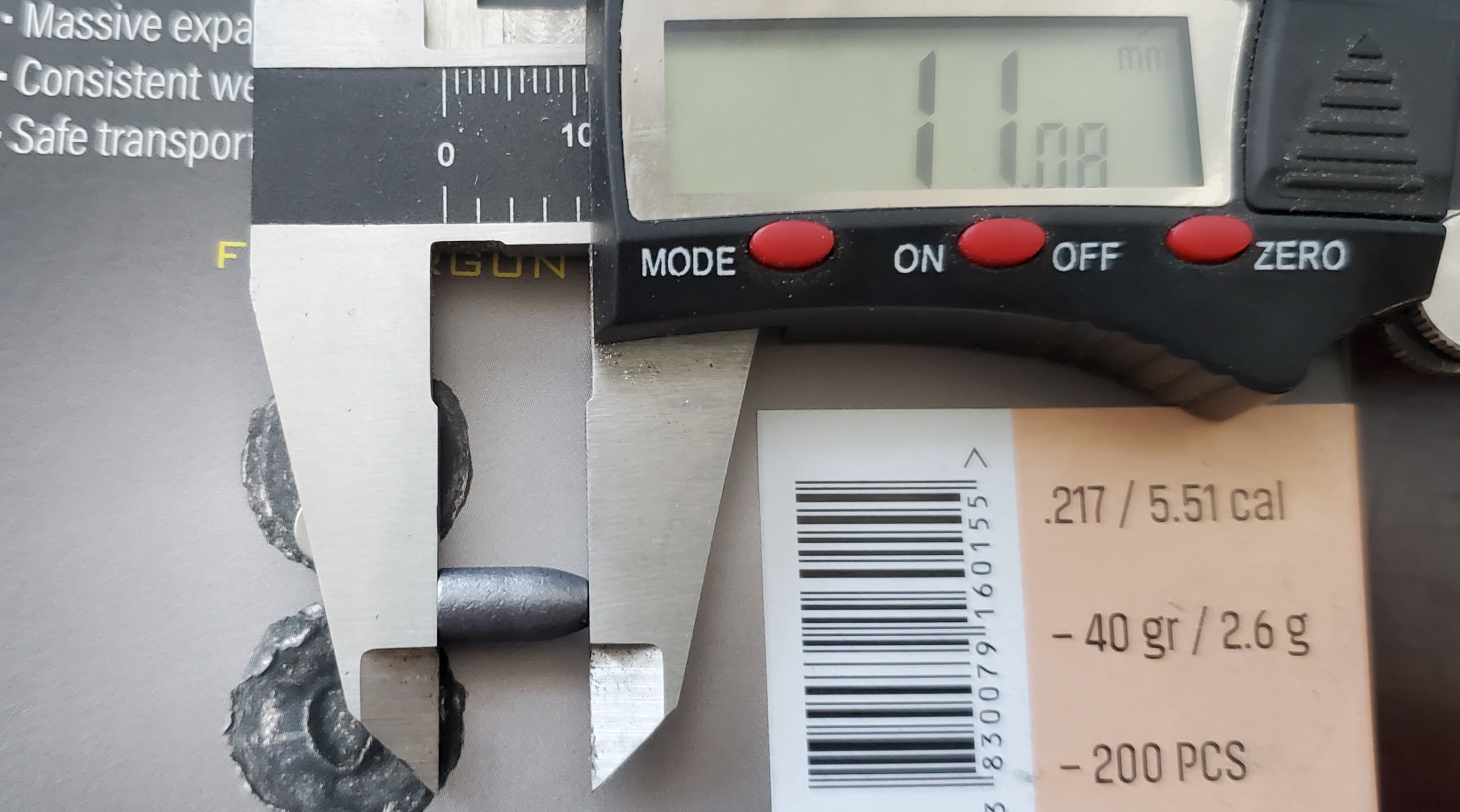

The zans are 11.08
