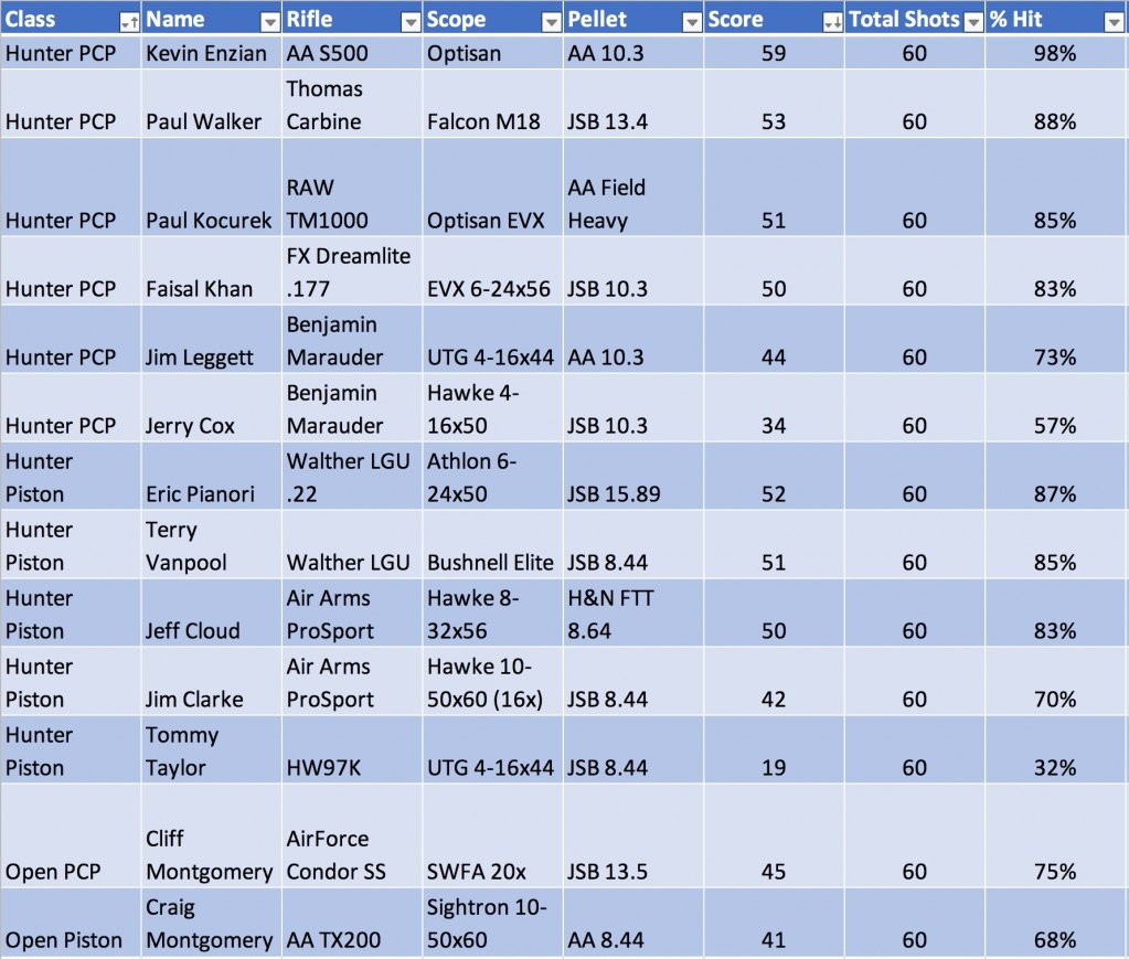

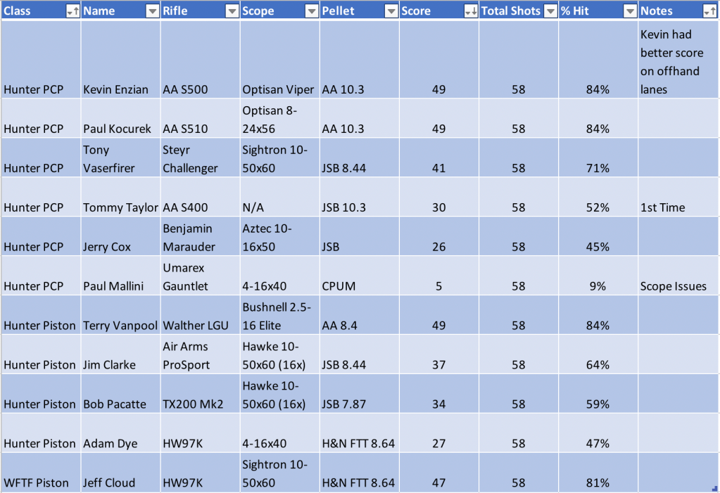

Don't think a springer can't be competitive. Here are a couple of score cards from our matches. Look at the top springer scores compared to the top PCP scores and I am not that good a shooter. The top springer shooters can hang with the PCP's anywhere. I shoot Hunter Class and you do not have to shoot 20 ft lb, My LGU is shooting at 12 ft lbs and does OK.
