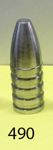

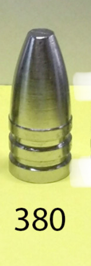

If I were hunting elk with air rifle I would stick to the yardages you talked about and take broadside “double lung” shots only. This slug would be my first choice in a .457 Texan as long is it shot well in my gun.
from Mr. Hollowpoint
or maybe this

I shoot ground squirrels with round balls or 225 grain hp that I got from ebay. Both cheap plinking ammo. I plan to order some bullets in the 320-400 grain range and see how they fly. I am not sure about the 490 grain in my stock 3000 psi texan. All of the tests that I have seen on the heavier 400+ bullets have been in tuned modified rifles. I will only take a clean shot, double lung or head. I have from august 15 to November 30 so I am confident that I can get it done.

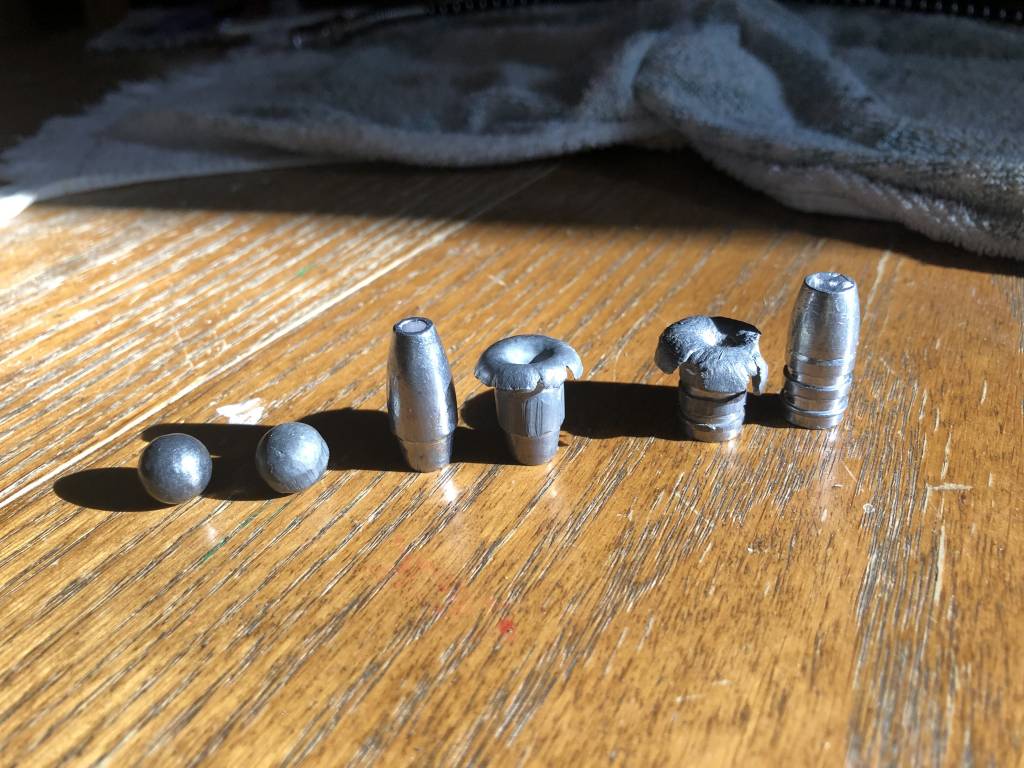

I have been busy lately but I did get to do a little redneck ballistic gel testing today.
390 grain hp on the right
350 grain bthp
round ball on the left
nice mushroom on both hp bullets. No change to the ball
redneck ballistic gel is the mud on the side of my pond. All 3 penetrated about a foot in fairly dry mud.
next step is to see how straight they fly.
