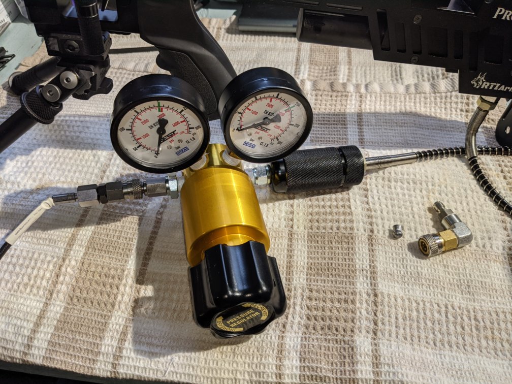

Haha, I do have one sitting on my bench, that is why I'm so motivated to get this working 😉. I'm in the accuracy camp as well and I'm hoping to get it working with the prophet so I can avoid all the awkward hex key tweaks and reg settling between strings, pellets and barrel changes.
The main problem is that the any reg adjustment will end up slowly filling or emptying the bottle and the manual says to never fill the bottle from the external reg port...

I still haven't had a reply from RTI so I'll either have to take the plenum apart to take a look for a failed check valve or attempt to plug the bottle hole with a G1/2-14 bolt.
The mystery has been solved, I got a response from RTI:
We stopped putting in the anti valve not so long ago (part number 56
on the exploded view):
https://www.rtiarms.eu/assets/docs/Prophet%20exploded%20view.PDF
because we detected better consistency of shots when valve is removed.
But in the mean while we looked for solution and we are now putting a
valve on the other side of the pipe (#37) which does not affect the
consistency.
The serial number range for my gun had neither the old or the new valve so there is nothing restricting air flow from the rear port.
They are mailing me the part. Thanks everyone for your tips.
