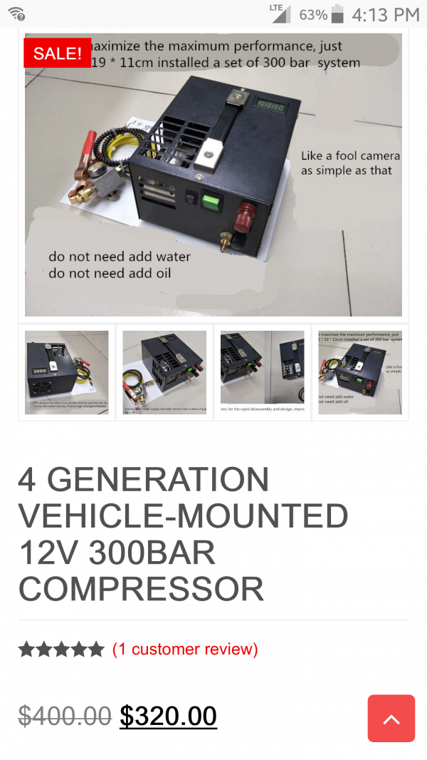

Anybody have personal experience with this compressor?
I find this very interesting since I'm only looking to fill my airguns (Kral Pb .25 and Hatsan Bully .30) Price dropped $30 since last week !! https://www.1ct1c.com/product/no-4-generation-vehicle-mounted-12v-300bar-compressor
I wouldn’t consider any of the $3 to $4 hundred cheep Chinese Compressor you will be lucky if it lasts and since most people that but them don’t also get an acceptable filter for moisture removal you may have guns that will have internal corrosion. Personally if you can’t afford a decent compressor look to get your Air elseware or stay with springers. When I buy a used PCP if the seller didn’t have a good compressor I wouldn’t buy from them at any price.
"Like a fool camera simple as that" Love that phrase, I've had great luck with my Yong Heng and is almost at the point of break even after only 15 fills and many many others have had great experiences with them. I've checked my internals after months of use and no signs of moisture anywhere with a simple filter using molecular sieve to dry. Just because someone chooses to get a YH doesn't mean they can't afford one that costs 5x as much to do the same job. It's a preference.

I should of added to my opinion on the cheap compressors that if you are mechanically inclined you may have a shot at keeping it running. You also have to be lucky to find a seller who will be there for getting replacement parts when needed. But for someone who is a newbie and who may not know what way to turn a screwdriver you need a pump with a good track record. If I had to get a pump and wanted to keep my cost down I would rather get a booster pump like the shoebox or Alteros. I would also like to see all of us who are using a compressor do a annual internal inspection of the high pressure tank on your gun just to see if moisture has got by what ever you are using to fill up with air. To check the internal tank condition you can buy this attachment for your cell phone.

"stony30"I appreciate the responses but does ANYONE have a similar compressor like the link I provided? I really don't care about opinion about "cheapie" compressors. I am asking about "personal" with THESE compressors. Thanks
I’ve never seen the compressor you have asked about. The site that it is on seems questionable I would try to see if you could check them out before you buy to make sure it is not a scam site. I would not make a purchase from a site that has no info on its location or even a phone number the chances for being ripped off are two great. I would recommend if this is what you want to look on alibaba or aliexpress for this item as at least then there is a better chance you will receive it and find a distributor that can supply future support.
"stony30"So nobody on these forums owns this particular compressor or cares to comment on it. Hmmm...
I don’t think this compressor is available I did see on line a few that are very similar airgundepot has one that looks like it’s from the same manufacturer with slight differences but it’s not in stock.
https://www.airgundepot.com/air-venturi-nomad-portable-compressor.html
if this is. What you want I would recommend that you wait for some reviews before you buy. AirForce airguns has their version in the works also
http://www.airforceairguns.com/AirForce-Airguns-Hand-Pump-p/u1099.htm
