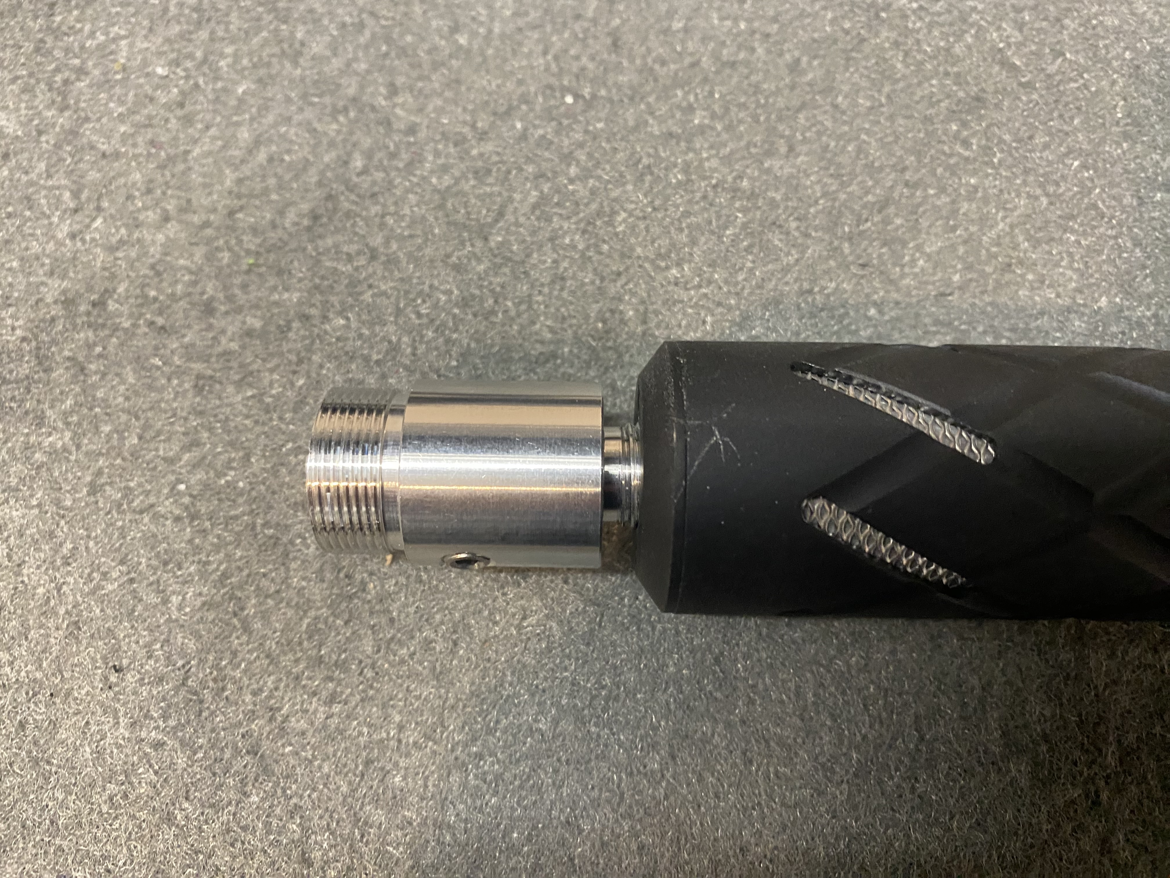

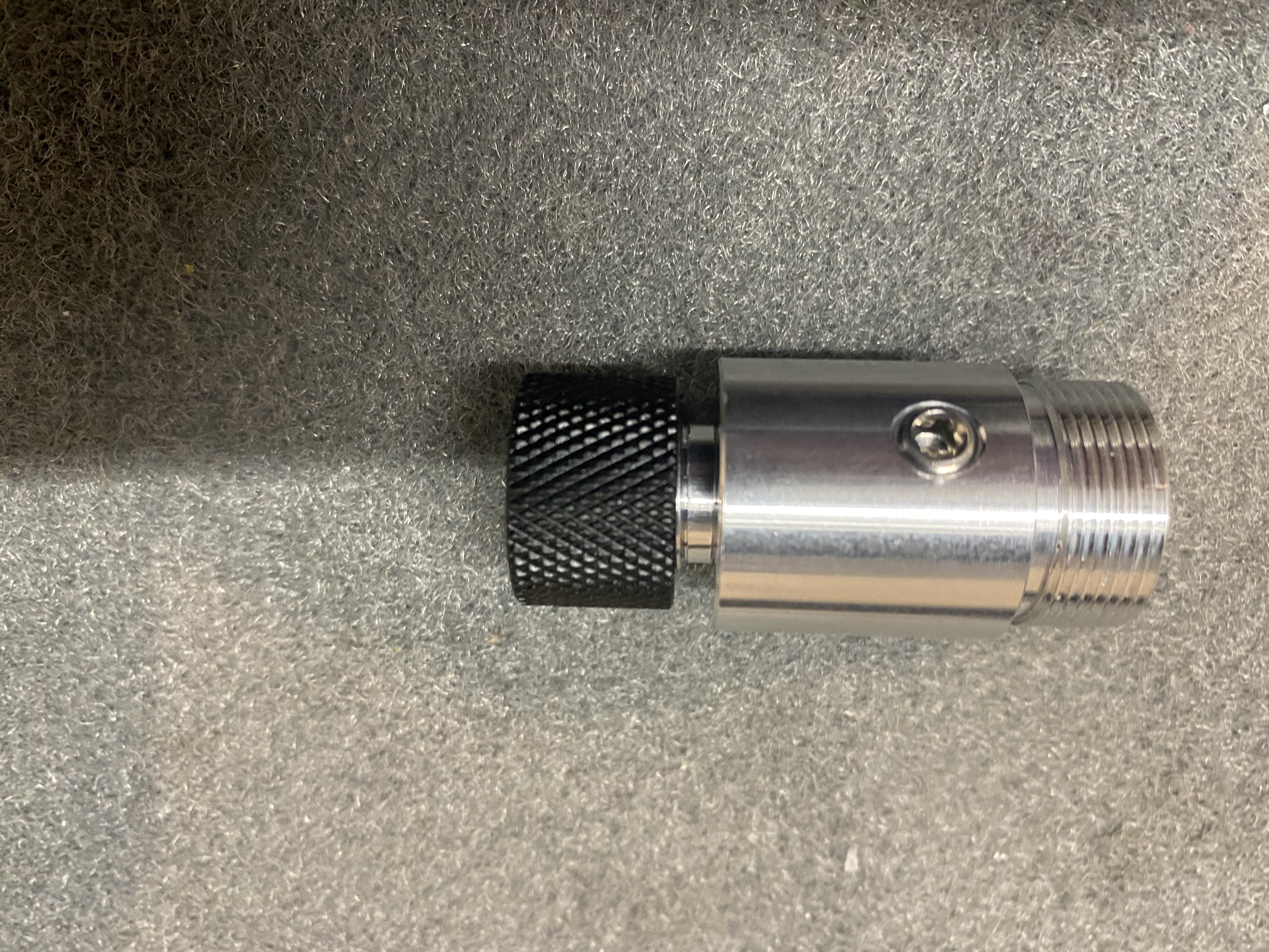

Well I hope everyone else’s kits are a little better than mine. I just got a chance to look over the parts. The 1/2”-20 UNF threads on the moderator adapter looked a little odd so I tried to thread it onto one of my 0dB moderators and it doesn’t thread all the way on. A DonnyFL adapter threads on with no problem. Haven’t attempted to go any further with it so have no idea about the other parts.
I reached out to the seller through eBay. Waiting to see what he has to say

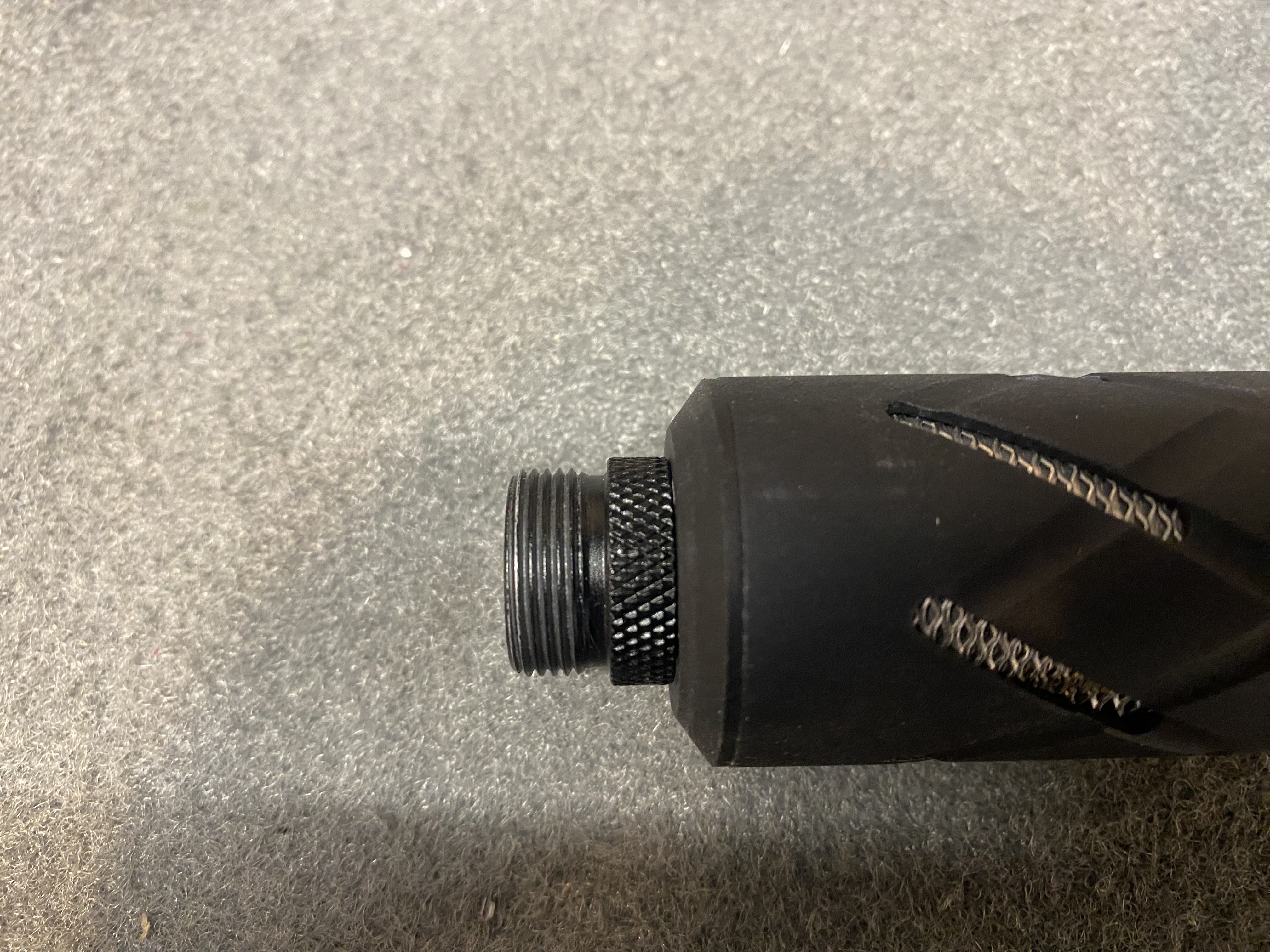

Got mine yesterday and I thought I might have the same issue where the LDC didn't thread on fully but I just kept working it on and off and now it threads on up to maybe 1/8" to go by hand then needs a little more torque to go flush. (Not installed so probably can put on LDC by hand when mounted to the barrel shroud)
My guess for my situation is that Buck Rail uses metal thread inserts in the 3D printed LDC and there was locktight on the inside threads further in and that's why it was real tight. Threading on and off got the excess out of there. It's tight and also I held it up to light and it all looks aligned perfectly so I shouldn't have clipping issues.

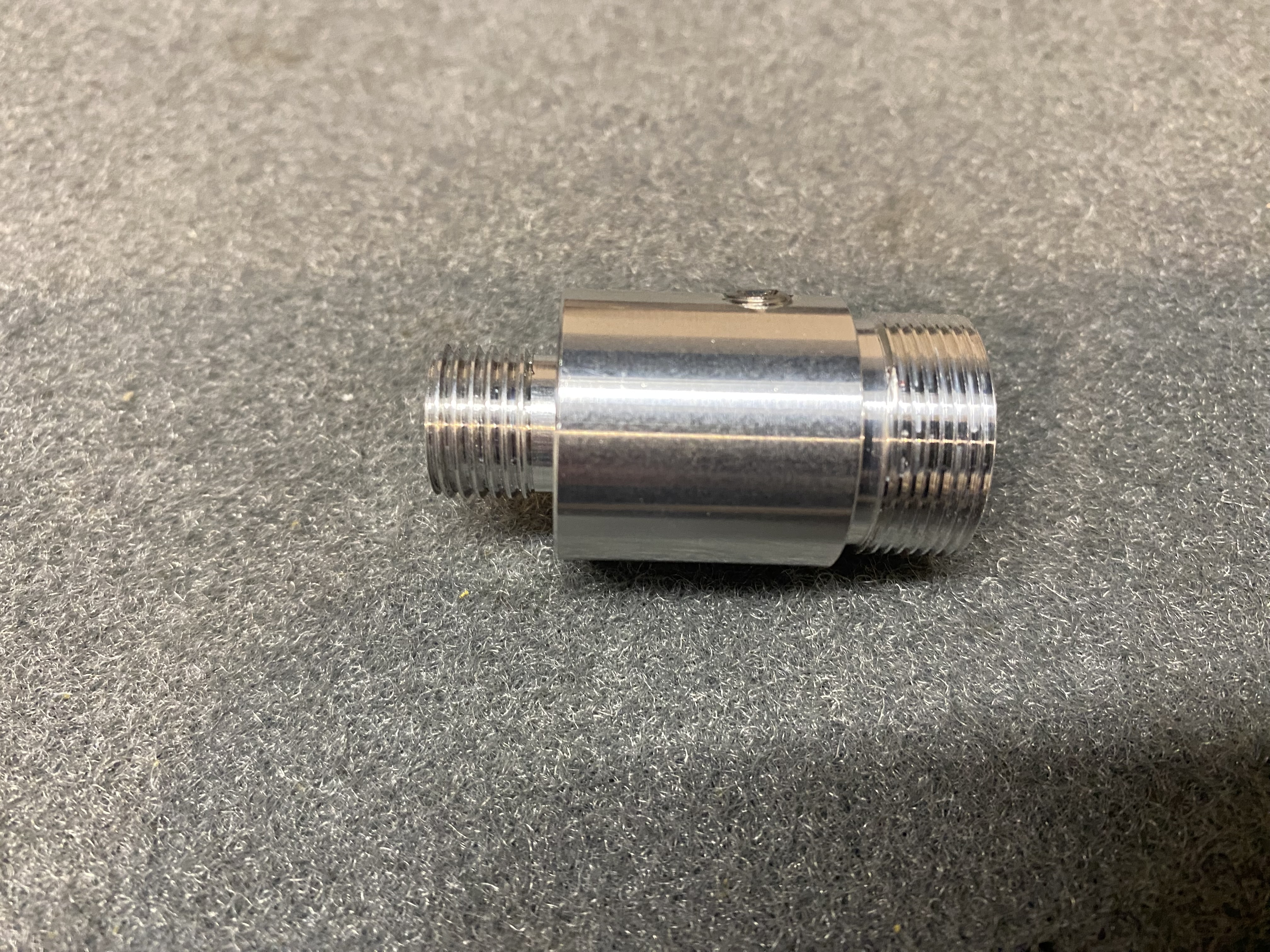

How do they work? Looks like it threads to something then the LDC end? Is the shroud threaded?
The shroud that comes with the Notos has threads. The adapter threads into the shroud and on the Notos barrel there’s a 5mm groove near the muzzle. The tapped hole on the adapter uses a m6 set screw that’ll sit on the groove keeping the shroud in place with the barrel
