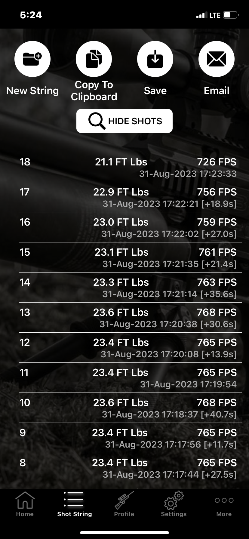

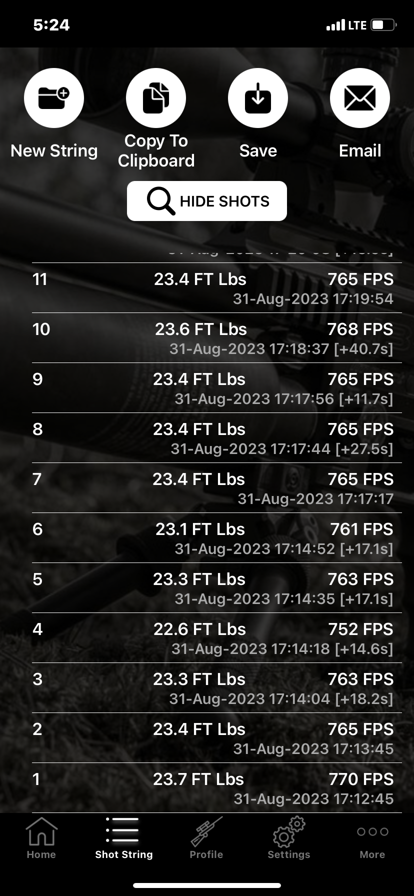

Then I was playing with the hammer spring and weirdly I couldn't get it to shoot faster than ~740 fps or so but thats about how it shot without the plenum. So I added the bushing to get more spring tension. Then I went up to 755.56 fps average and that was with no HS tension (back out all the way)
With those settings:
By ear: 81.52 dB
Muzzle: 86.36 dB

Then with bushing I have zero HS and get 756 or so FPS! Same ~28 shots on the regulator at these settings as with no plenum. Very interesting stuff.
