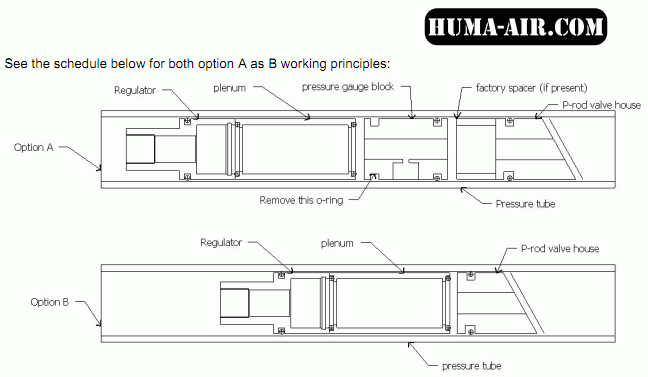

The following diagrams are from Huma's installation manual for the P-rod showing assembly options A and B:

Do you know which configuration was tested by Huma to produce the shot string linked above?
Is that what is meant by the "config 1" and "config 2" labels on the shot string graph?
Both options include a plenum spacer so that shouldn't be a limiting factor in terms of power, although the presence of the gauge block in Option A sacrifices precious reservoir volume of an already small tube so that will affect shot count a bit.
My guess is the missing piece of the puzzle is the porting details. Power in the mid-teens (~15fpe) is about what a P-rod produces in factory trim where it has the benefit of 1.5x - 2x as much pressure and a huge plenum. Making it produce 18fpe with less pressure and a smaller volume of air requires big porting.

How much difference could the removal of the forward o-ring on the gauge block make? I missed that detail, but am willing to do another tear down to find out, have spare o-rings on hand lol -

Yep, it ends up I've been running it wrong by not removing one of the gauge block o rings, SO the plan is to remove the gauge assembly, a stiffer hammer spring, and see what happens.
The gauge presently shows 2000 psi from a 3000 fill, so the reg's output is just slightly over 135 bar, per Huma
