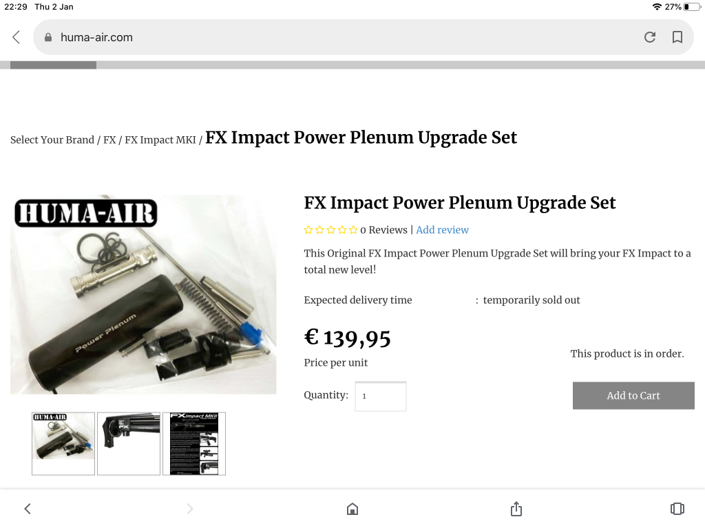

Interesting. Huma does list the same exact kit for both the MKI and MKII Impact. The ad in the MK1 section still shows a graphic that says MKII, so I'm not 100% convinced. I'm sure more details will be available in the future.
One other thing I noted in the Huma listing for the Power Plenum upgrade is:
We do not ship these items to Sweden, Canada or the USA
Their other ads don't say that, and I've purchased regulators from them, so they may not be allowed to ship there to the US for some reason. Hopefully it's just a dealer agreement, and a US dealer will be selling them instead.
