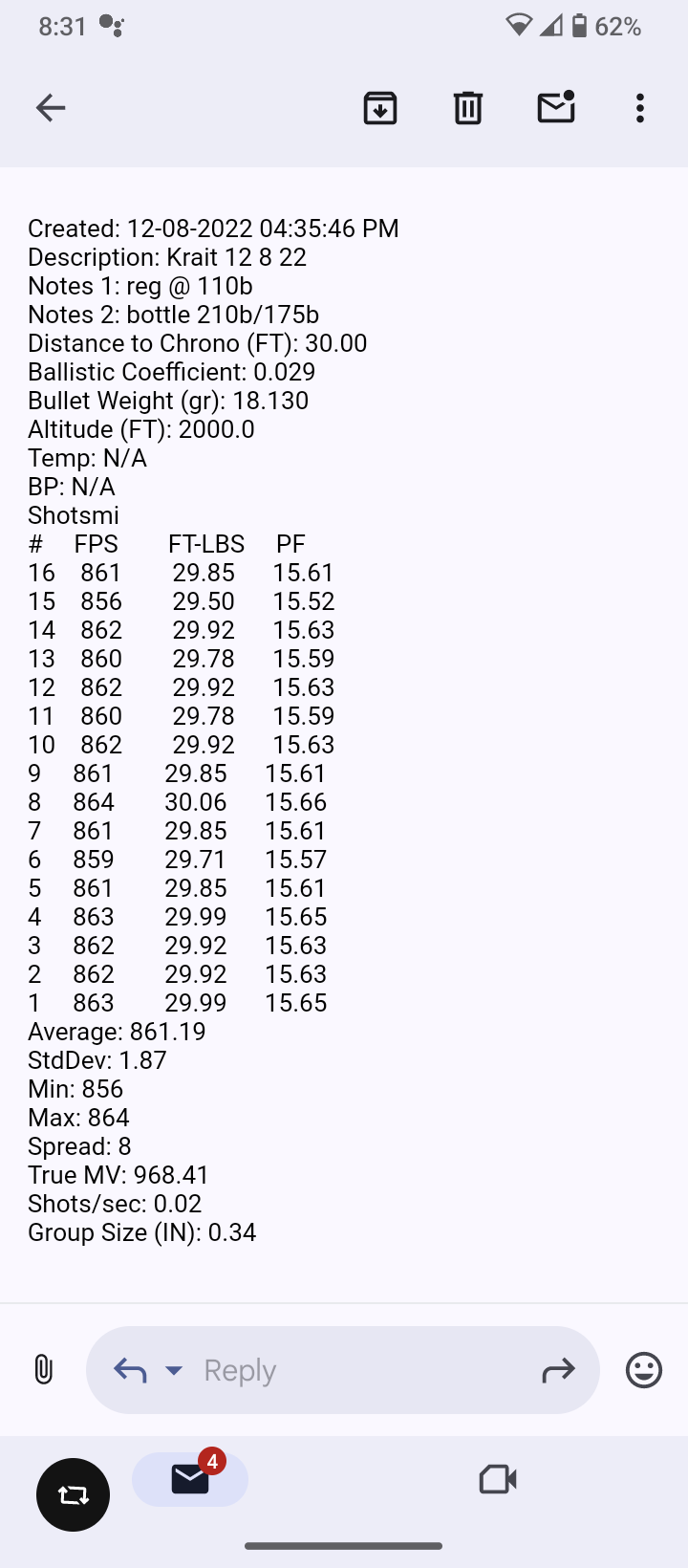

I have the Krait Lite Long and the Vet 2 both in .22. They are both about the same accuracy wise at 50 yards from a quick trip to a private range. The Veteran 2 has a much better finish and smoother trigger and cocking than the Krait (which is also very good in both areas) Krait is lighter by a bunch. I really like how the Vet was finished so it edges the Krait out and that would be the one I kept between the two. The Krait I have is a HP and about 7 fpe more than the Vet (51 - 44) but that's just how they are set up. I get 60 shots in the vet 70 with the Krait at their current tunes even though the Krait have a lot more air on hand. Both are great pcp's.

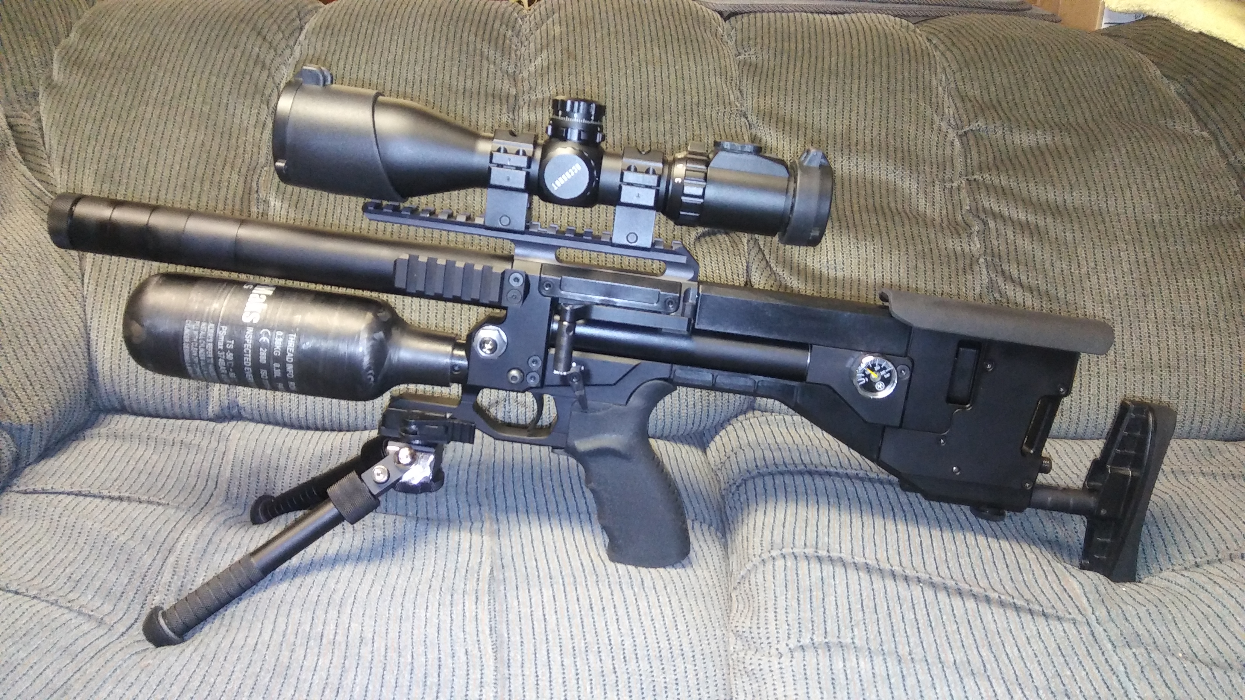

@MACTEN thanks for your pics, and input. That's exactly why I reached out to you Guys; doesn't make a lot of sense buying ANOTHER airgun, if my Vet will trump again.

If you're going to be somewhat around me borrow this thing for a week.

Just pellets and stock tune .22 - 25.39's ( I actually turned them both down, hammer spring only , a bit below the knee as they were both maxed out when I got them)
