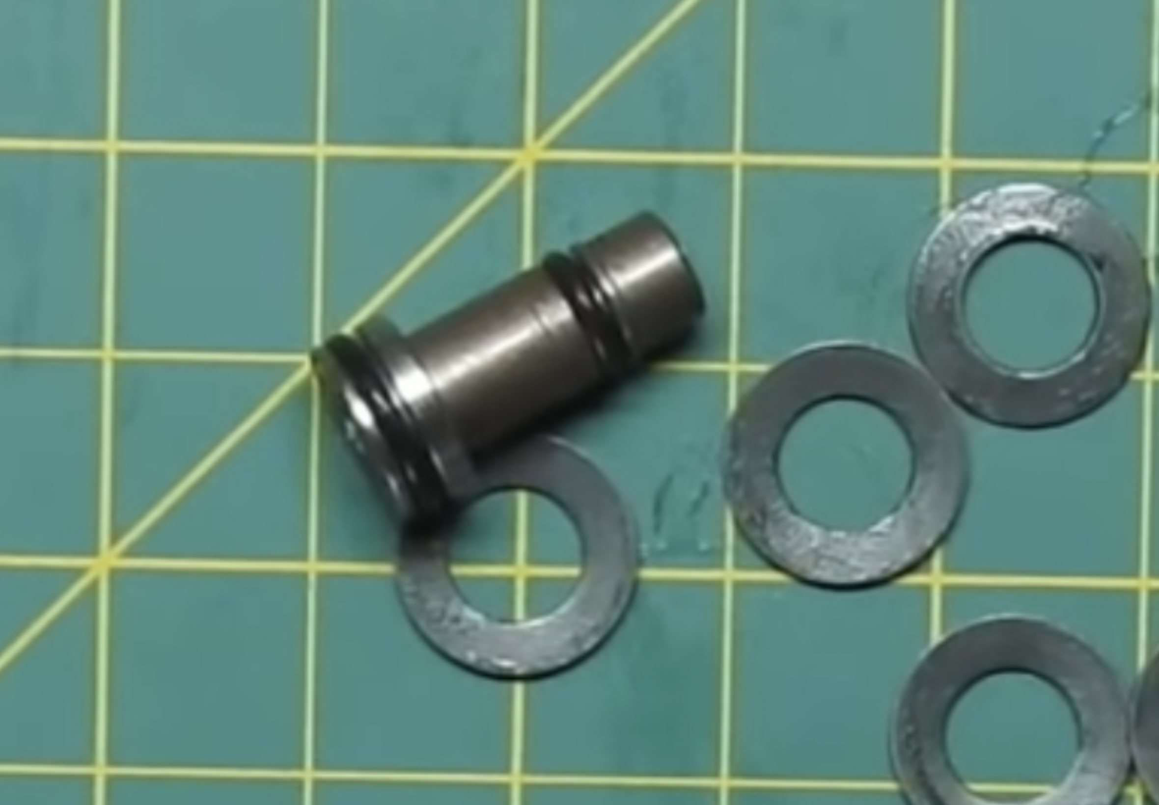

What’s funny is the darn gun will still drill pests shooting unregulated if shooting at normal distances. So yes, it does take a chronograph to snitch out the reg is in there taking a nap. The piston has a 8x1.5 on the big end and a 5x1.5 on the small end where the seat is. I didn’t have a 90 for the 8mm but I did have a 90 for the small end of the spool. Guns back together and it’s its little hot rod self again. I’m headed in no to inspect the orings I pulled off the spool under a magnifying glass. I’m 54 and the peepers aren’t what they used to be.

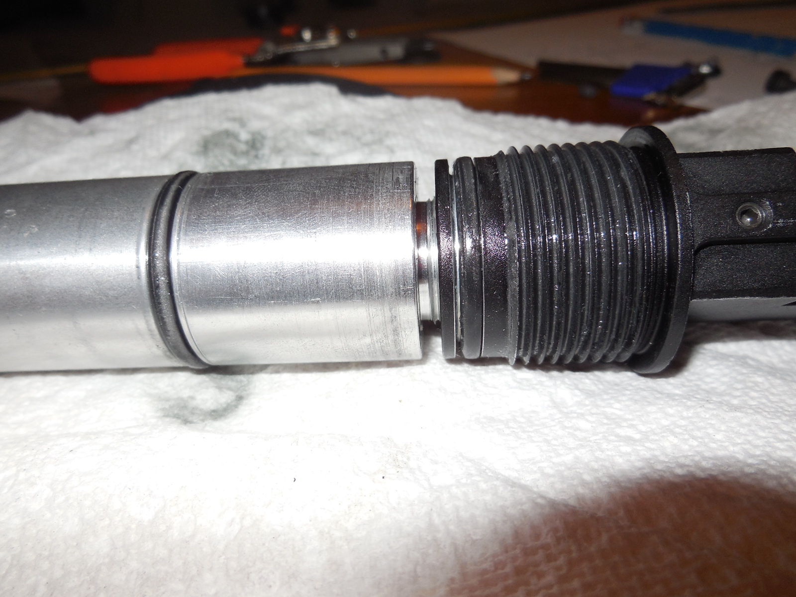

Mines always been messed up but didn’t realize it till watching videos changing in a huma reg. Pic is of reg stack theres not supposed to be a gap the aluminum shell and the black plug. They are supposed to screw together. when I tried unscrewing it wouldn’t budge. Locked it up in my 7x10 lathe and busted it loose. What a mess

I didn’t take any pics of my spool when I had mine apart so I dug up this pic. Like Motorhead mentioned, stretching that 90 over the small end was taxing the oring. The only thing I didn’t like was the oring groove on the big end was cut way too wide. In the hydraulic world, there is plenty of room for a backup oring. I didn’t have a 90 for the big end of the spool. I almost looked for another oring that would fill the groove better. All I know is replacing these two fixes my gun for a while. I screwed up and should have checked the adjuster for an oring and replaced it. Weather is crap, maybe I will do that now.
