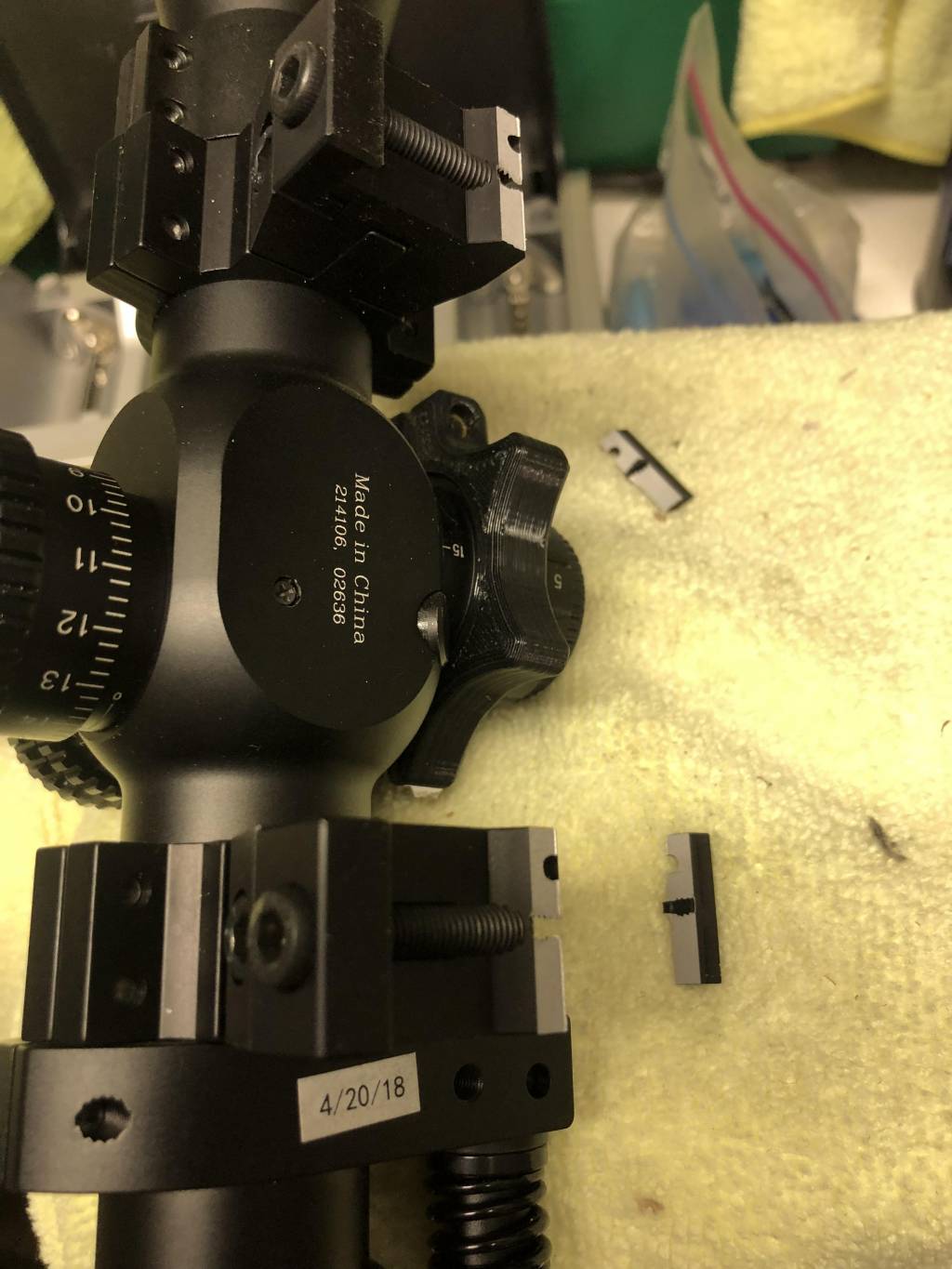

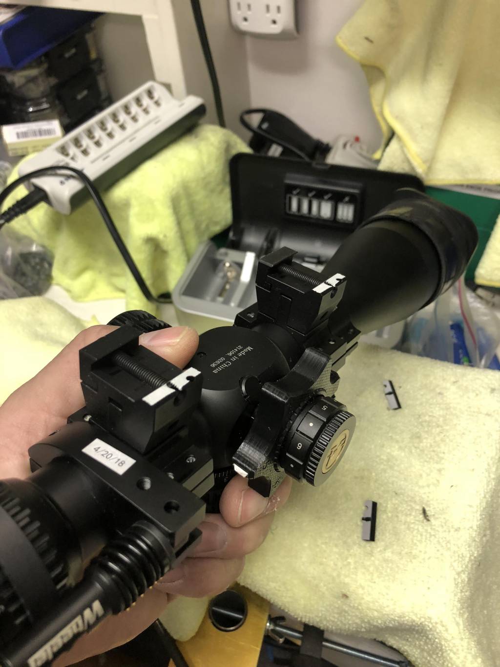

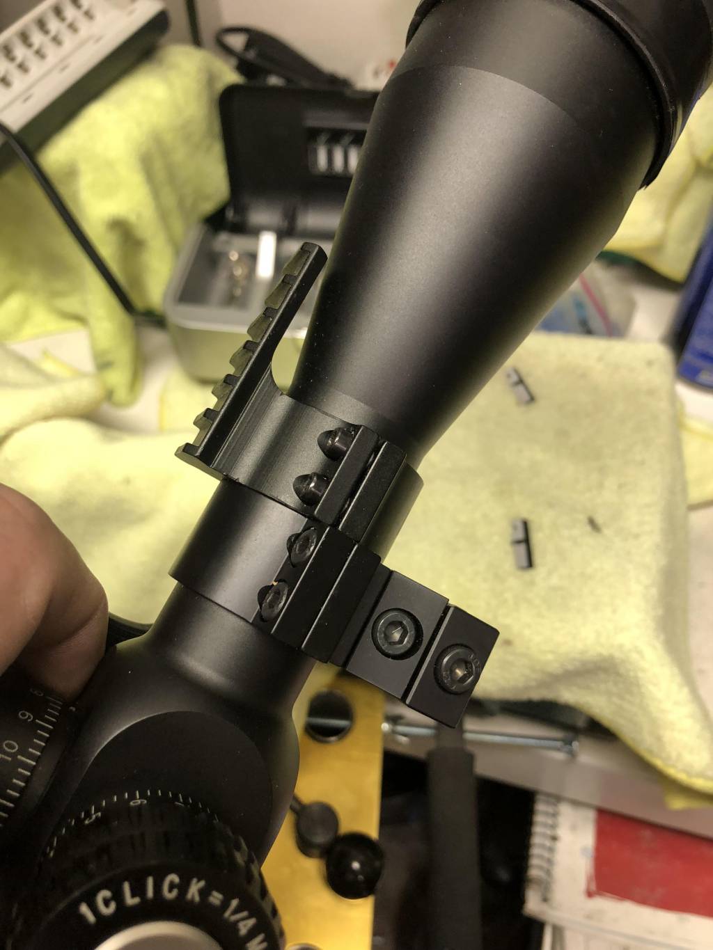

More specifically. The 30 mm to picatinny.
There is a design flaw in them. There is a tiny hole drilled on the side for that set screw. They mill a flat so they can drill that hole.
That flat is a week spot in the clamp.
the 30mm to 11mm dove tail rings. Do not have the machined flat. I have not broken any of those. So I think the issue is with the 30mm to picatinny. Now to every one who is going to say. “ You over tightened them” Ya ok whatever. 1 . I’ve never broke or even stripped out a scope ring in my last 15 years of working on firearms. 2. For the price of these rings. They should not break.

Just going to state an obvious ..... Design flaw perhaps aggravated by EXCESSIVE Over Tightening of the ring base to the rail perhaps ?
Mine could not be tightened hard enough in the angle adjustment to secure a scope without ""gradually"" slipping down over time. I had to put a piece of sandpaper between those surfaces that press against each other in the rings to fix the issue. It literally took months and lots of wasted time and ammo to finally figure the problem out![]()
