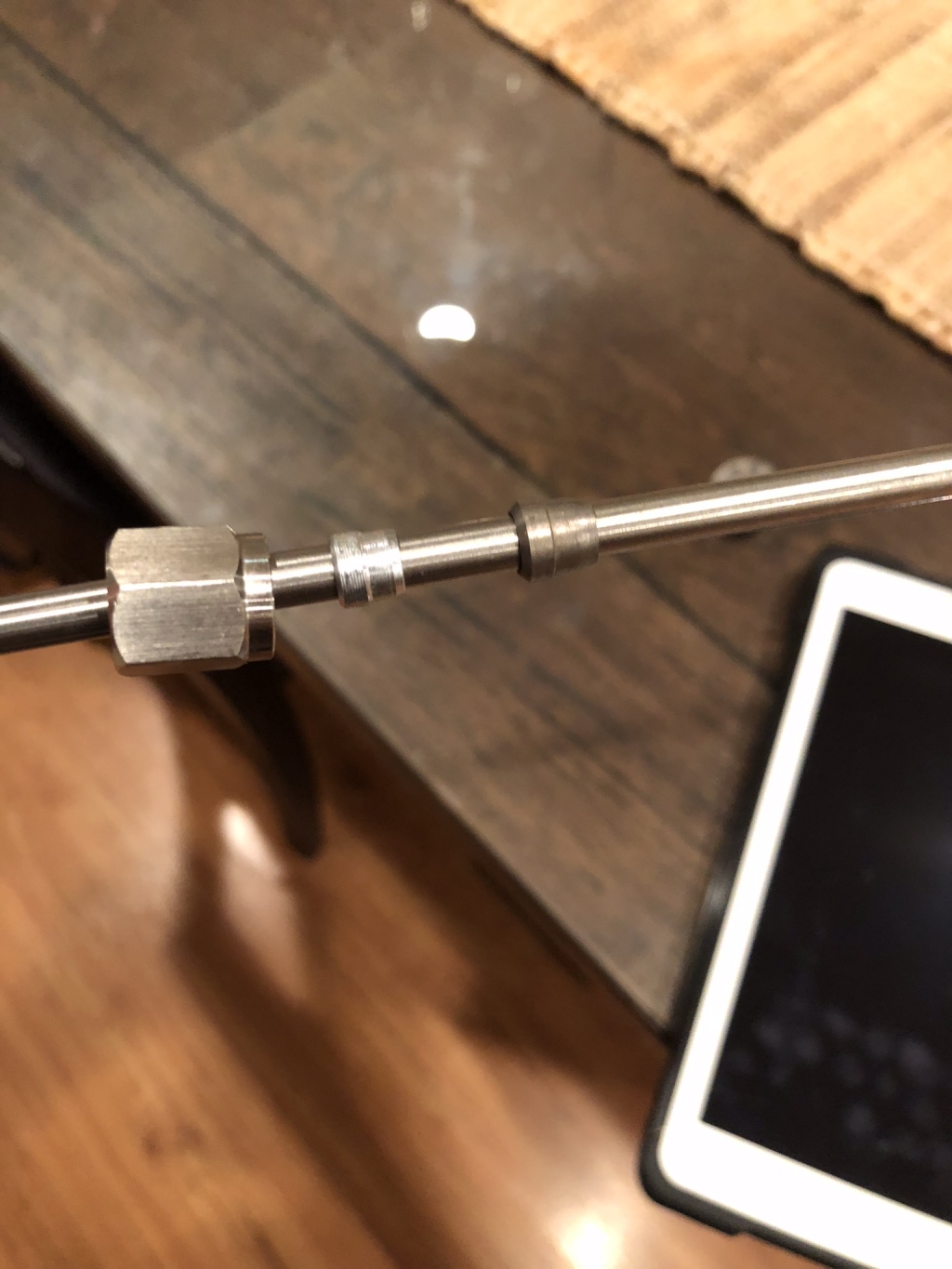

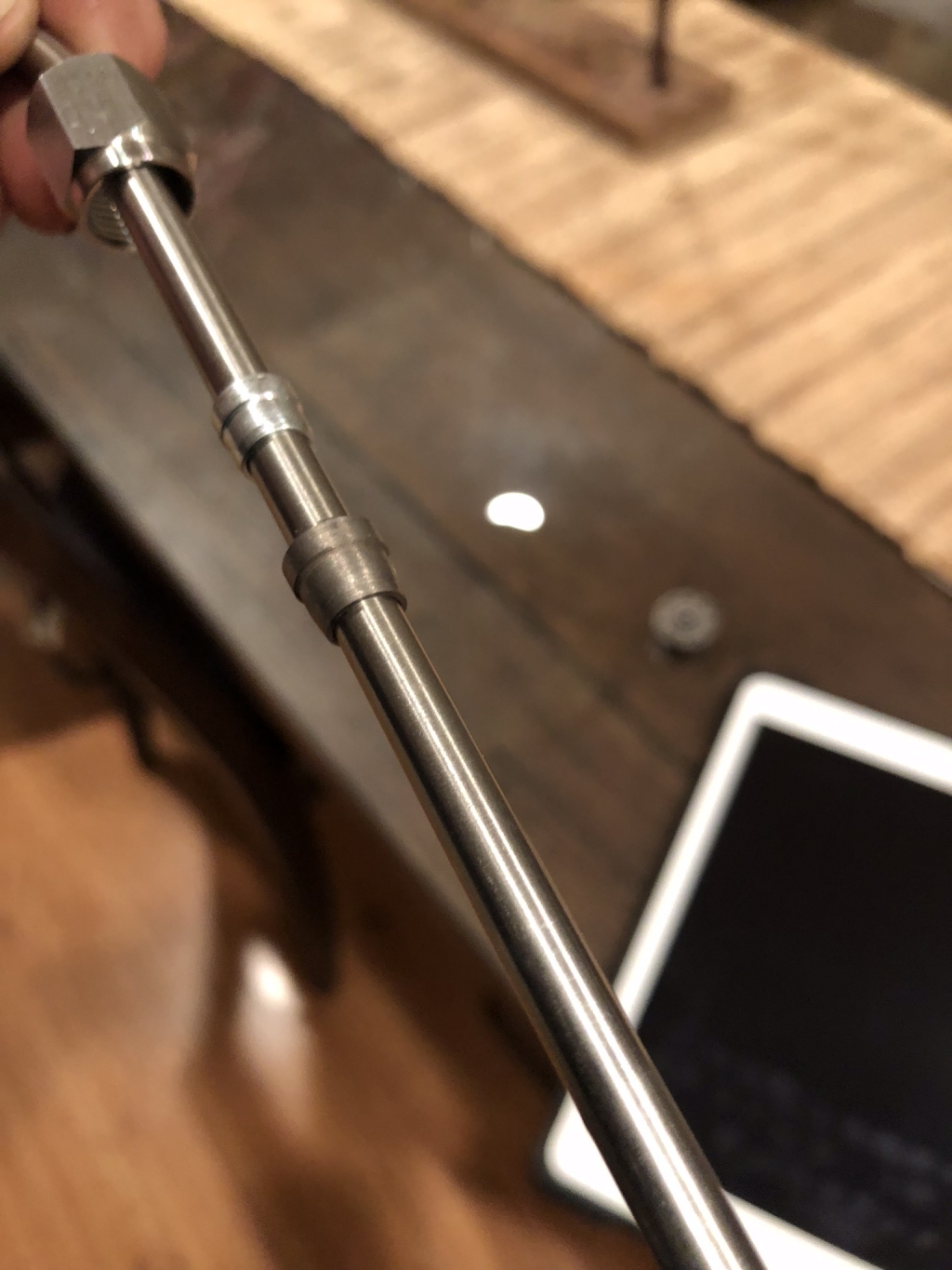

was curious if anyone ever ordered the compression ferrules that are typical on all the AV, Tuxing, Yong Heng hard air line connections. I need a couple of these, and man I’m so close to getting my Lightning back up and running. All I need are these compression ferrules.
Tried calling PA, but as soon as I heard the recorded statement that all of the techs are busy, I decided to not go that route. It would be easier to just try and find them myself, I hope, lol
1582342919_10262386285e50a307a7cd41.66073192_321C5CBC-7D82-44CC-B622-267F1B9DA468.jpeg
Tried my local automotive supply houses, local brake line shops, and no one has seen these. If they have them, like my local NAPA, they are brass and of course for standard brake line dimensions when these are metric.
Anyway, if any of you have ordered these somewhere, a link would be great, and you outright know the size, that would be helpful, too.
Thanks in advance

Im gonna try JEGS or SUMMIT. I’ve used these fittings before, they have a outer rim on one end that when you slip it onto the tube it faces upwards. When the female end of the fitting threads onto the male end the female fitting pushes onto that rim and forces it into the male fitting, crushes the ferrule and creates the seal onto the tube.

If you decide to go with the AV air tube I have a few extra (don't ask how or why). I will sell you one at a discount. PM me if interested. I have a Tuxing twin cylinder compressor and the AV air tube fit fine. I just had to bend the tubing to line up the fitting connections. Remember don't overtighten those fitting, 1/4 to 1/2 turn past snug. The ferrules from belmetric will work fine just order the size for your tube.

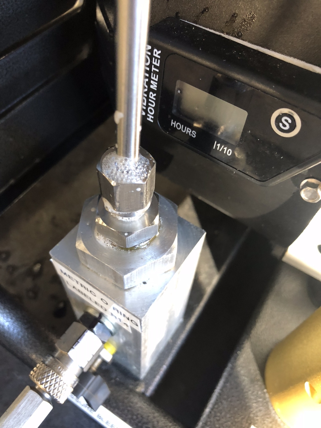

here was the leak point that prompted a new tube replacement-

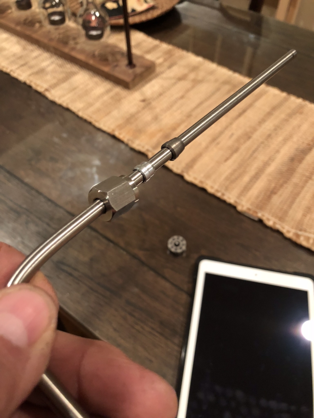

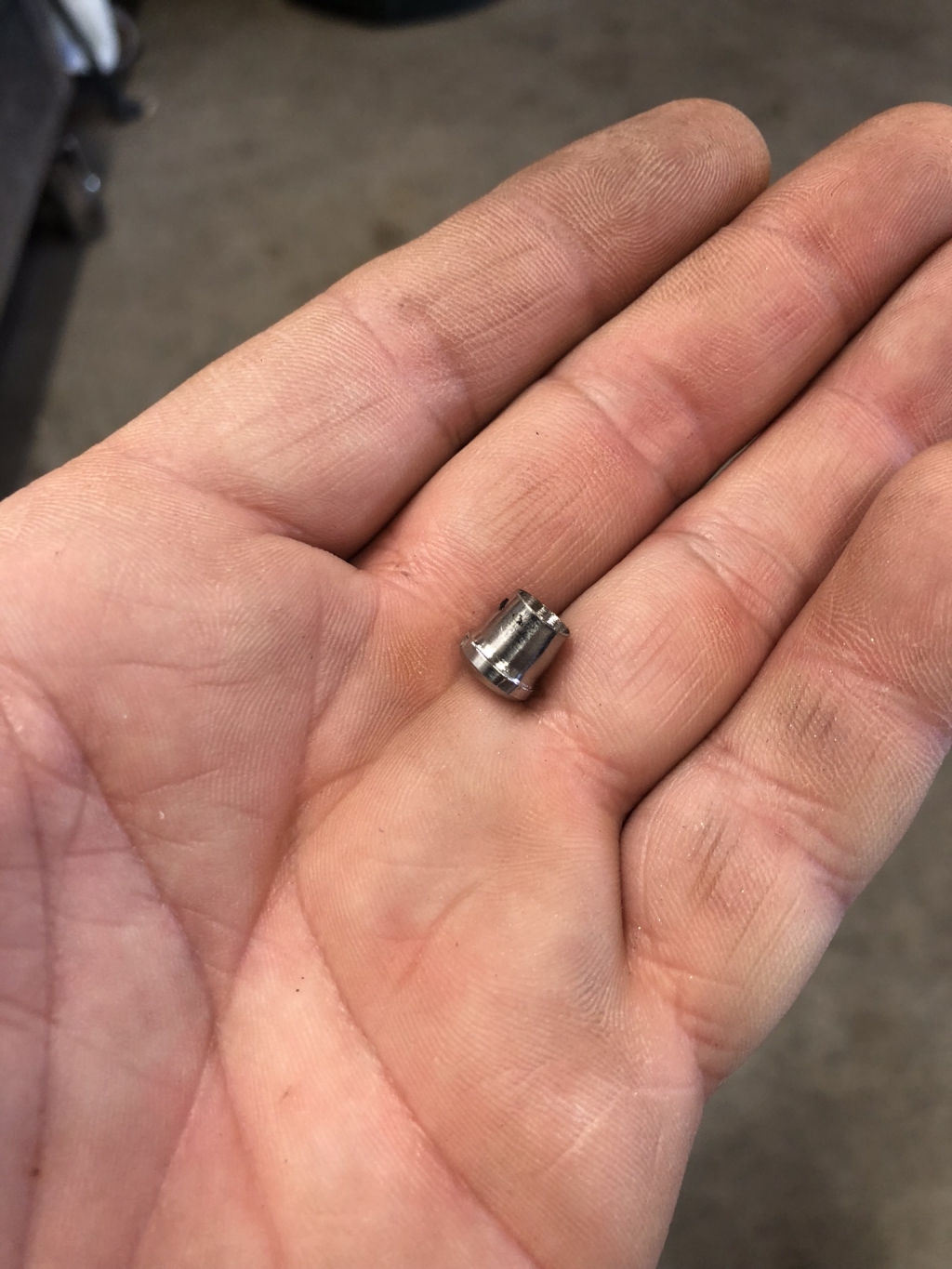

1582603639_13896002085e549d775c4ef2.75642724_7D30A8E2-FB74-4683-AD48-69D46791E54A.jpeg
Guy at Hose and Fittings didn’t have the proper ferrule for these high pressure lines, and as I was leaving he called me and gave me three of these type ferrules, and he strongly feels it may work. I told him the application, and he said it should be ok. On my pics, the one to the right is what comes when you buy the complete fitting, and the silver one to the left is what he handed me to try. I’ll keep all posted on this tread if it works.
If not, Raden1942 was kind enough to instruct me to Allie Express where I could just purchase the fittings as a complete connection, with the proper ferrule in place.
