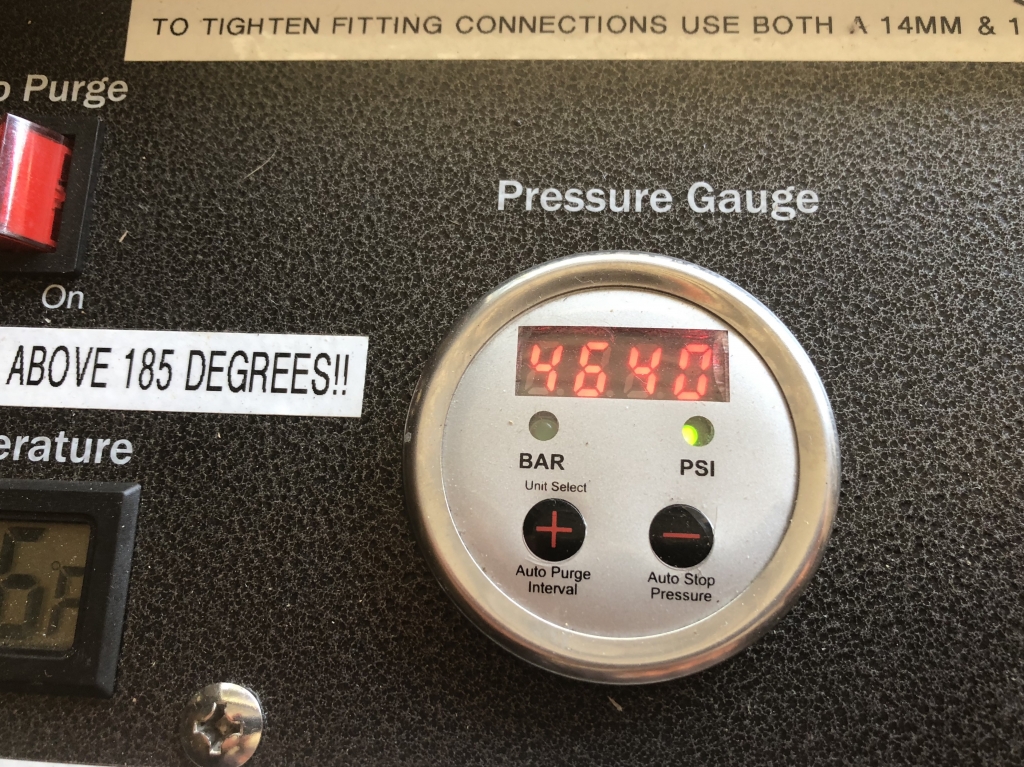

Woooo Hooooo!!! Mr Grimm thank you for the link to Belmetric.com!! My lightning compressor is all 100% sealed and back in the saddle!! It took one minute total to go from zero to 4640 psi.

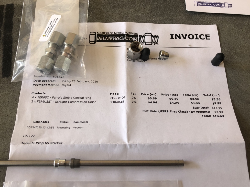

I know a few of you wanted to know what type of ferrules are used on these high presdure 6mm air lines, so here’s a pic of the invoice showing part number 9101-0406 @ .89 a piece.
on the pic of the hard line the Belmetric ferrule is the shiny one to the left, and one from Tuxing to the right.

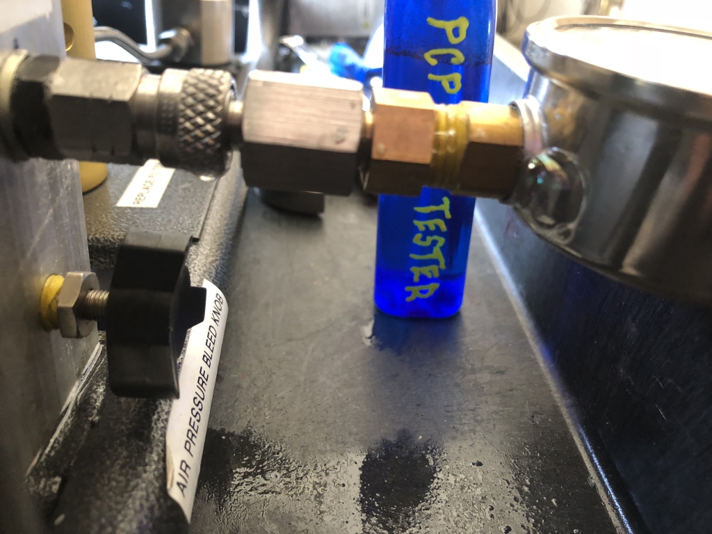

also are pics of the compressor. The only leak I had was my test pressure gage that I had attached to the fill block. Compressor held the 4640 psi pressure.
